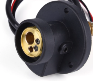

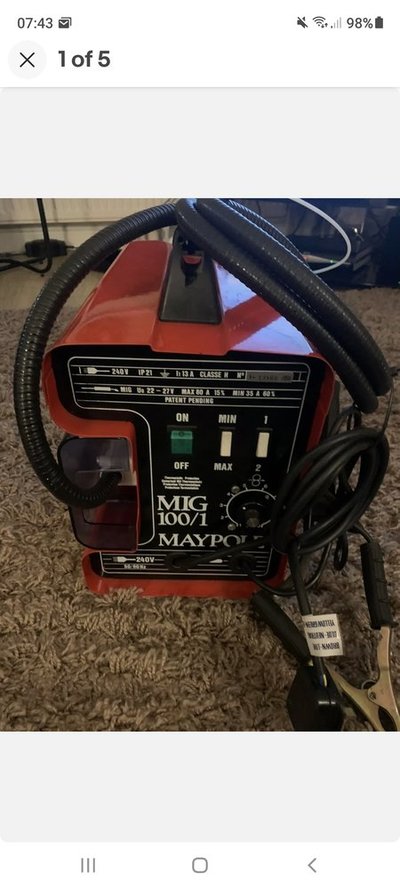

Not really sure I understand what you're trying to do.
What make and model of welder and why do you need to change the torch / lead?
The trigger, of course, has two wires going to it: low-voltage feed -- [switch] -- return.
I can't see how your torch (gun) would not have two wires as it can't use the common return ("earth lead") as that's not inside the torch cable set.
Make is a maypole monomig 100Not really sure I understand what you're trying to do.
Yes, correct.Thanks for the help , so I've just been told by someone (not on here) to put 1 trigger wire to the connection on the original welder and the other trigger wire goes to the main power wire would this be correct
A re-branded Sealey Mightymig 100 ?Make is a maypole monomig 100
