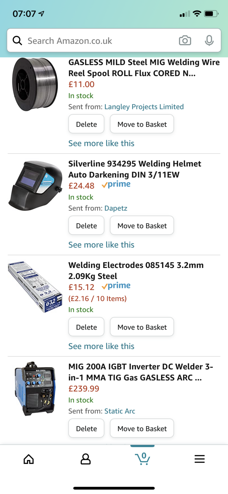

Just wondering what you all think of this set up for beginner setup. Is it worth it or any other recommendations.
wanting to do some basic Fabs gate repair, bench making tables and so on In steel.
im totally new studying mig level one and prospects are looking slim for employment. I’m hoping to get some work made and hopefully show it off to work my way In the door.
any help or guidance appreciated.
