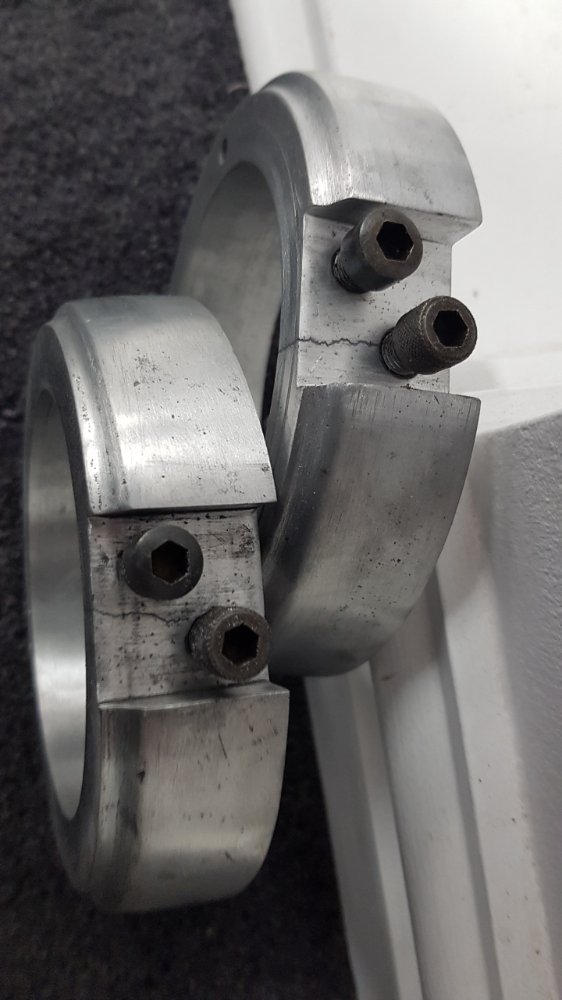

Given the detailed comment, I thought I'd reply if only to add balance.
One assumes AC balance for the cleaning action.
If you have read anything I wrote as being against welding, you have misinterpreted. Maybe I should have said "if you want to remake it, do so with the two pieces as one and separate afterwards".
All I am saying above is do not wade into splashing molten metal at it until you have considered what needs to be done after it has cooled.
I was wondering if it did distort, would leaving it for half an hour in the oven at gas mark 10 and then pushing onto the column civilise it?
