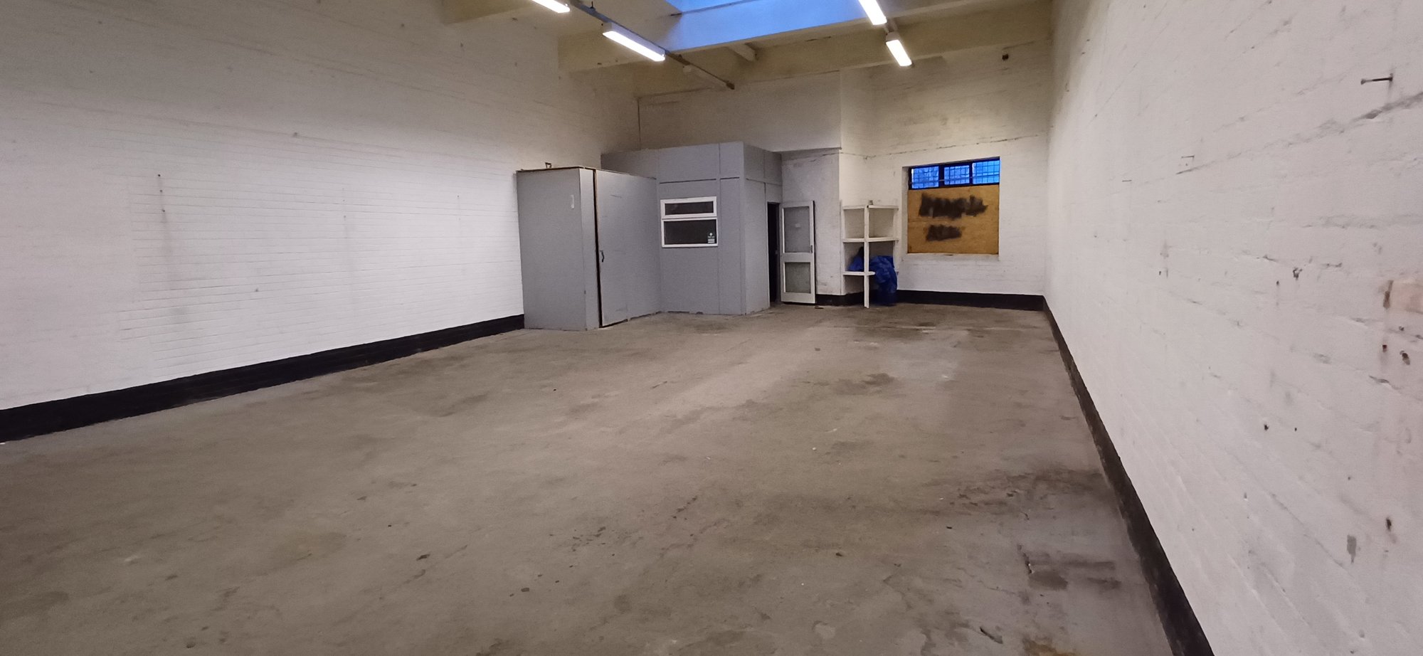

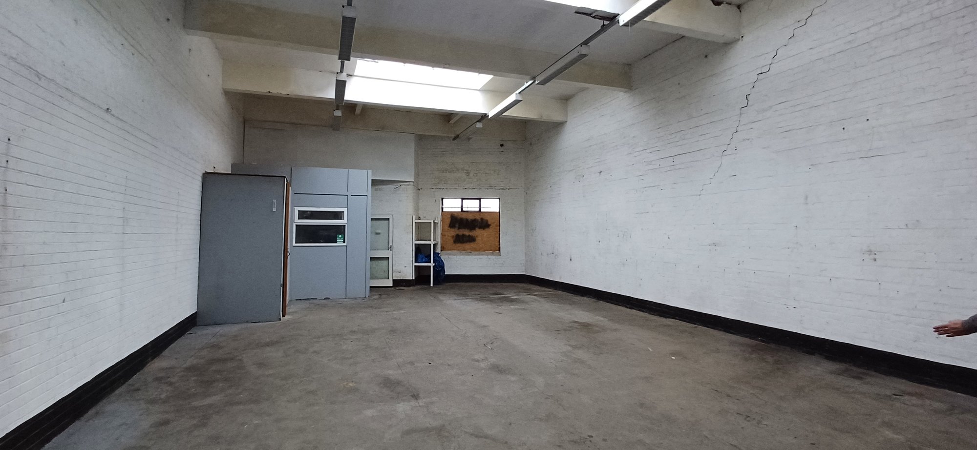

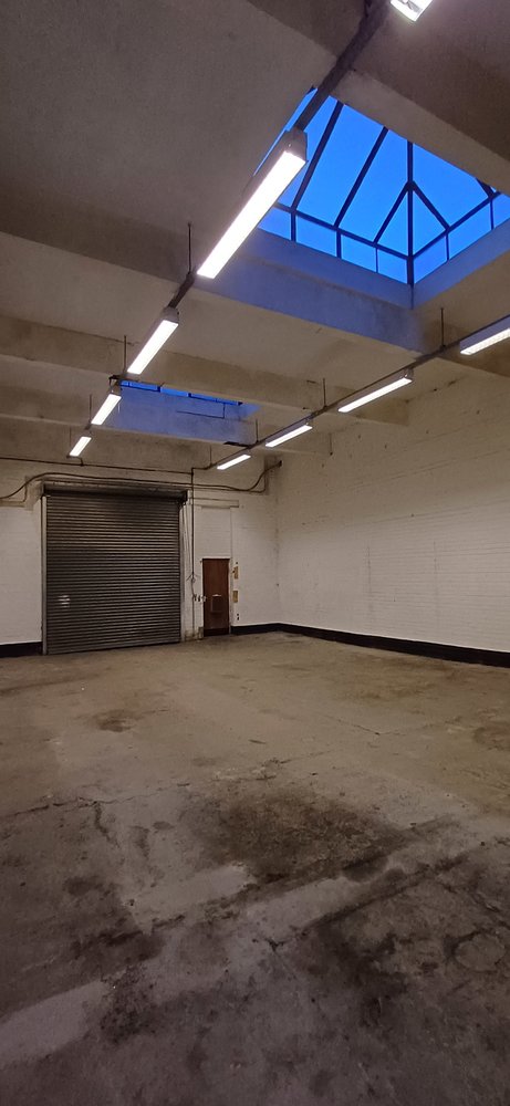

We are tenants but have been told that arefine with us doing a mezzanine@Olderisbetter Are you a tenant or the owner? The answer will have a bearing on what you do/want to do.
If its got legs wont impact the building structure anyway, just a few fixings, easily filled when you leave if required.We are tenants but have been told that arefine with us doing a mezzanine
