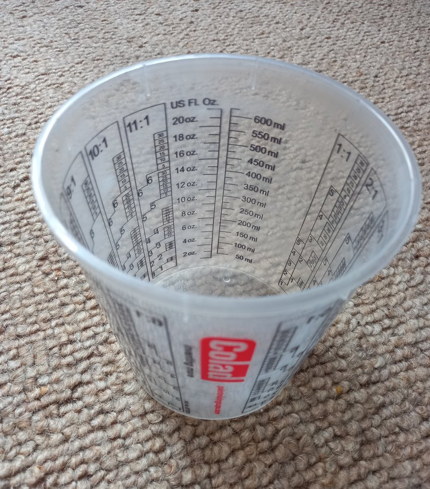

Basically I have a new front wing on a 1991 vw polo. I have removed transit paint and used 80g then panel wipe and painted with two coats of novel light grey epoxy with a 1.4 devilbiss gpi.
I used paint code on sticker I found in the boot of the car Basically is a metallic green.
I have passed the window with the epoxy so I need to key with ? 600 or 400 ?
I have used autopaints St helens in the past and so that's my suppler.
With the order on the metallic paint will I need base coat thinner ?
What the general rule on mixing ratio 2 -1 ? Would two coats of base coat metallic be required ?
I will follow with u-pol hs clear within 10-15 minute window ?
I'm not good with talking on the phone so that's why I'm asking on here.
If I have missed any process please correct me.
Much appreciated for your advice.
