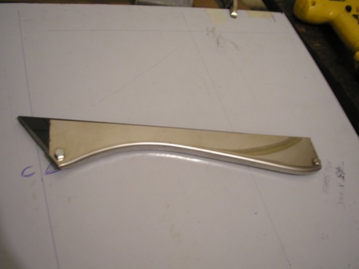

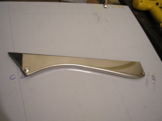

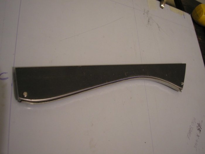

This is/will be stainless trim pieces hammerformed over a piece of 6mm plate. MDF works well for a few aluminium parts, hardwood lasts longer if more panels are needed and a router is perfect for putting the radii on the edges. With gentle changes in shape i imagine wood will work for a couple of 18/20swg steel panels
I put the radius on the edge with a ball pein hammer on a flat surface.
By radiusing both panels, the weld is in the shaped bit of the metal and there's practically no distortion, which can be a problem if you're welding big flat panels.
