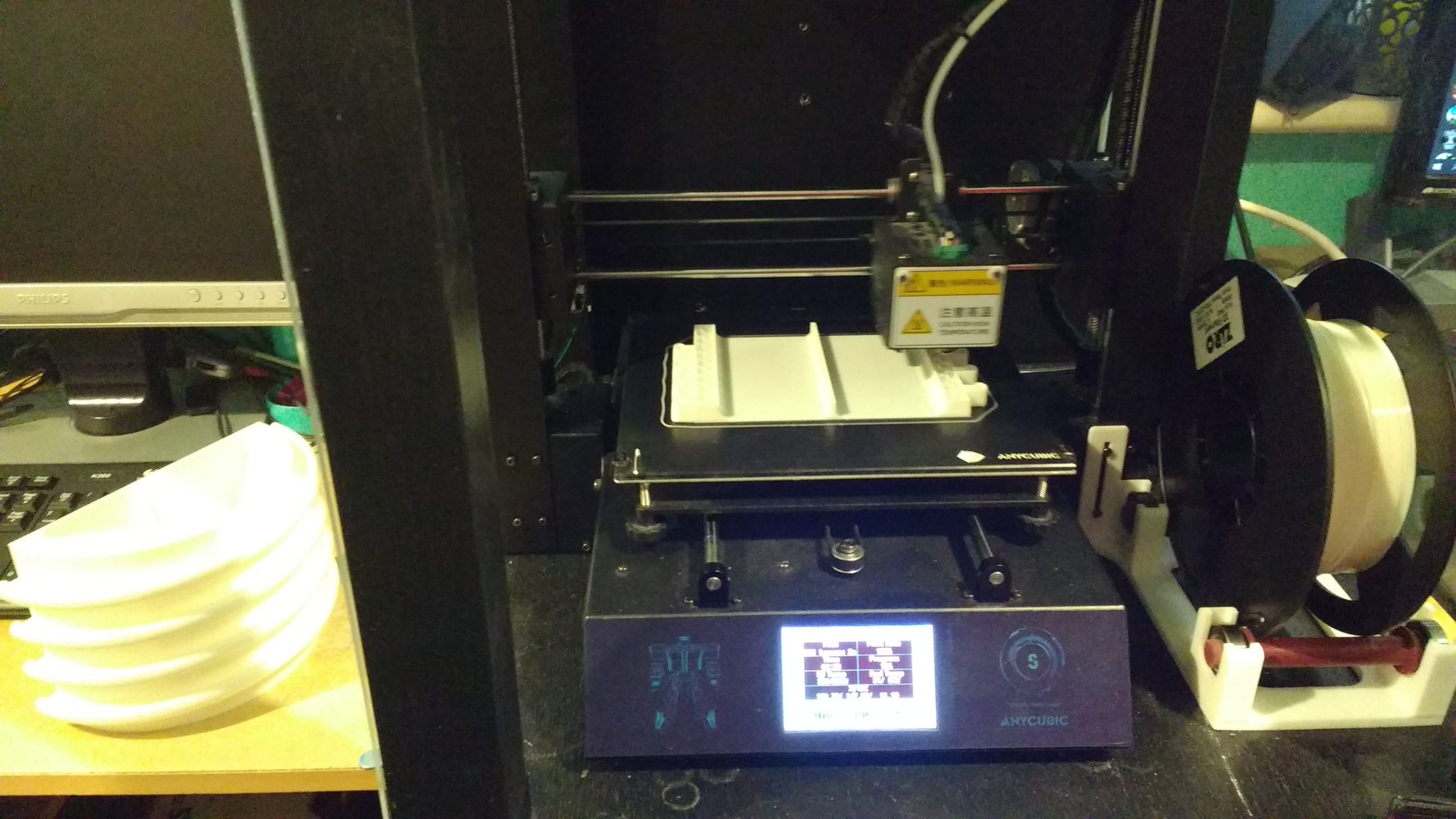

Looks bloody good from here, considering it came from my sketch a few posts up! Done a great job getting the idea into fusion and printed!
An alternative may be butter.
How are you going to remove the form, looks like it has undercuts - burning out might be an option I guess?
Blimey, good luck with that!Tentative plan to "grease up" the PLA former and wind it out of the clay.

If you could manage without the element groove being lipped, with a bit of thought, you could make the internal former in sections that could be withdrawn internally.
Just a silly idea as you've gone to all the trouble, but what about making a former to hold a piece of spiral nylon hose in place?
When the clay (?) has set unscrew the former and then take to hose out.

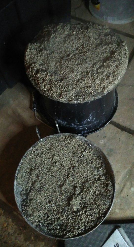

The lid I had filled with insulation, is now half unfilled. It seems cooking it for 3-4 hours on a medium heat is just not enough, the steam created will condense on the cold half of the perlite before it gets a chance to escape, staying wet.
