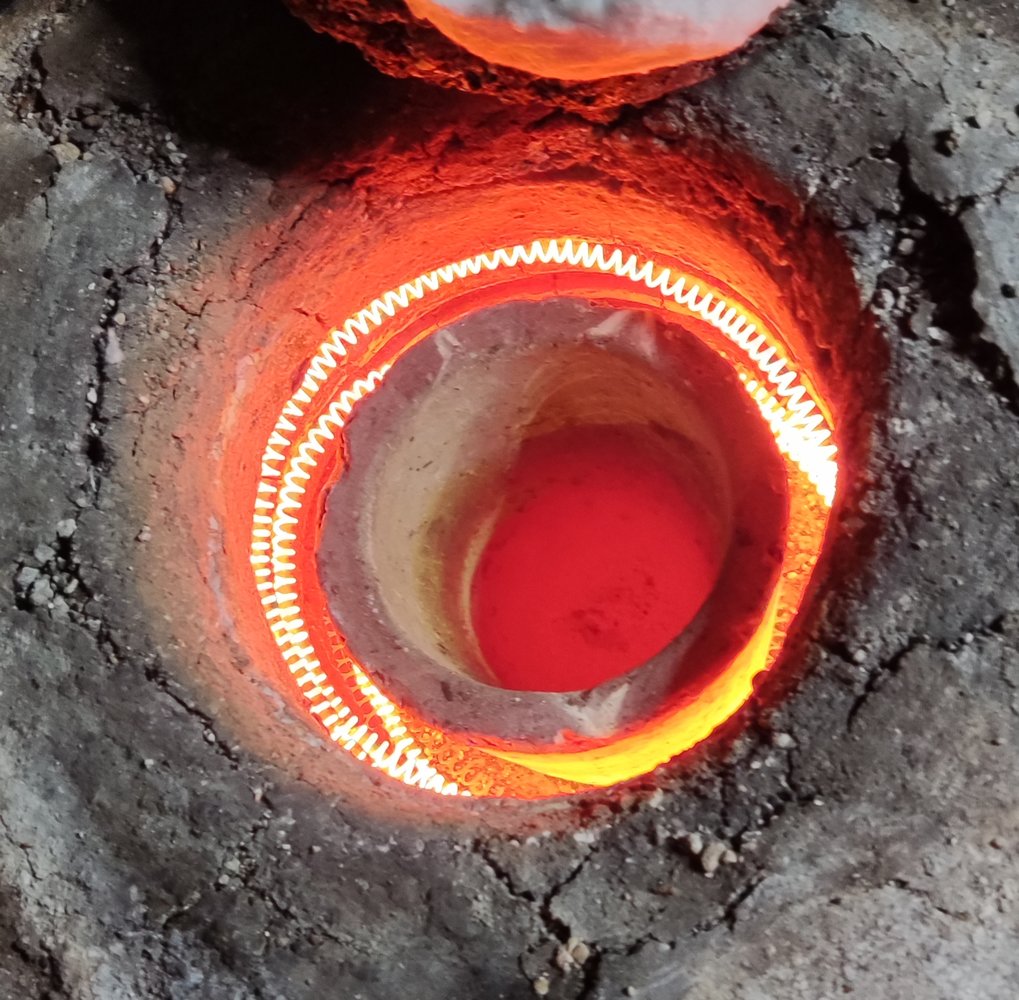

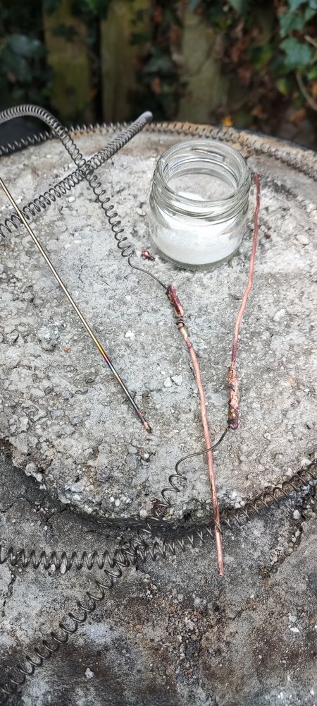

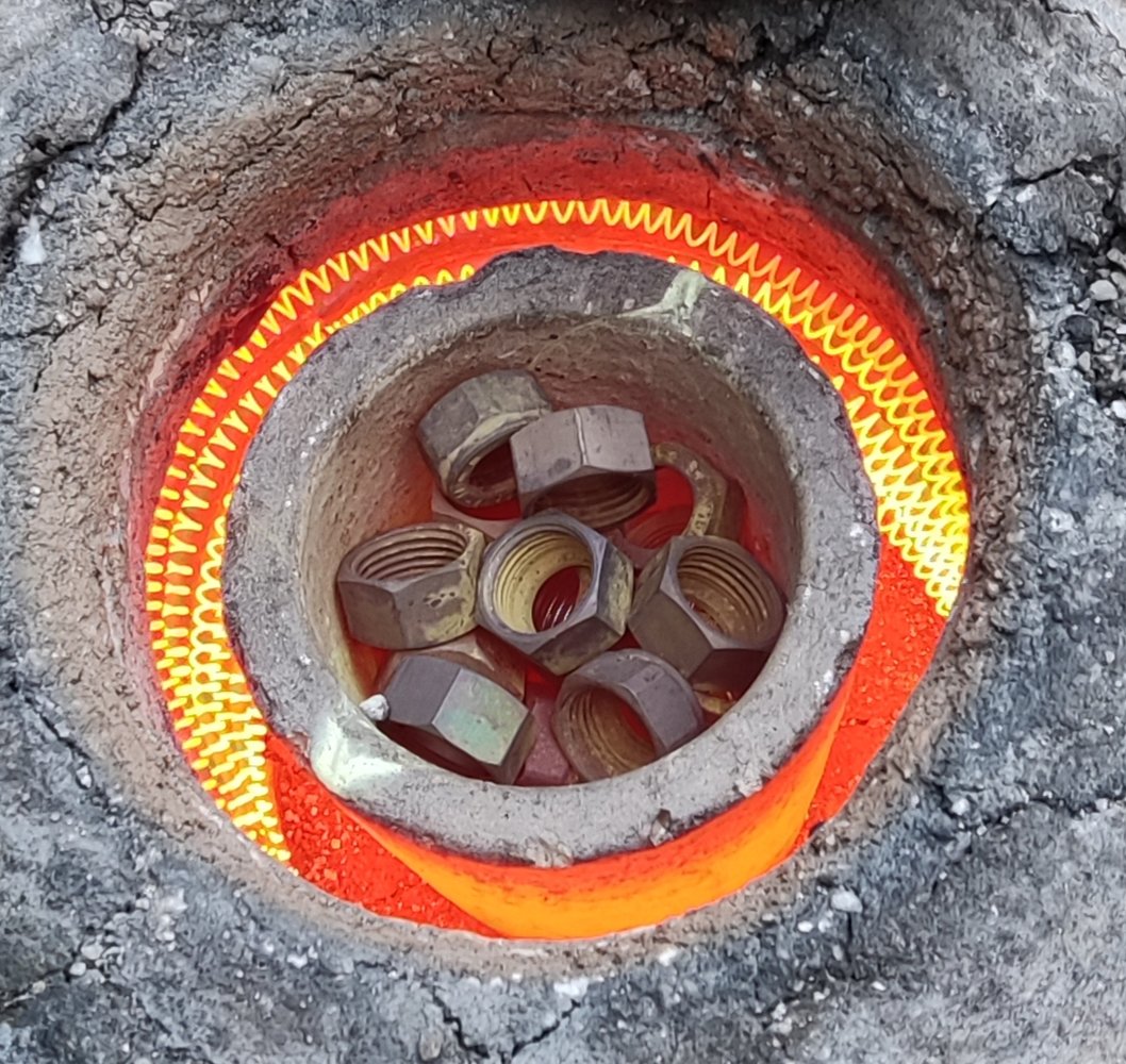

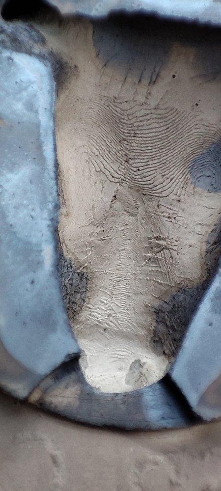

New element connections. Last time I crimped copper tube around it to suck some heat out - copper melts at element temperatures! But Im out of scrap tube.
This time I gas brazed the copper with sillicon bronze tig rod and borax. Near enough the melting point and should add enough mass at the hot end to prevent connections melting.
@Onoff I will try to do a pour this week!
SCR giving a range of 180-1900w which is much more usable, decent power factor at 800-1500w which is where it will be used most.
