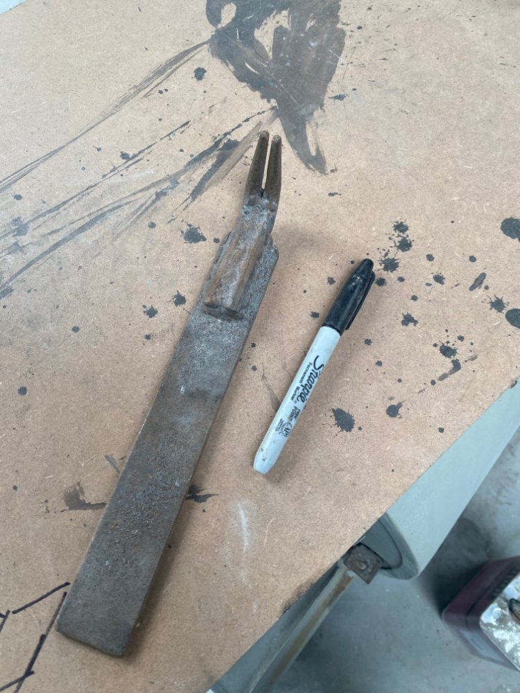

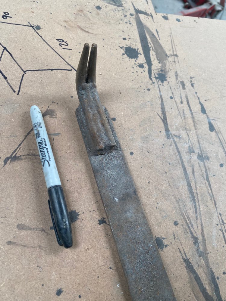

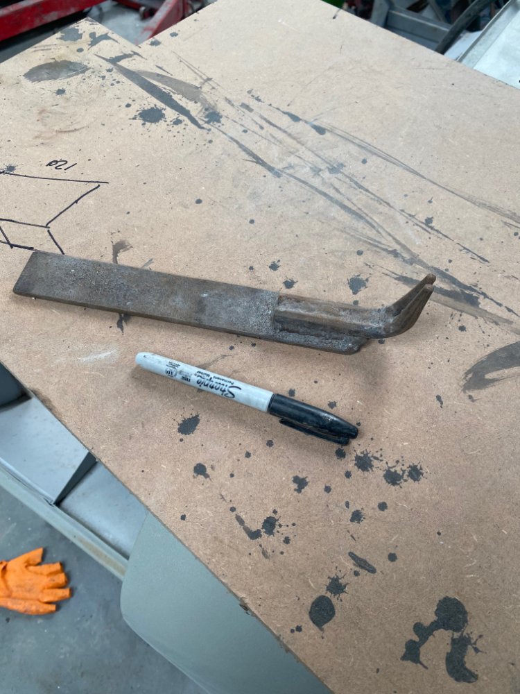

You've missed the part where you trap the tuck. It will still work without but not as effective.
I have no idea how you'd do that in this case. I rely on the grippy "anvil" which constrains the material. If I bolt it down somehow I can see how that would be bettr but that is a very awkward shape to work with. When you hammer inside for example, it's difficult not to foul the edge with your hammer or the occasional finger.
A sand bag would be a much better bet. I have to move the position of the workpiece constantly so fixing it would be extremely tedious, be very interested to hear of some tips and tricks though. This is fun!
), then it's case of flattening it out, you are therefore reducing the surface area of that piece of metal, thus shrinking.
