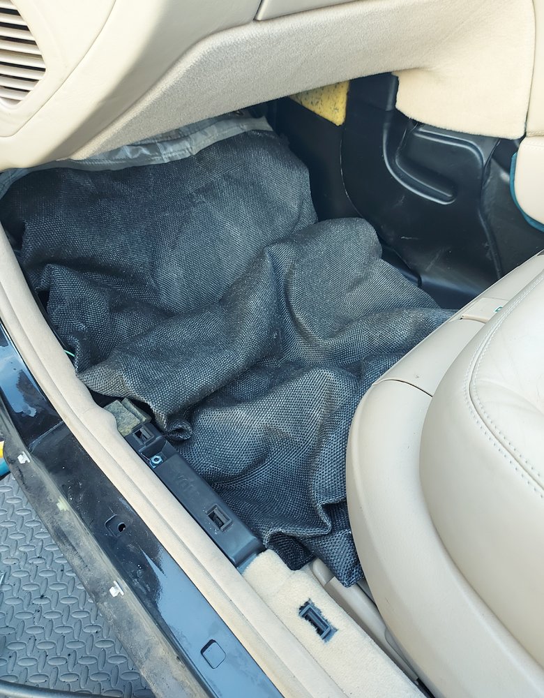

I always remove the foam carpets above anywhere I am welding. And loosen / chock up any plastic wire ducts. In my 600 I did this and laid a welding blanket into the footwell to protect the interior from any sparks.
