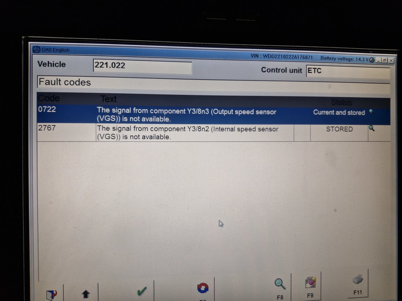

I coasted it off the road safely and got a friend to recover it to my house. I have MB star diagnostic laptop and there are no new trouble codes. I say no new ones as it always had these codes which never caused it an issue:
On the dash it goes into drive & reverse etc OK. Revs up but will not move at all. Zero movement car just sits there.
Reset codes and same.
I reckon she has had some sort of complete and sudden oil pump failure. The live data doesn't let me see the oil pressure values but I'll loosen a cooler hose and see does it have pressure - I'd guess no as that is really the only thing that would cause it to have no drive at all.
