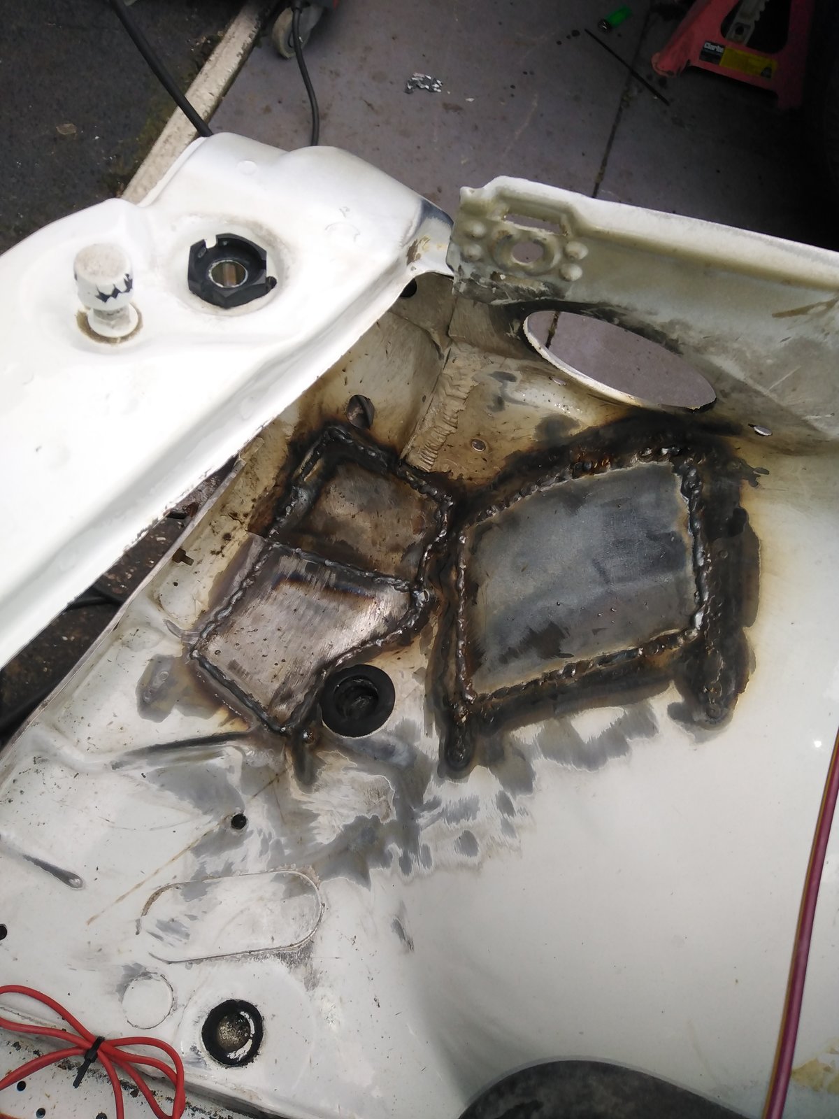

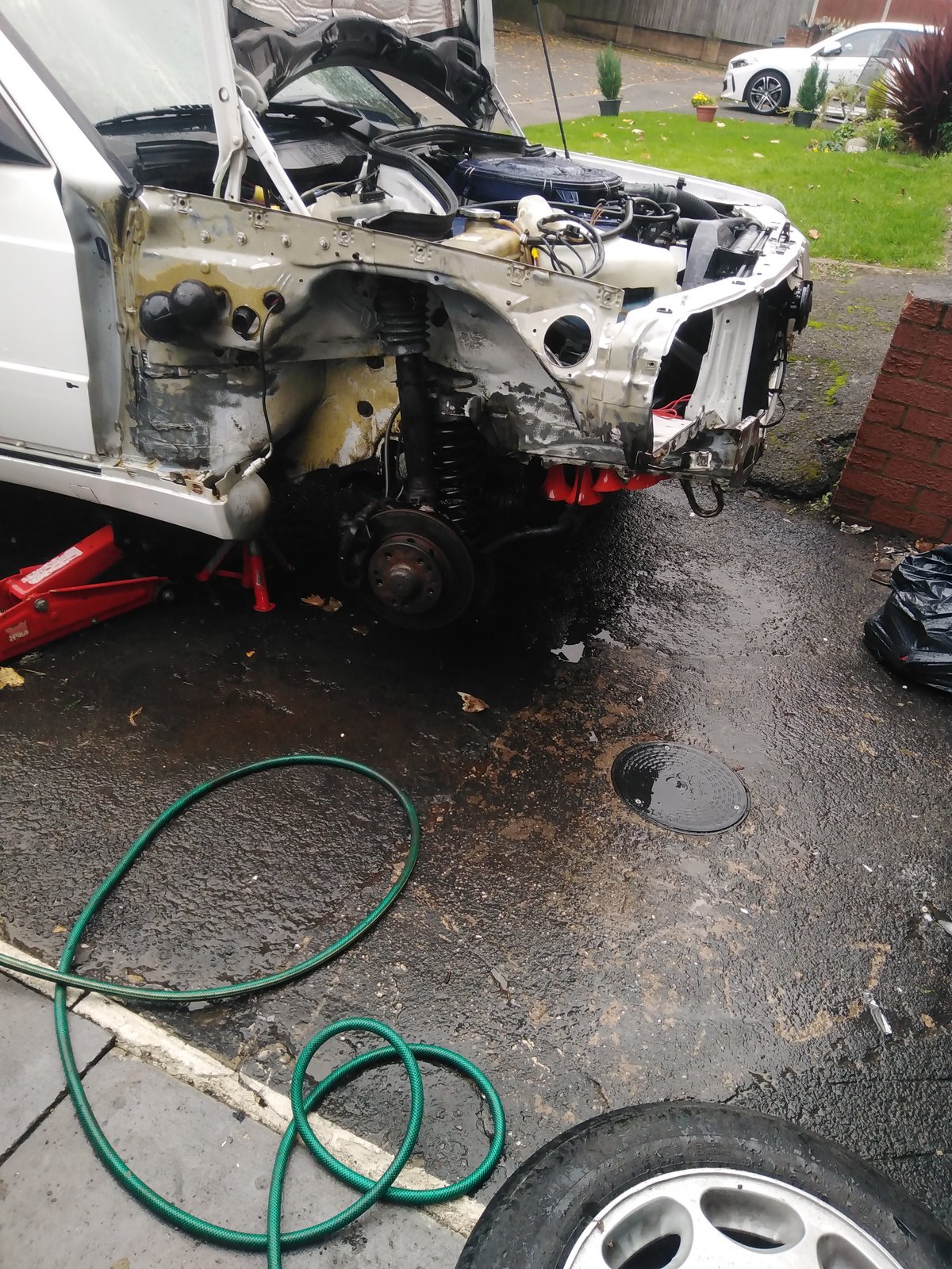

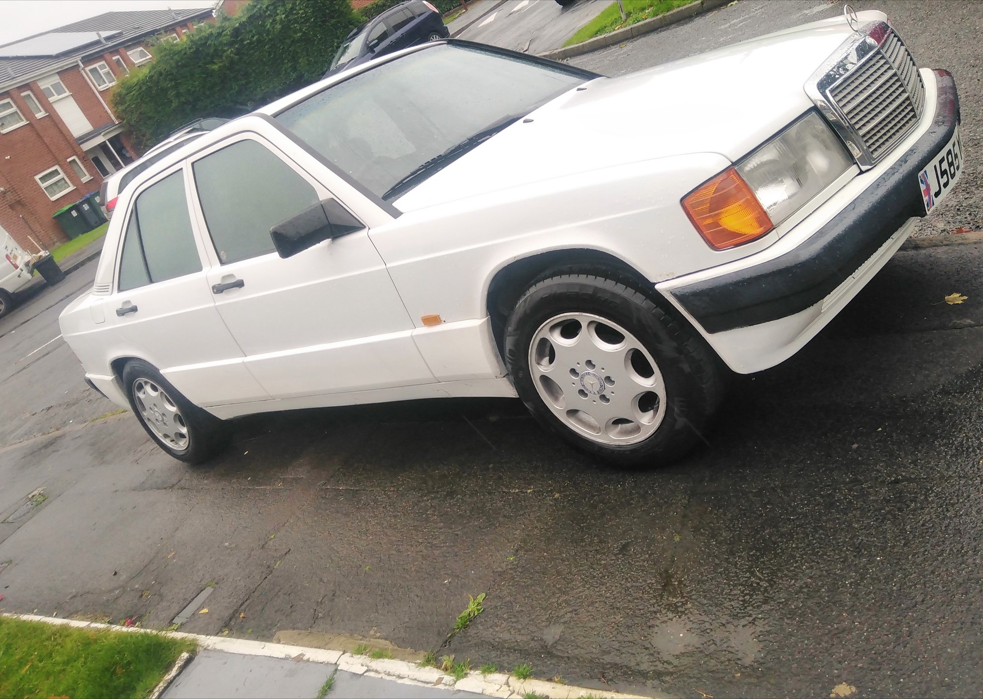

A 30 year old Mercedes was always going to become a project
1991 1.8 190e basic spec bought completly blind.
The plan is to get it ready for its Mot, then drive it for a year, it'll come off the road for a underbody rebuild after that.
Ive had it up and while it's abit dirty, the majority of the body is still in very good condition,
Actually only a few jobs to do for the MOT,

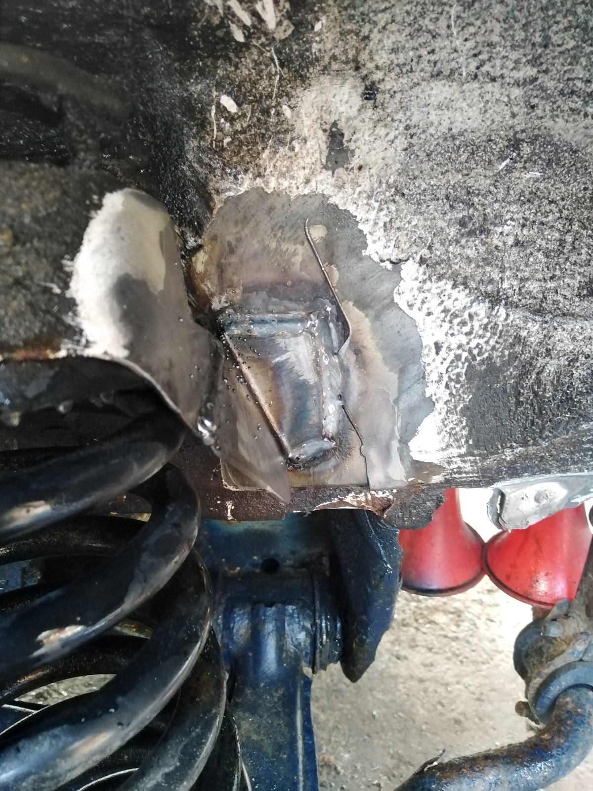

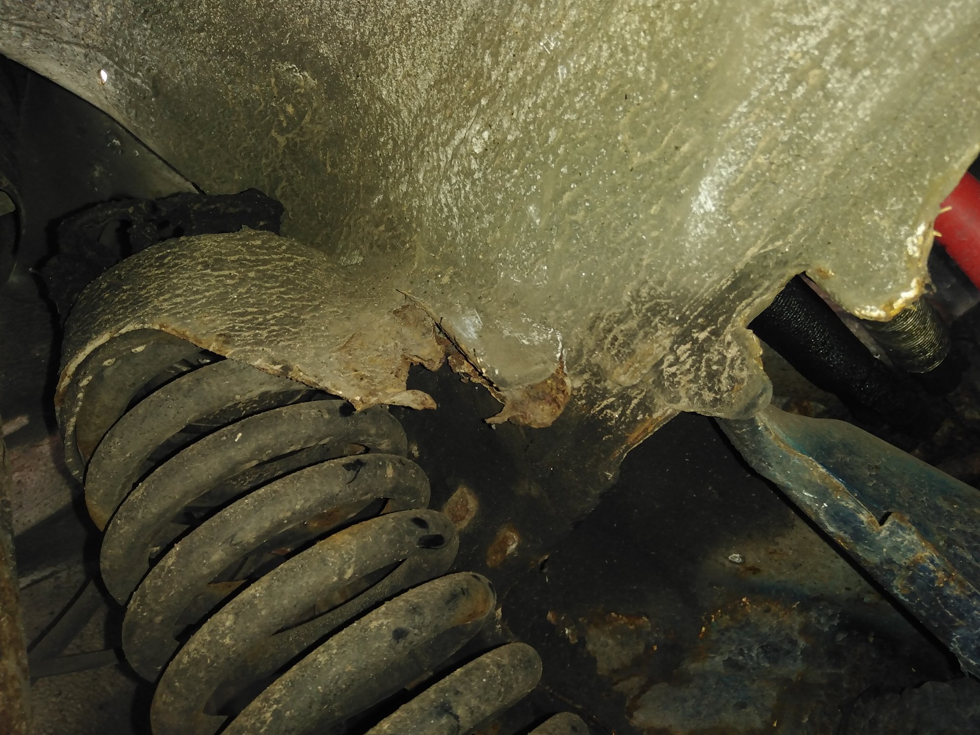

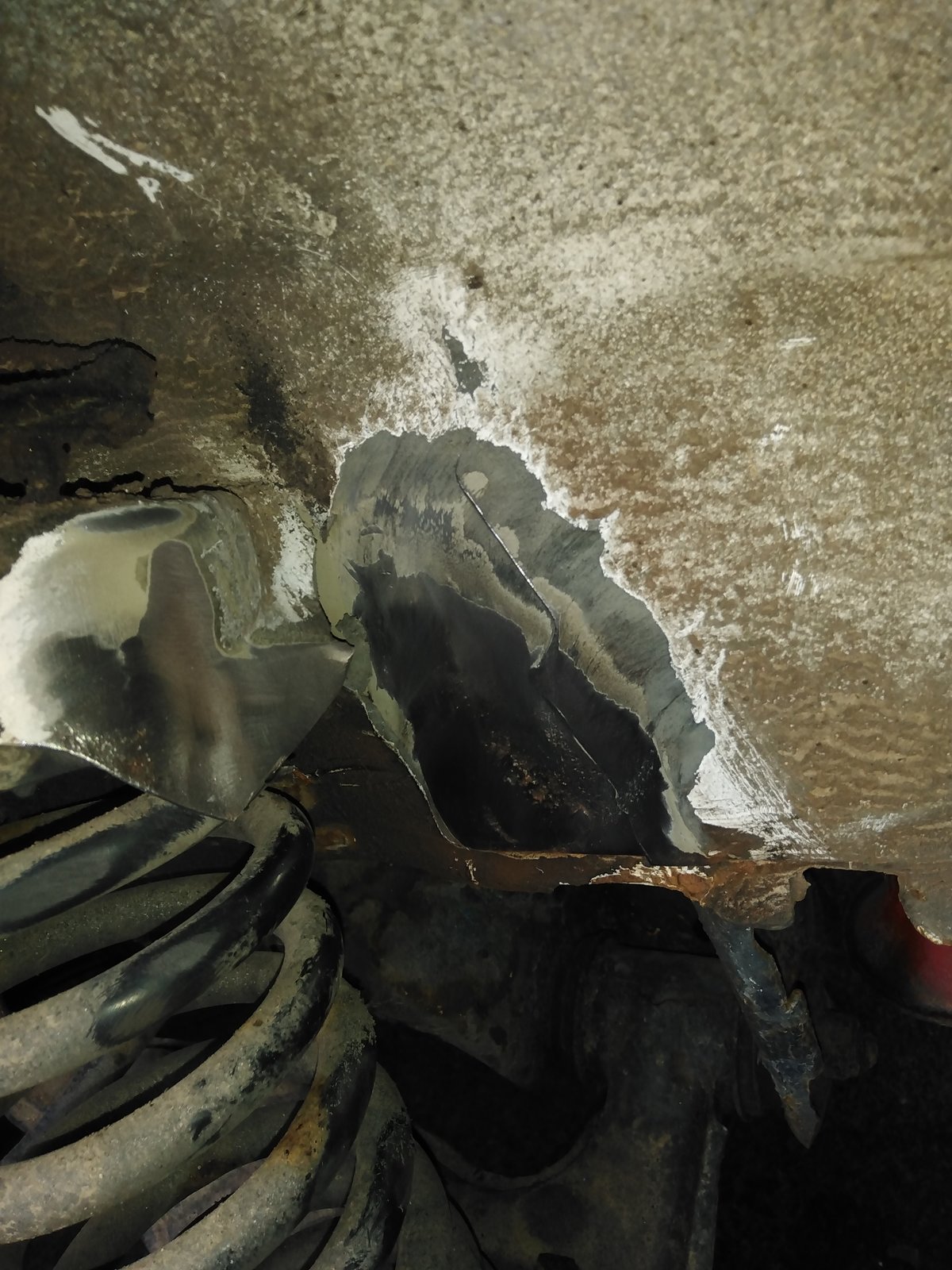

Spring perch is starting to rust away on one side, I'll chop the rusty bit out and weld in a new bit.
Middle silencer is completly shot, I might just do away with this and put a straight pipe temporarily for MOT, it'll get a full stainless system in the rebuild.

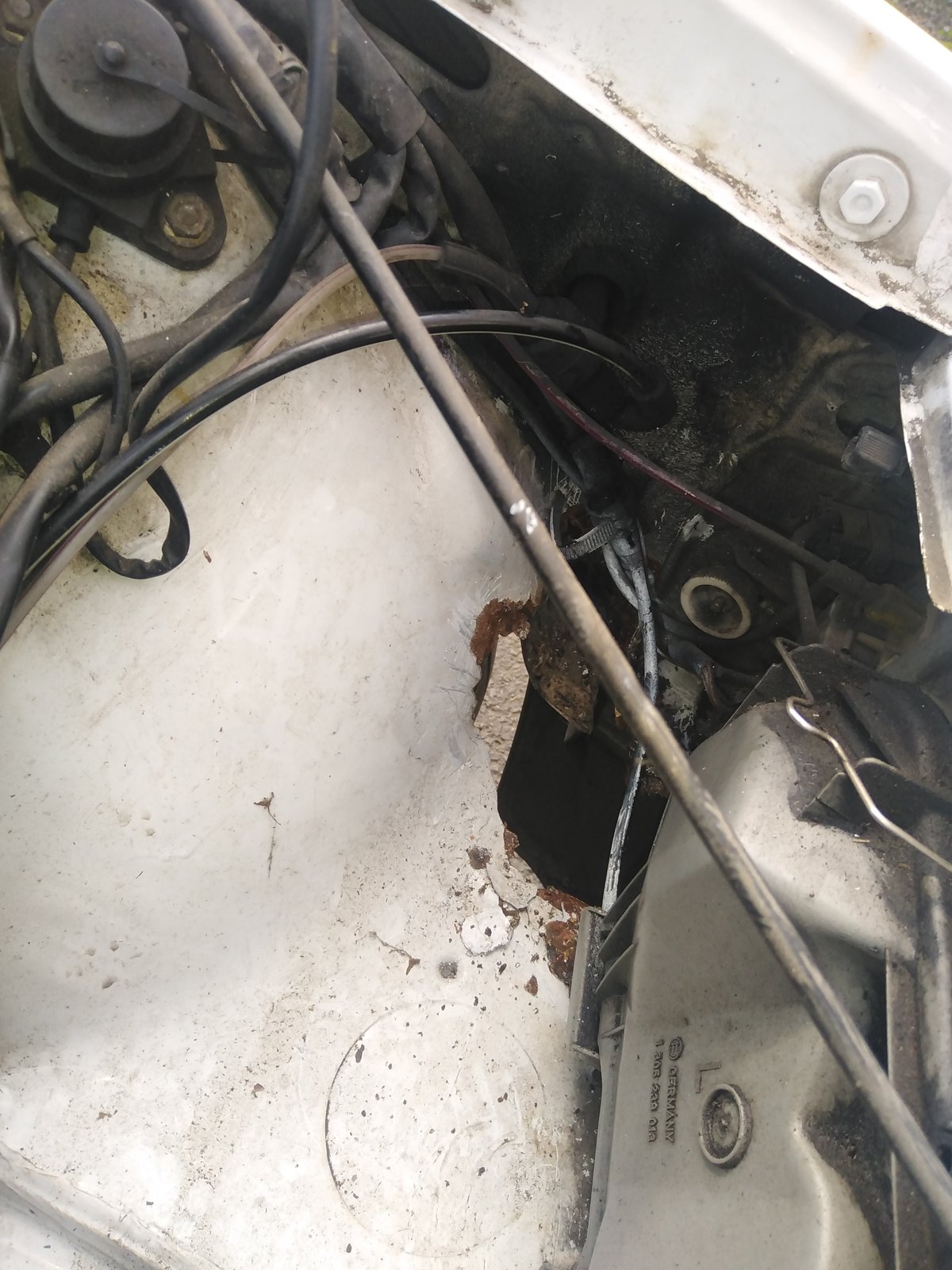

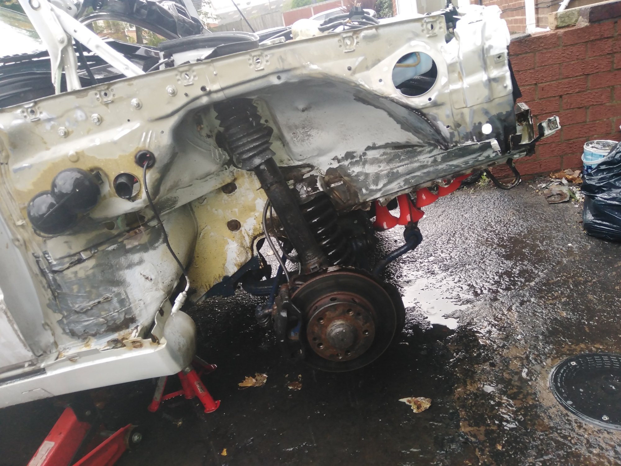

Inner arch joint rotten out, looks like I have plenty of access to this so should be fairly easy.
