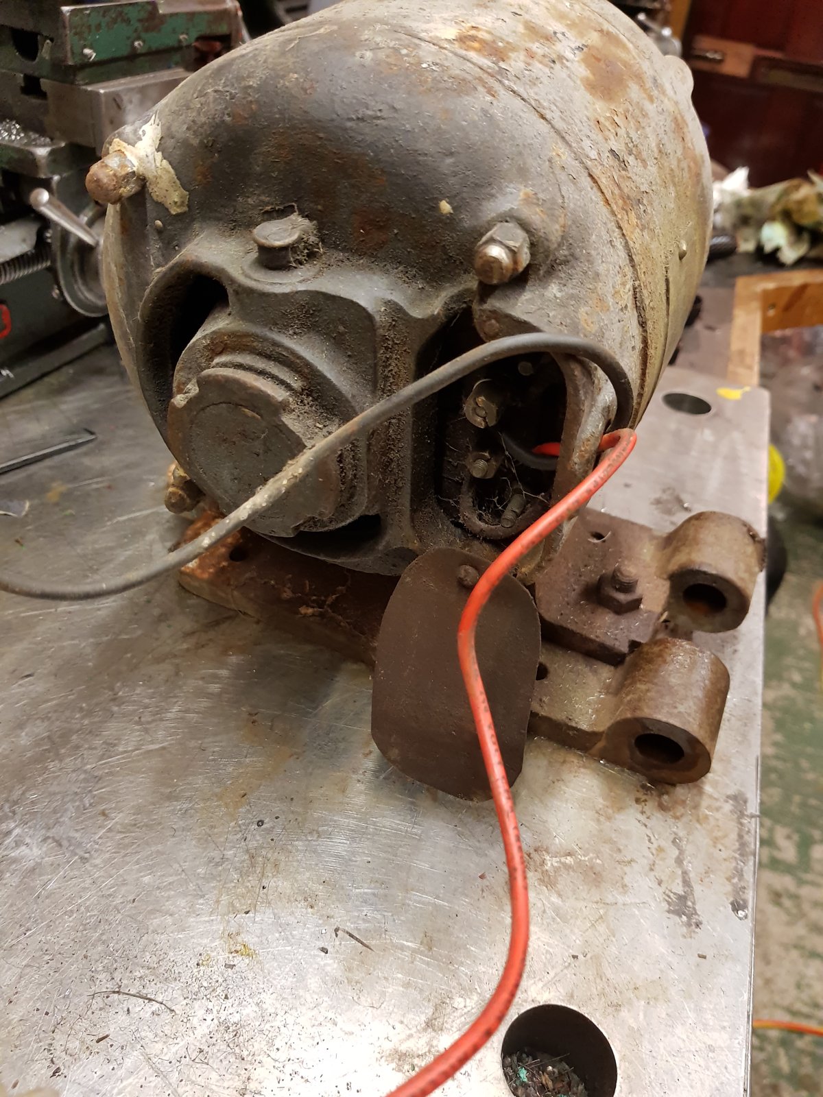

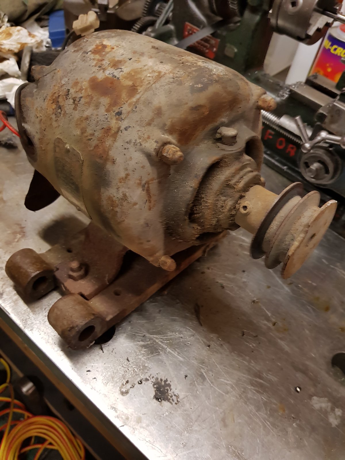

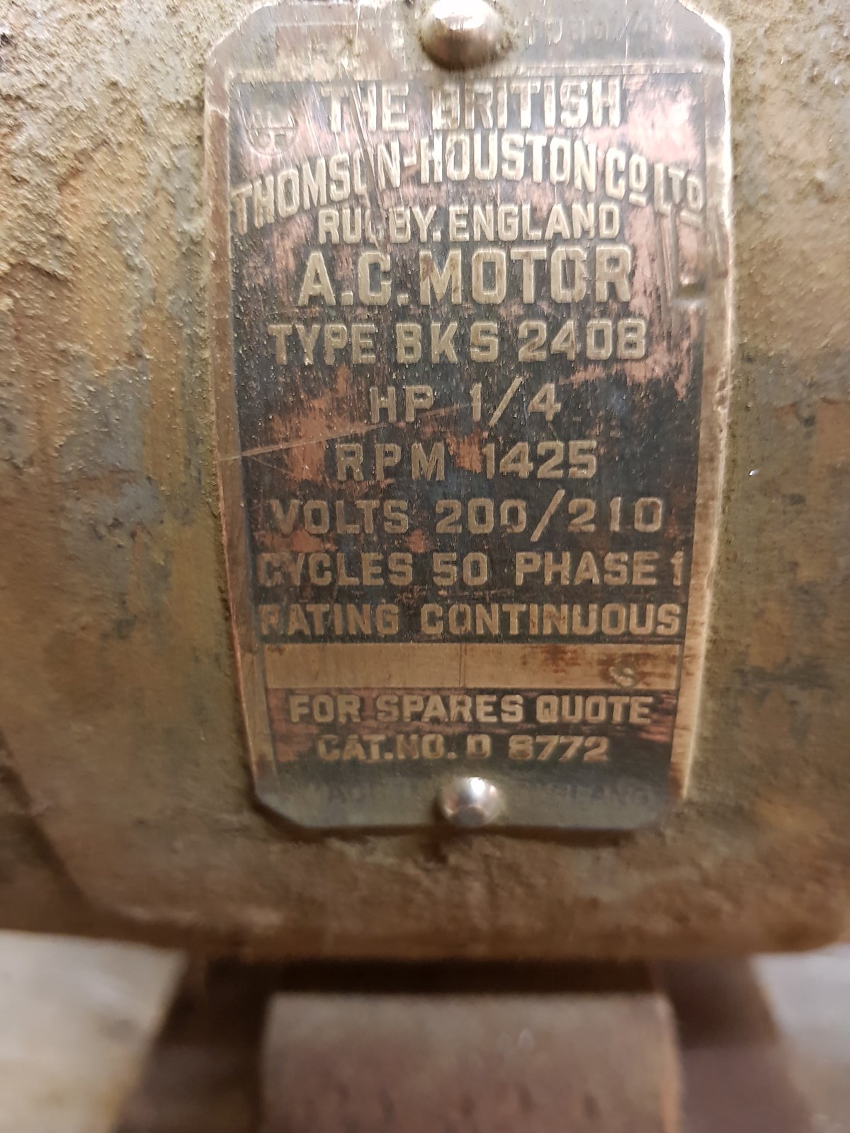

a quarter hp wont give much poke better with a 1/3 hp or a halfManaged to get the motor out it's bracket. A proper nightmare job as the bracket had seized. The motor itself looks like it's cam out the ark .... and really bad wiring...thinking of replacing the motor.View attachment 124443 View attachment 124444 View attachment 124445
Yer. Will replace it.a quarter hp wont give much poke better with a 1/3 hp or a half
