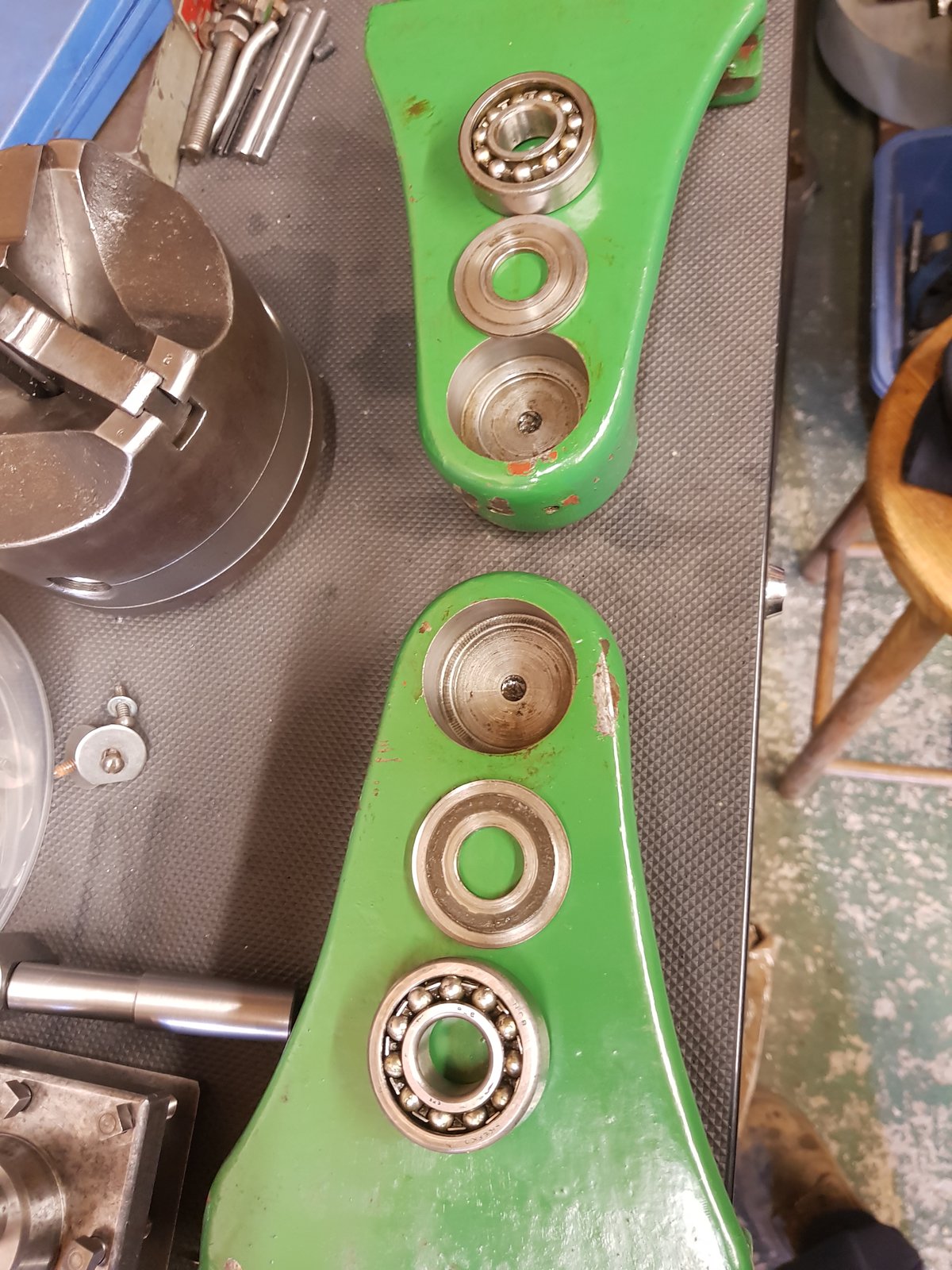

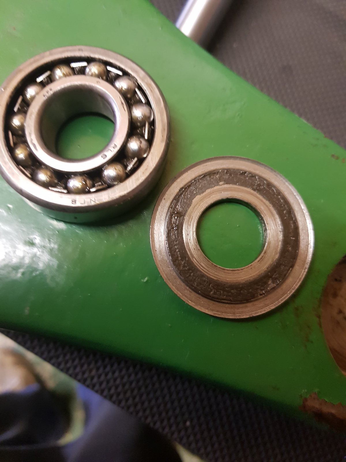

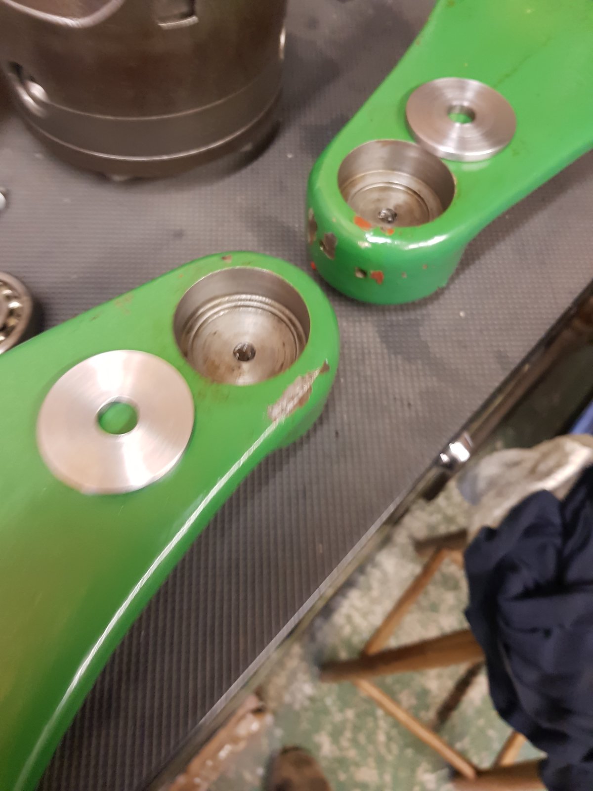

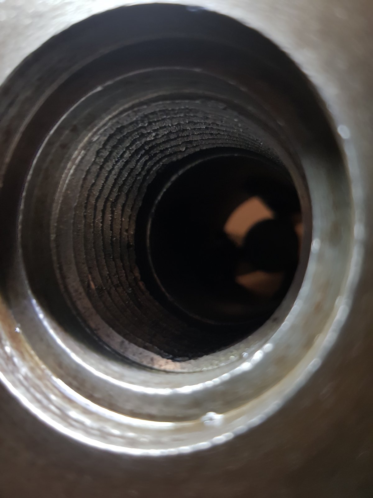

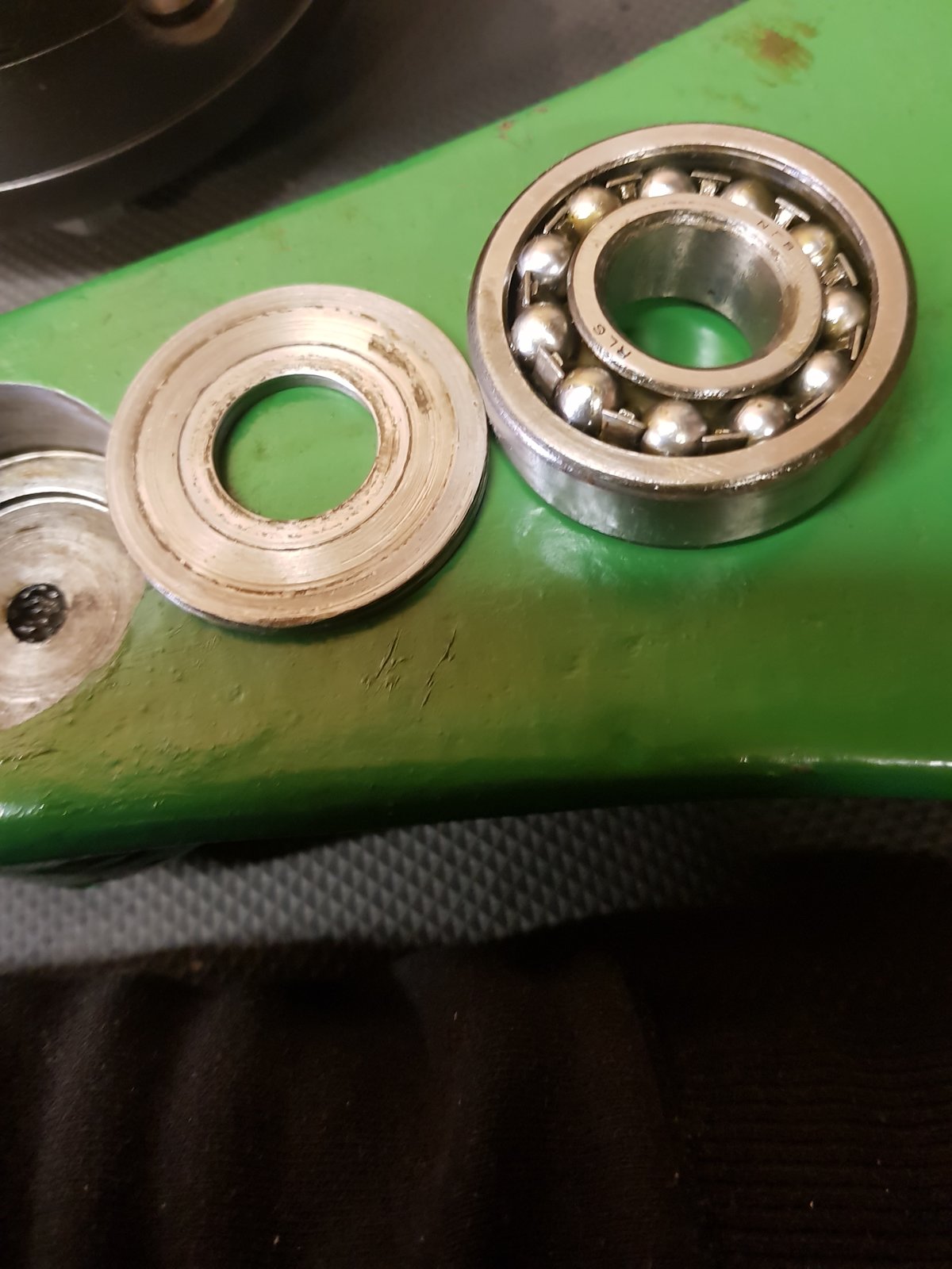

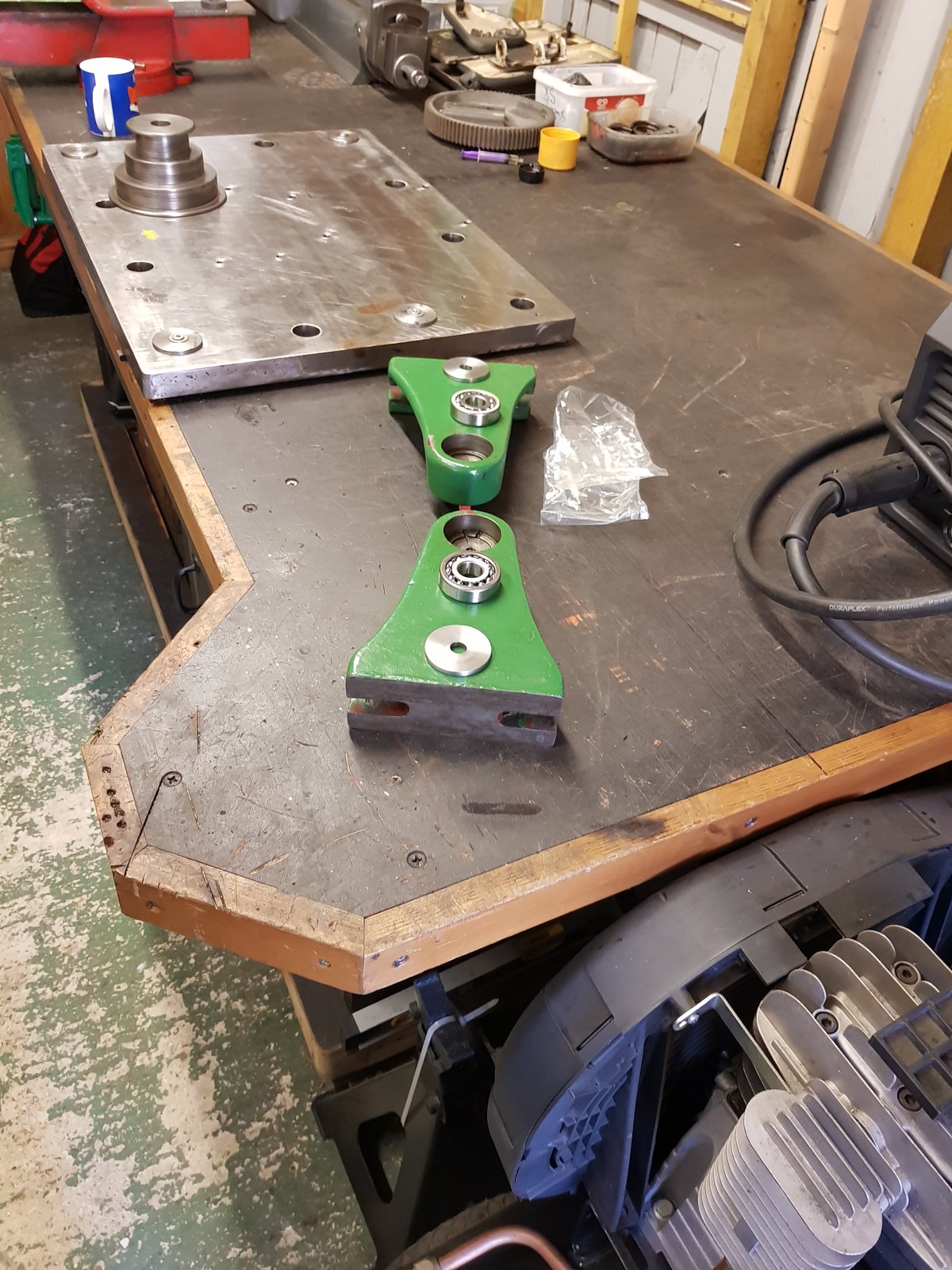

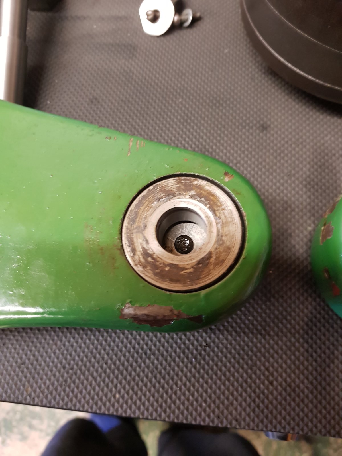

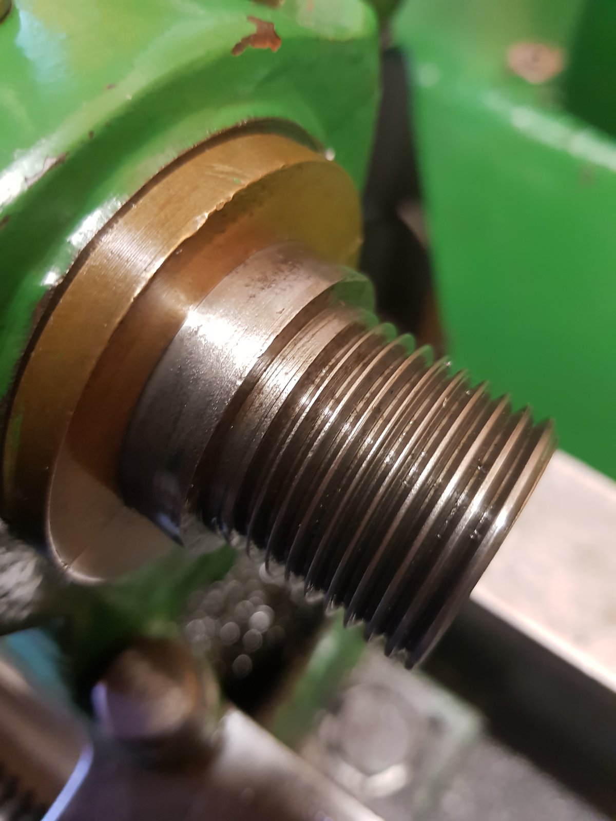

My Mellor lathe is back in hospital again. This time for a new set of pulley shaft bearings as these ones are totally shot. A trip to polar bearings tomorrow and see if they can match them. These ones swivel to. Also my chuck backplate threads ain't all that. Looks like someone cut them with a hammer and chisel. I did sus out the spindle thread size. 1 1/4 9tpi whitworth fine. So a new backplate is in order. All good fun not.
