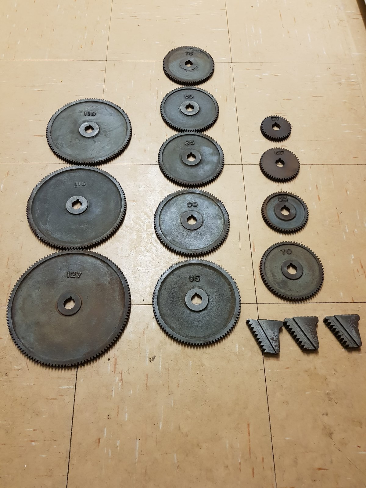

Tell you what that's a nice little lathe and not much used. Take care not to over speed the plain bearings and check if they are wick-fed coz they might need new oiling wicks. Going by the size of the change gears it looks like it might even cut metric threads, if they are all there.
What size gears are missing, and what's their bore? I assume they're standard tooth pattern?
