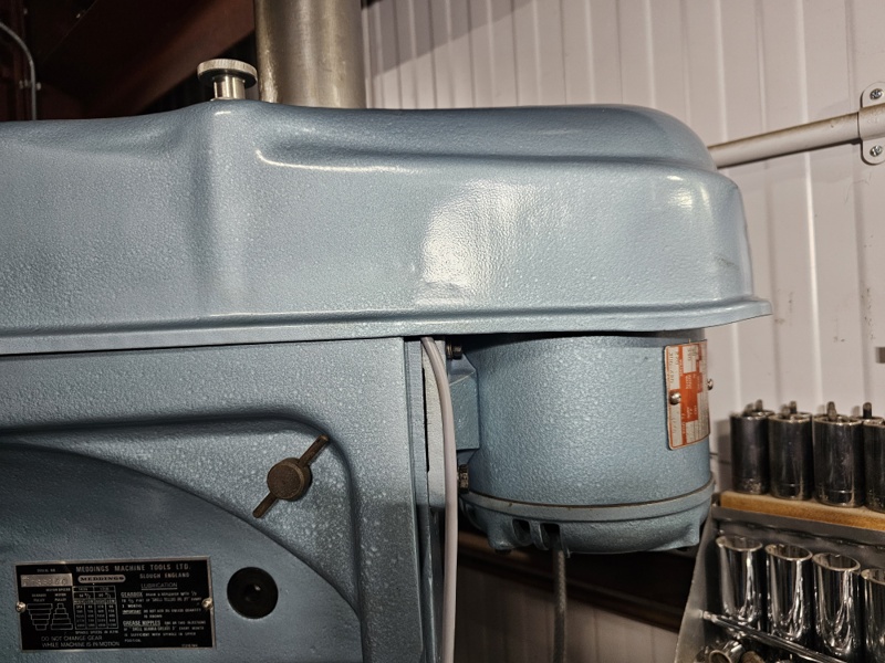

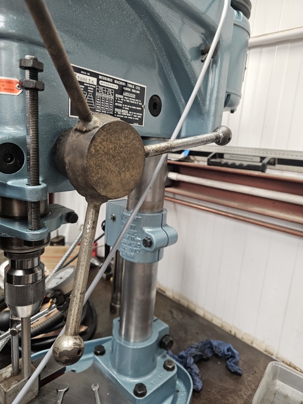

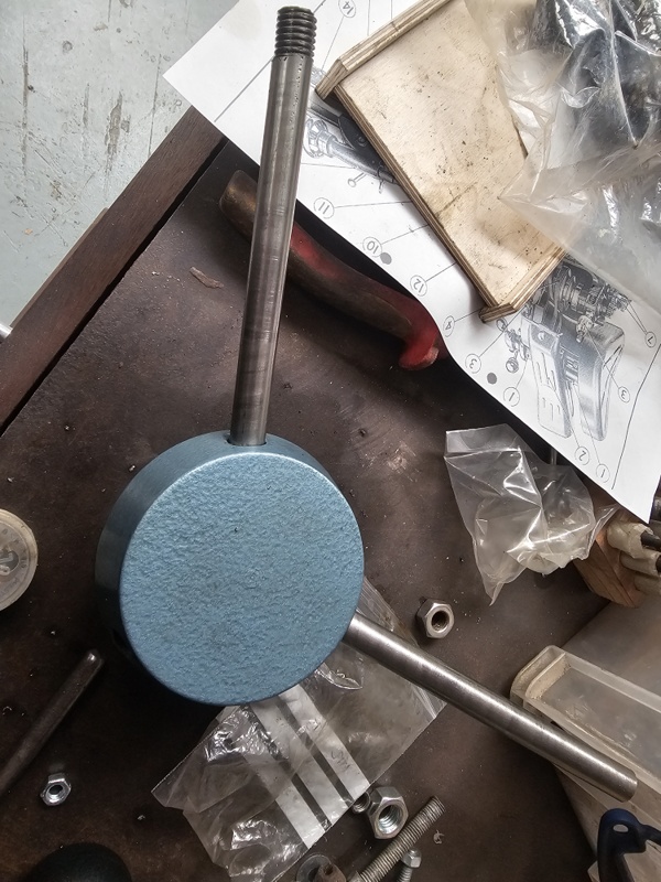

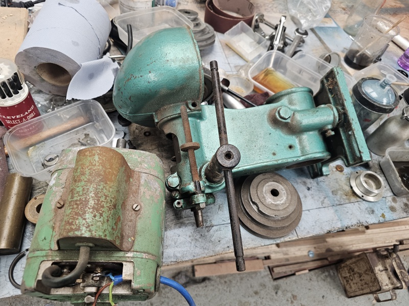

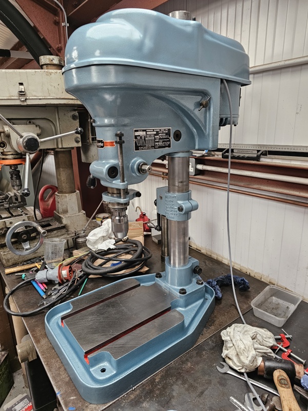

Lovely job, the next drill I get will be the sameNearly done.
Just got the quill handles to make, knobs to hold the lid down to adapt and fit and wire up the VFD.
VFD just arrived so I'll test that tomorrow.
It seems to be the drill/VFD and only when it is idle

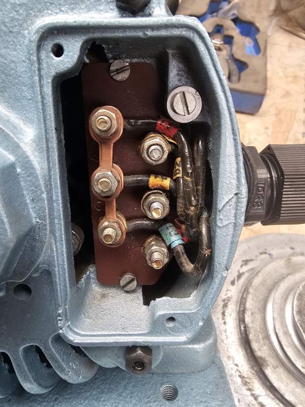

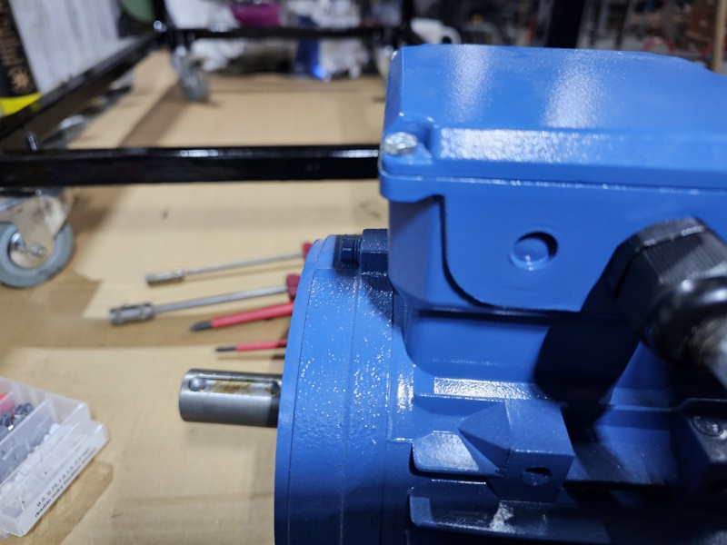

Almost all modern motors have the junction box up near the shaft end. So would clash with the cover.

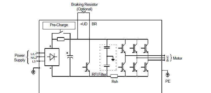

With your edit, I think you have realised the weakness in the link you make between effect (RCD tripping) and cause.
If the VFD is switched on but is idle (i.e. its output is zero), you should be able to dead short the three phases and nothing happen.
If, when its output is low, anything at all is coming out of the VFD, then that would point to a VFD fault.
Even so, you should even be able to switch the VFD output high with the phases shorted and the VFD should fault out without the RCD tripping.

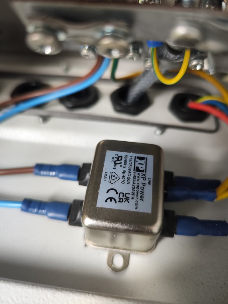

@brewdexta I had a problem with ABB VFDs tripping the breaker too.
Made a small post about it today.
Maybe try a similar filter I installed on all of my ABB VFDs/disable the internal EMC filter if you can on your VFD.
