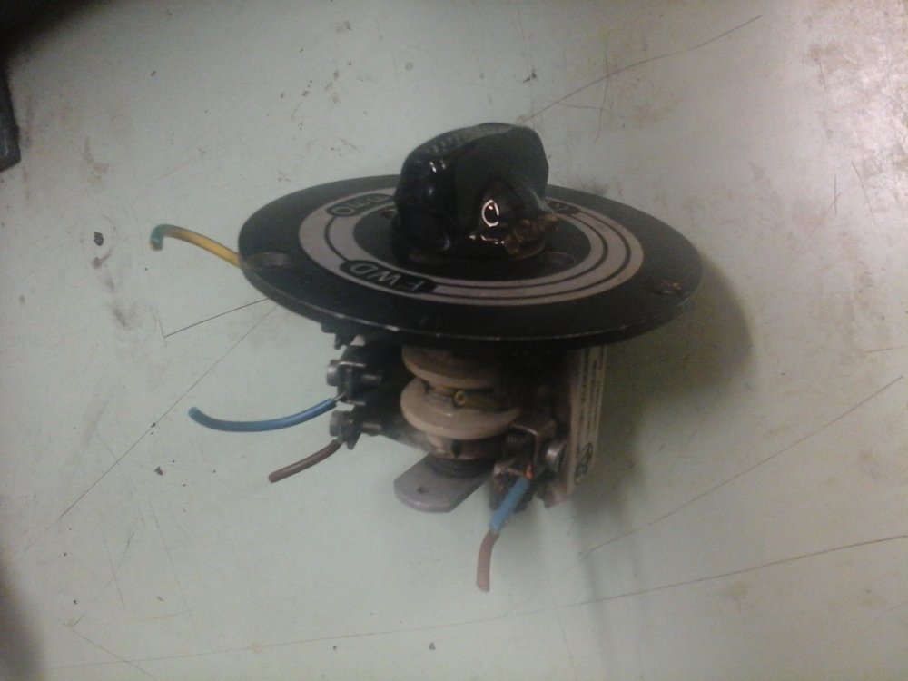

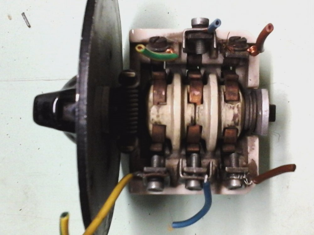

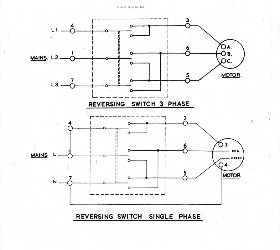

That's what I am trying to find out! The switch looks original but is a straight rotary switch - on - off - on and not forward - off - reverse as it should be. No other terminals. 3 terminals in, 3 terminals out.
I cannot see how a piece of the switch is missing or been changed. Was hoping that someone would have a picture of a switch to confirm its correct.
there dont look enough wires if 2 of them are live and neutral in
