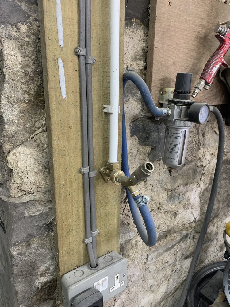

JG black plastic 15mm to 1/2" screwed into the steel pipe on the compressor and into a similar sized wallplate at the other (IIRC). I'll take a photo later.
It's controlled by a solenoid so I can have air when I want and turn it off when I've finished without having to go outside.
