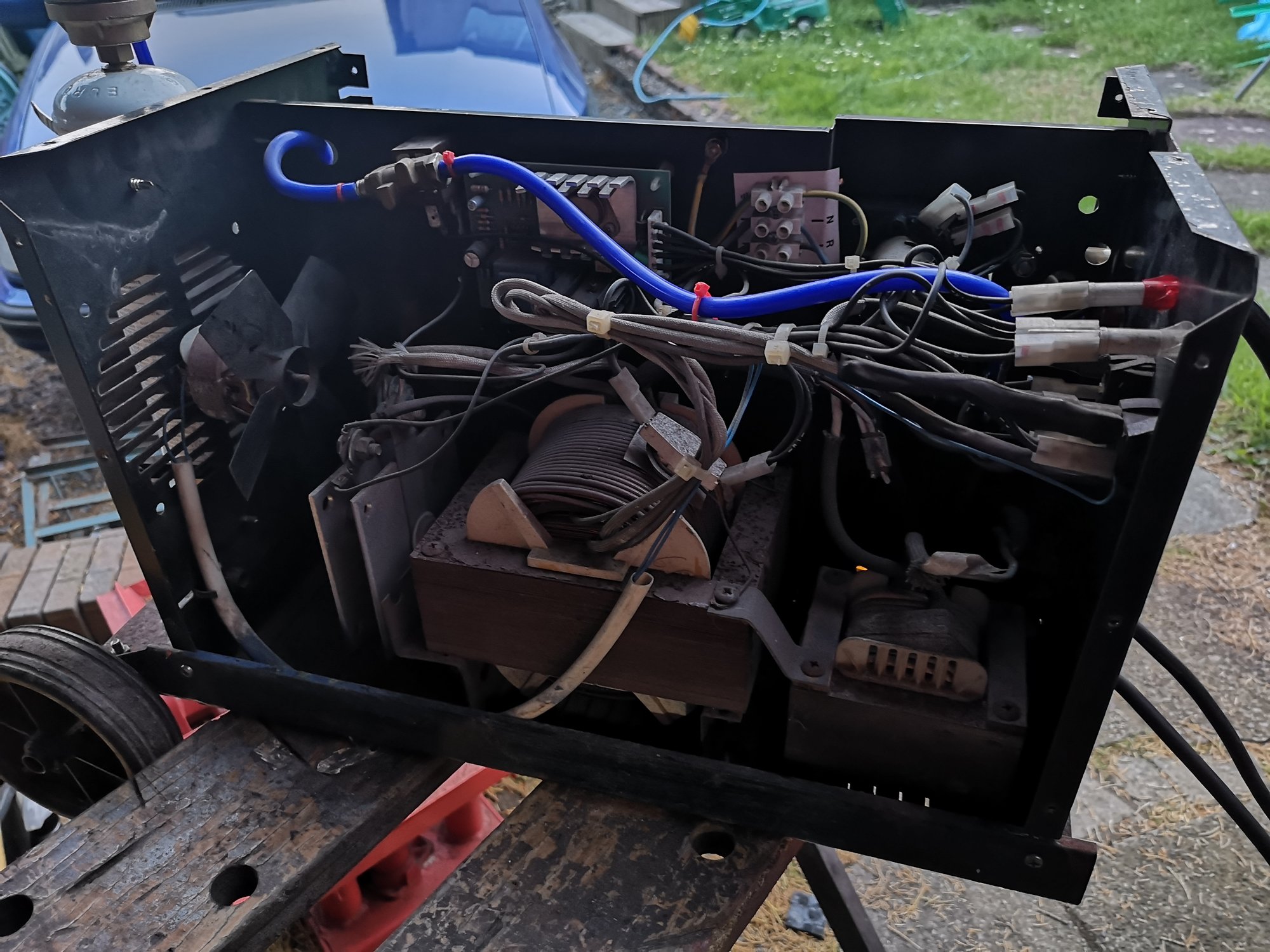

Hi folks, just wondering if anyone here is familiar with this machine?
I got it FOC, its never worked great tbh.

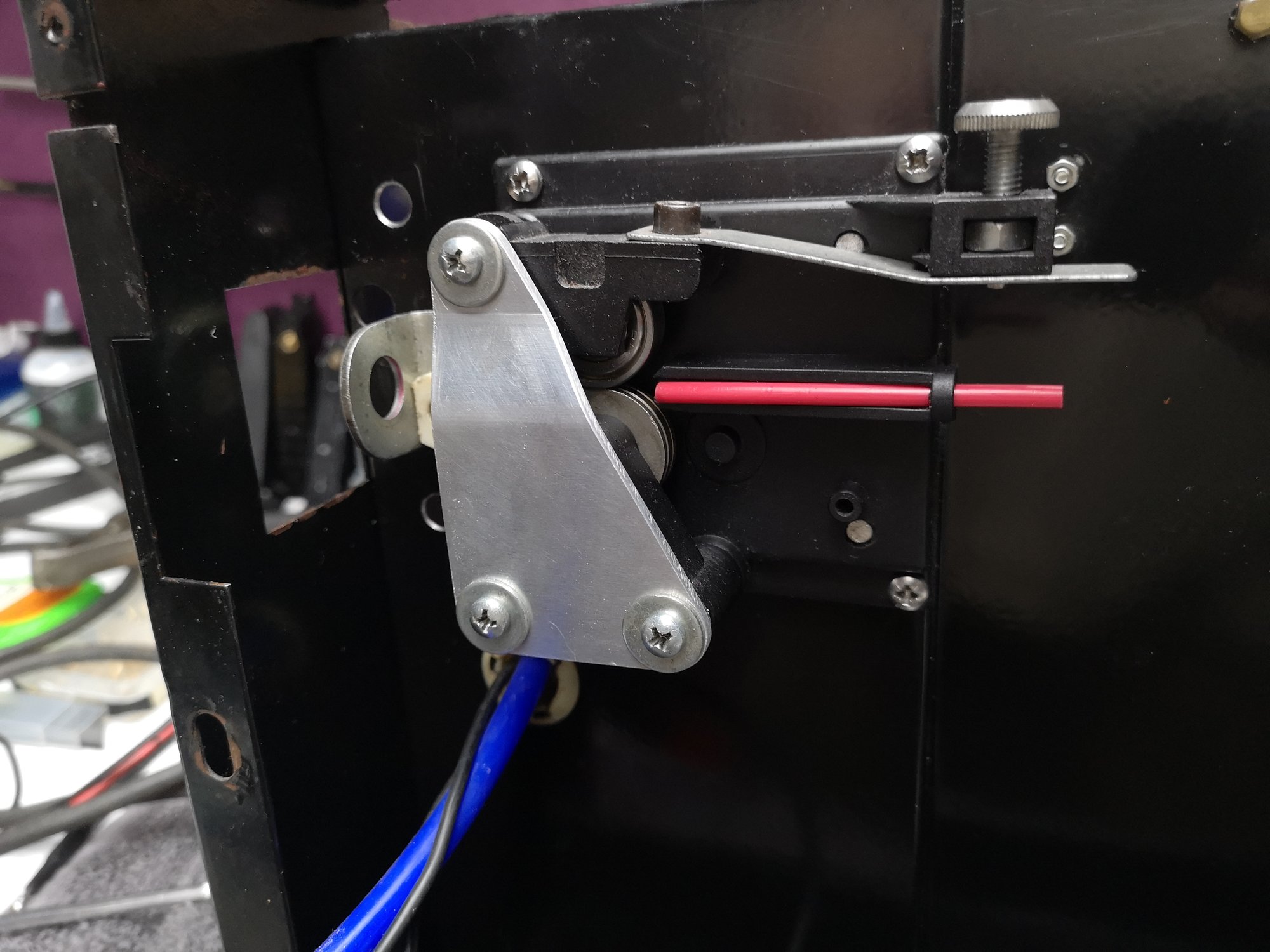

The main attachment for the cord at the machine end was broken, the cord and gun are not the original, it was sort of cobbled together... poorly. The bracket to attach the cord is a piece of angle... held on with one bolt, so the slightest bump misaligns the whole thing with the feeder.
So thats number 1 job, get that mounted solid, even if just temporary while I consider other options.
The wire feeder looks like yer pretty typical SIP type I've seen in other threads on here, will benefit from a bracer for sure as I can see the upper pivot and the lower serated wheel mount spreading under pressure.
Feeding, while not great, isn't the best and just making things harder for me - I'm working through old threads on here to scavenge ideas.

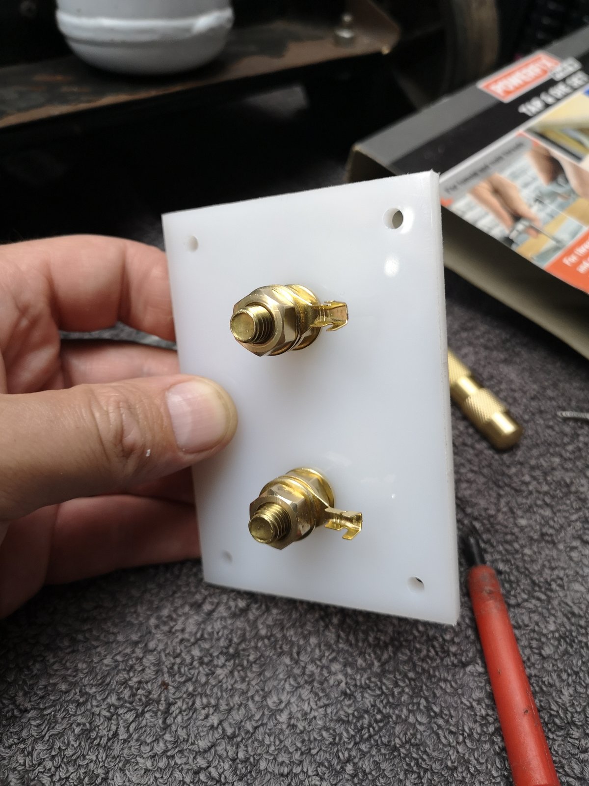

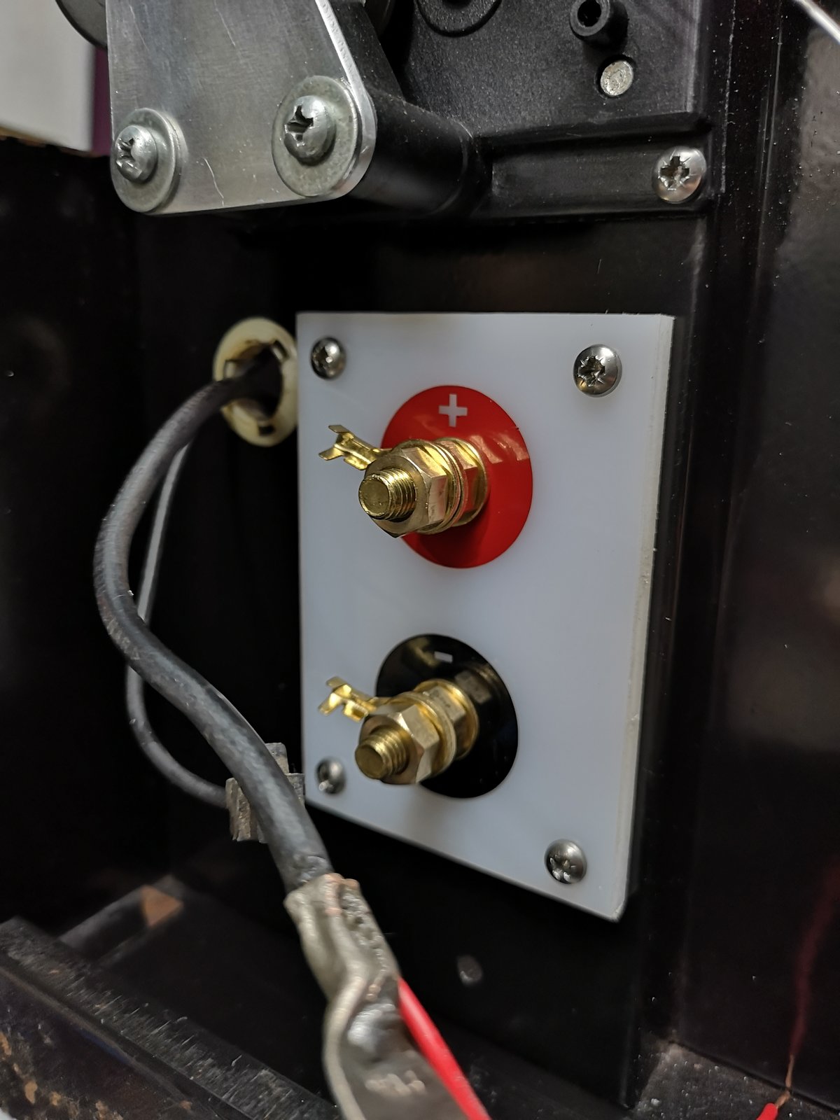

Also, the polarity I am assuming is set for shielding gas and plain wire, just how much of a difference does reversing it (like I'm reading you are meant to everywhere) make when using flux cored wire?
