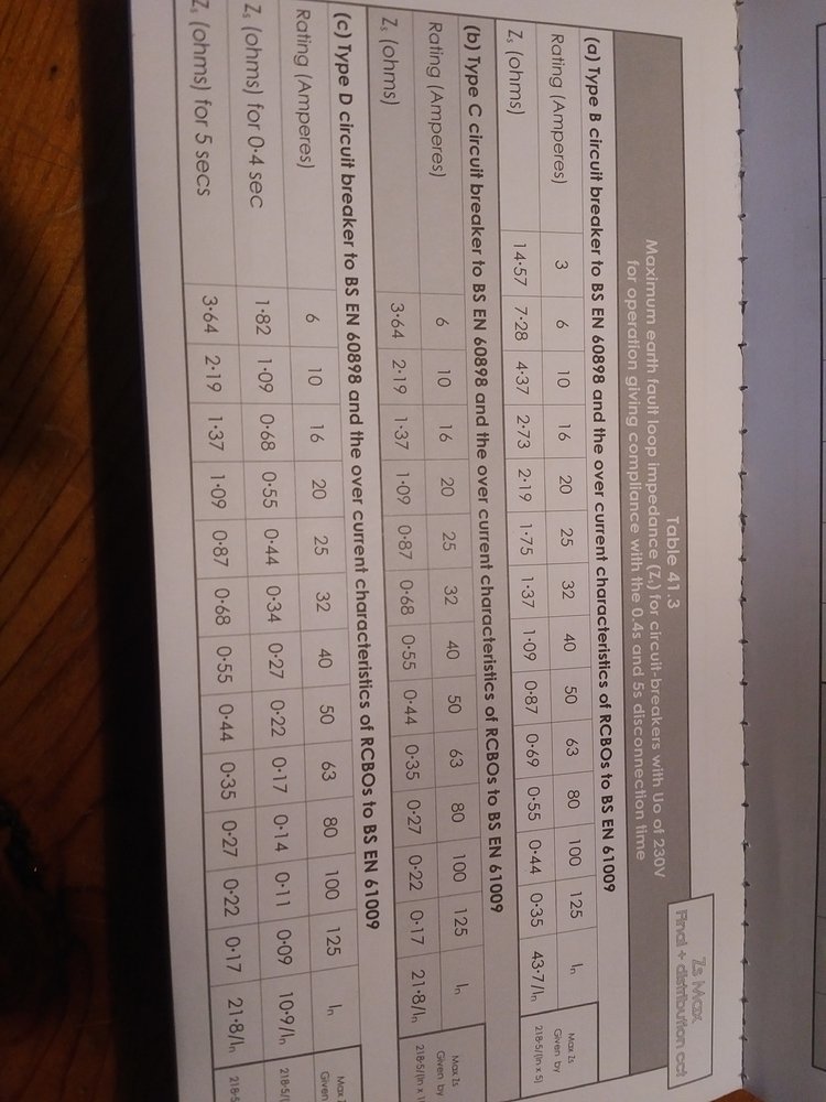

That’s really helpful, thank you.Max Zs for 50 amp MCB's in my 18.2 edition pocket guide is,
B type 0.73 ohms.
C type 0.36 ohms.
63 amp,
B type 0.58 ohms.
C type 0.29 ohms.
