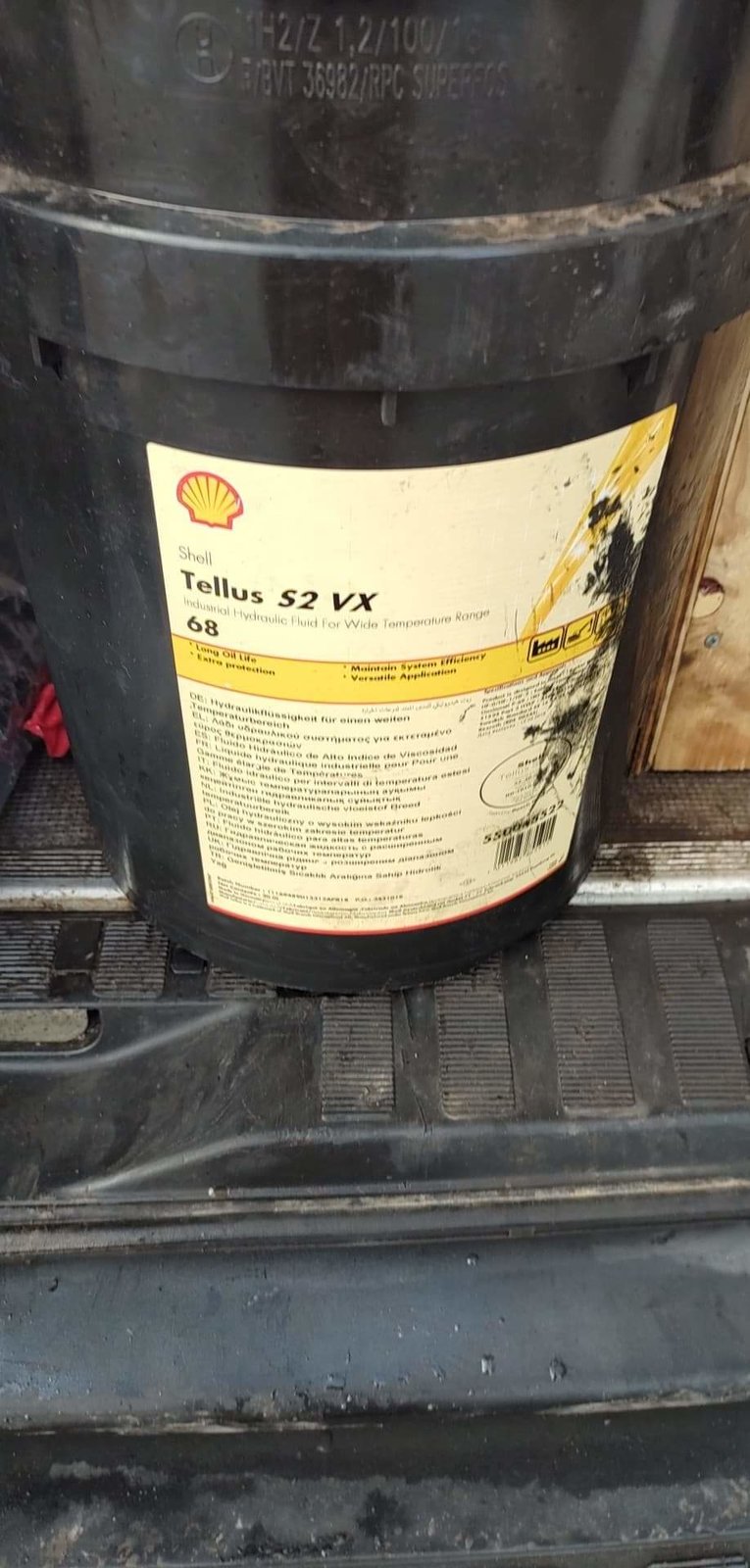

I was part of that thread and clean forgot. I guess my main concern is not lathe oil but my memory.The oil pictured is too thick, you’ll kill the oil pump, there’s some info here that will be useful:
https://www.mig-welding.co.uk/forum/threads/lathe-head-stock-oil.106239/page-2#post-1696527
So much conflicting info out there.The oil pictured is too thick, you’ll kill the oil pump, there’s some info here that will be useful:
This be ok then?https://www.ebay.co.uk/itm/Fanfaro-...-/303618515011?_trksid=p2349624.m46890.l49292I have one and use tellus 32 weight oil. Its hydraulic oil afaik.

I don't suppose I could buy some thinner oil and mix it together.
