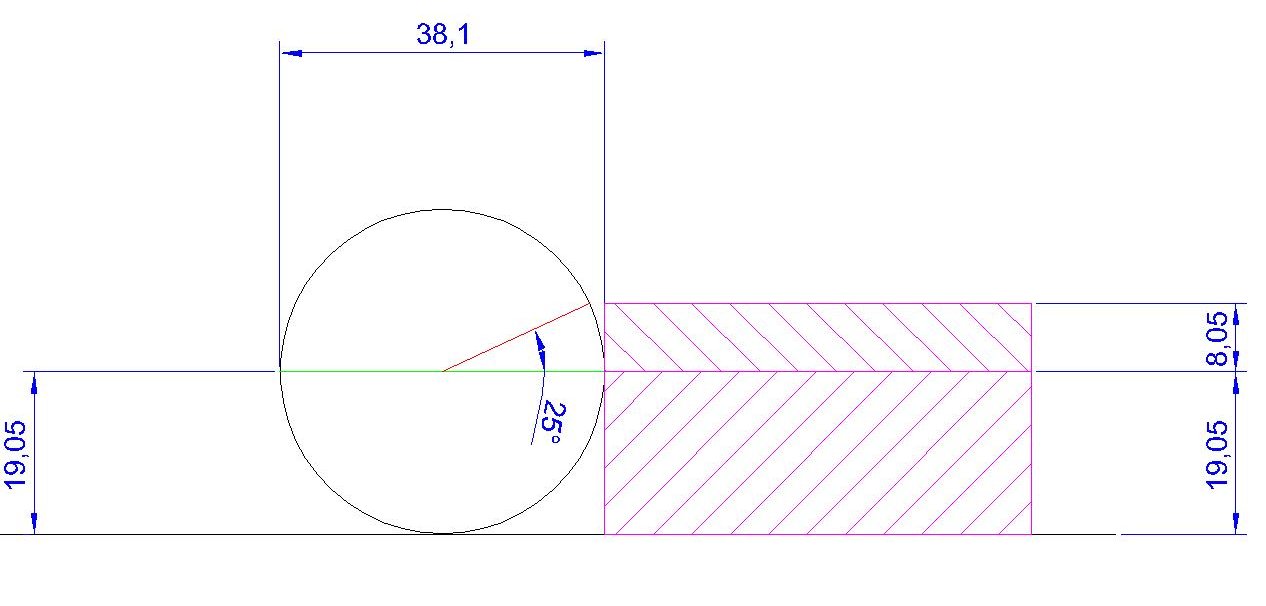

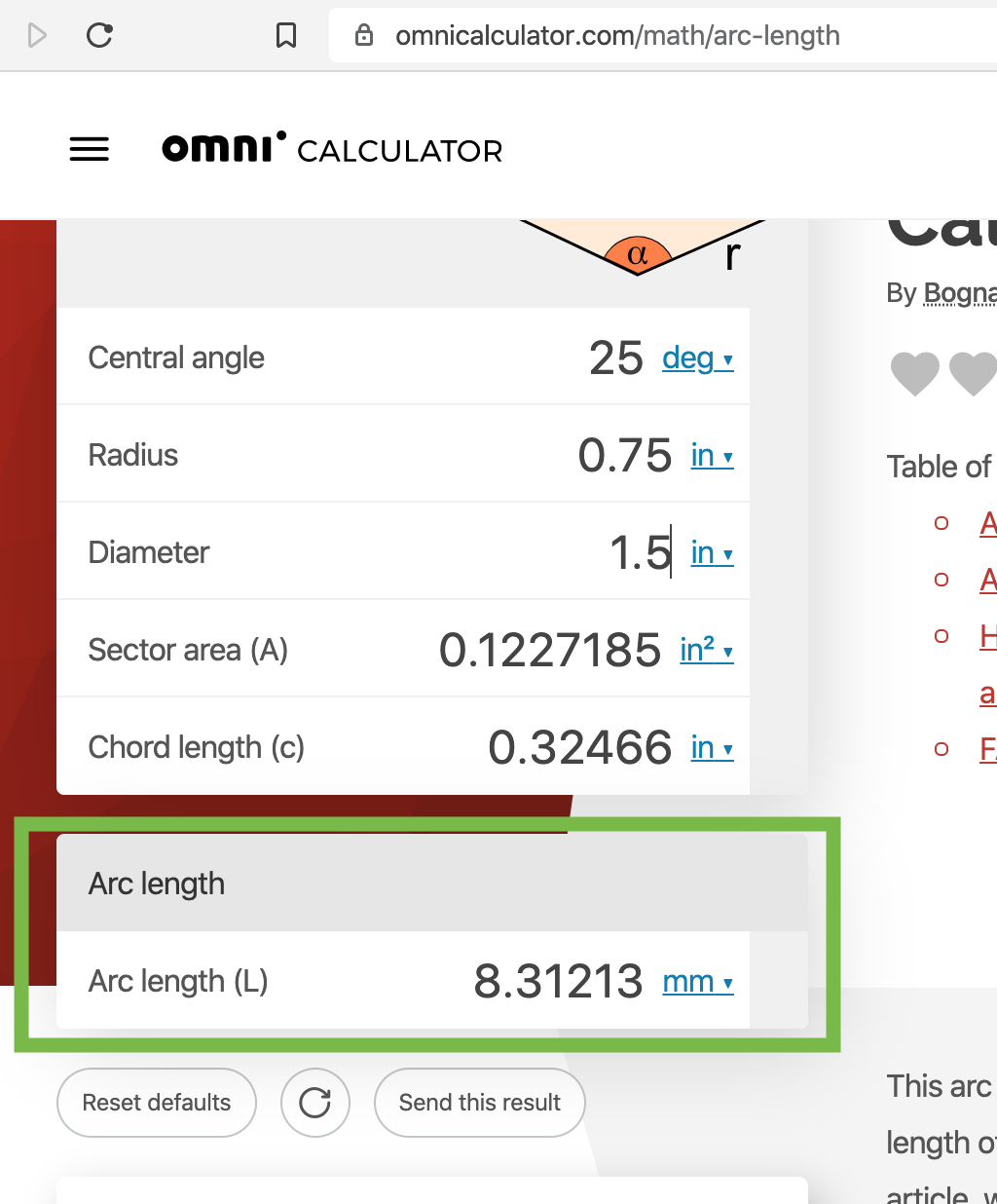

I have a 12 " piece of 1.5 " od tube and I need to mark out a lengthwise slot 25 degrees from a centre line how do I do it ?
Ideal would be a measurement I could make on the OD of the tube with a paper template.
Forget any calculations as I'm number illiterate.
