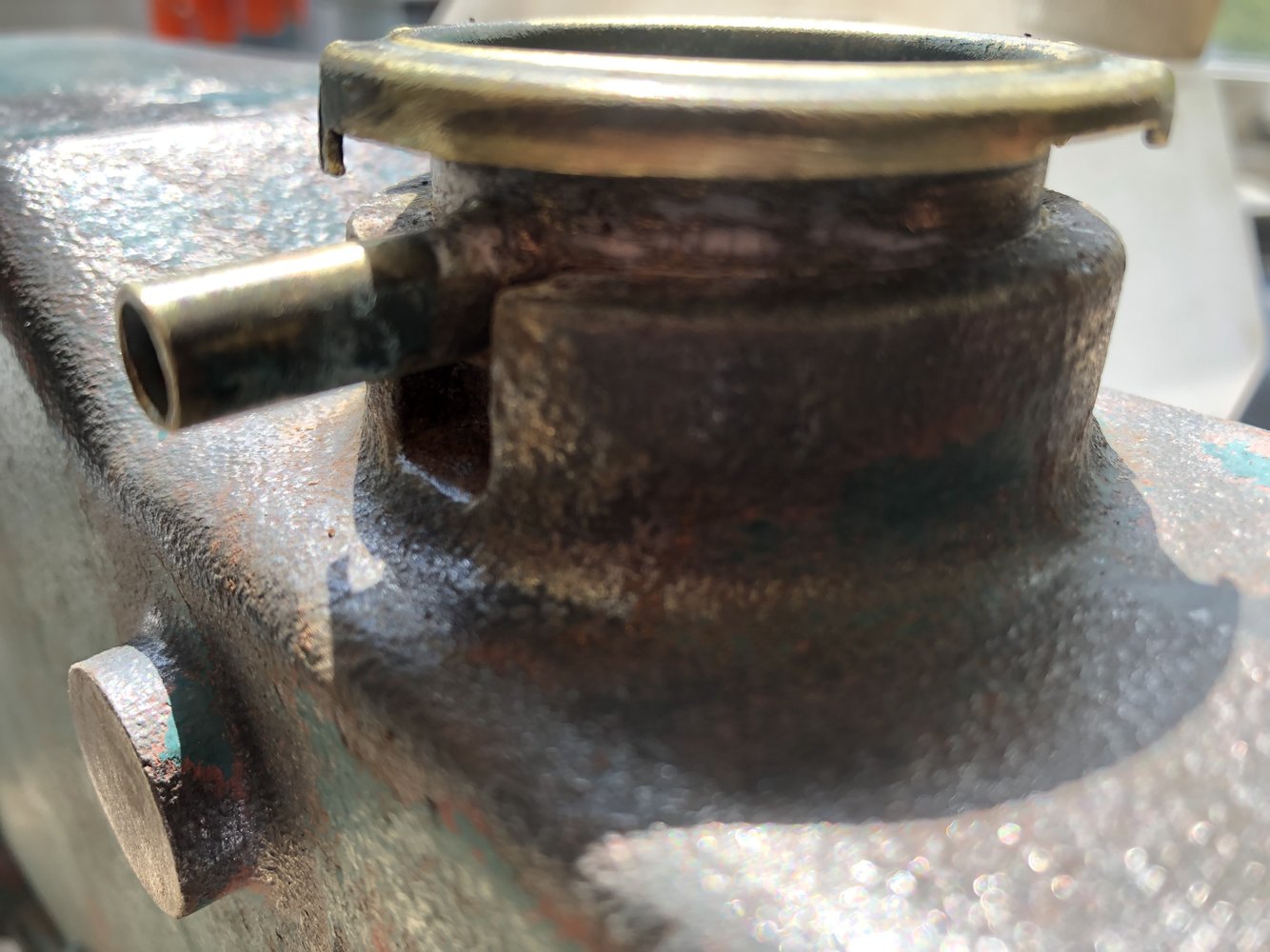

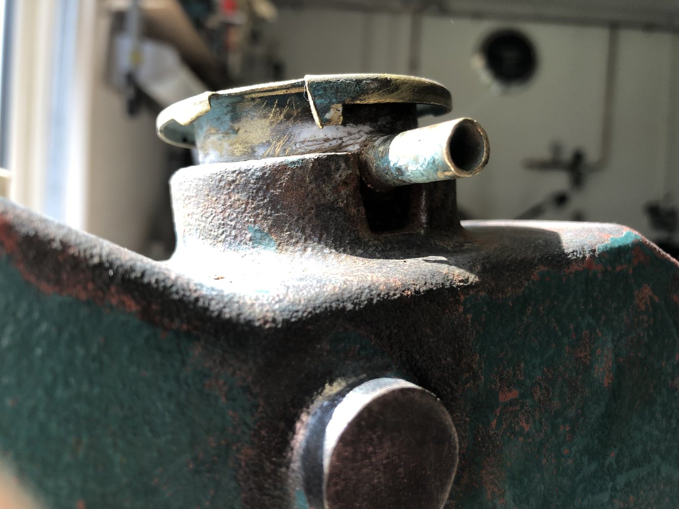

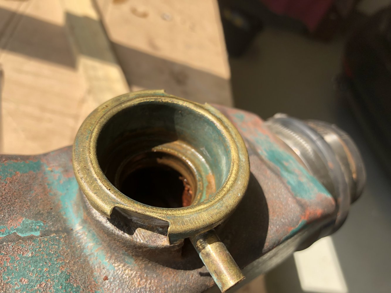

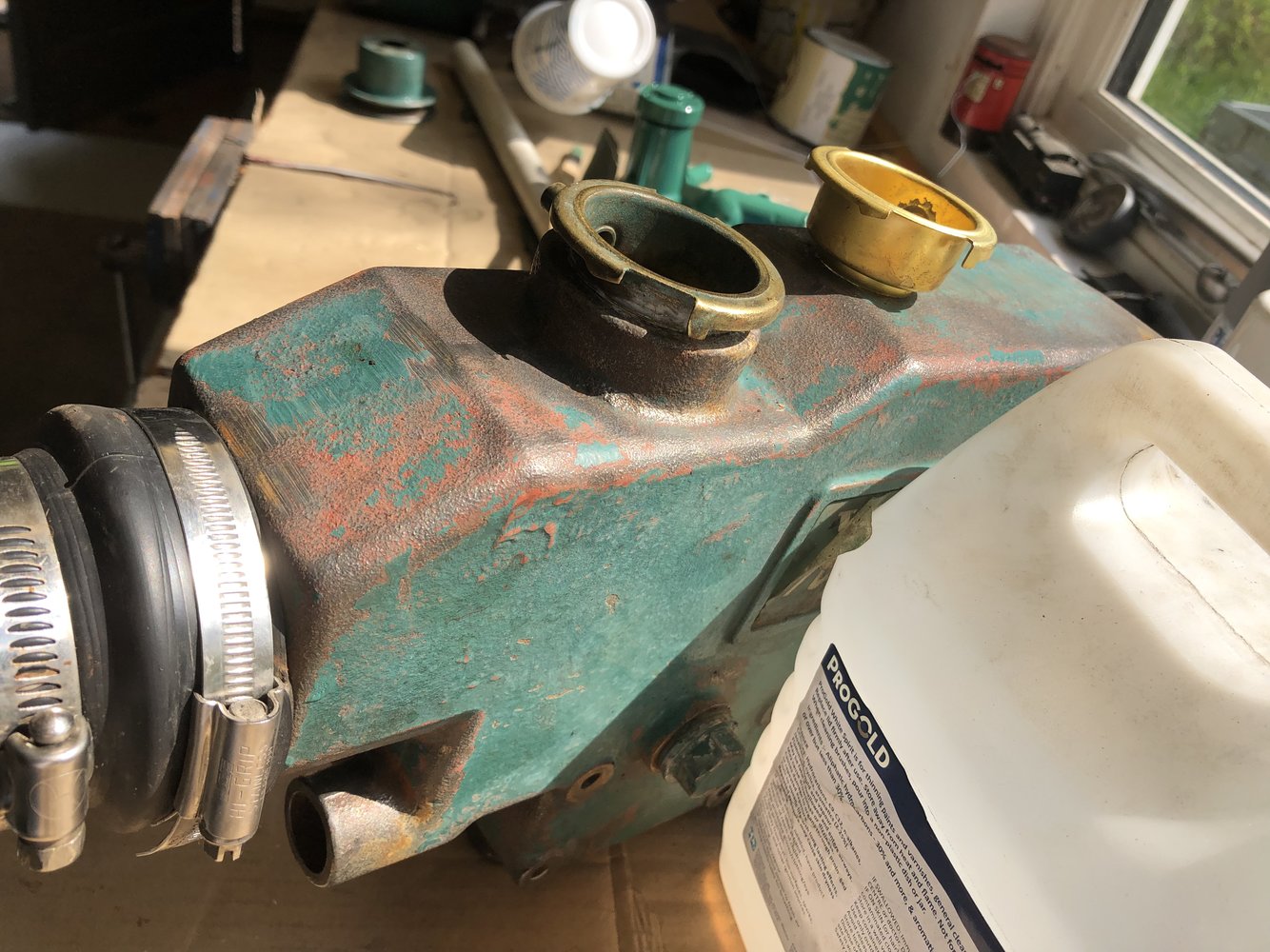

There’s a few types of JB Weld JT, does this looks like the one?JB Weld THE SLOW CURE ONE. The rapid one does not like heat. Same aplies to Araldite even the slow one is nowhere near as good as it used to be. I would definily advise slow cure JB Weld.. I know for sure it works with hot water.
