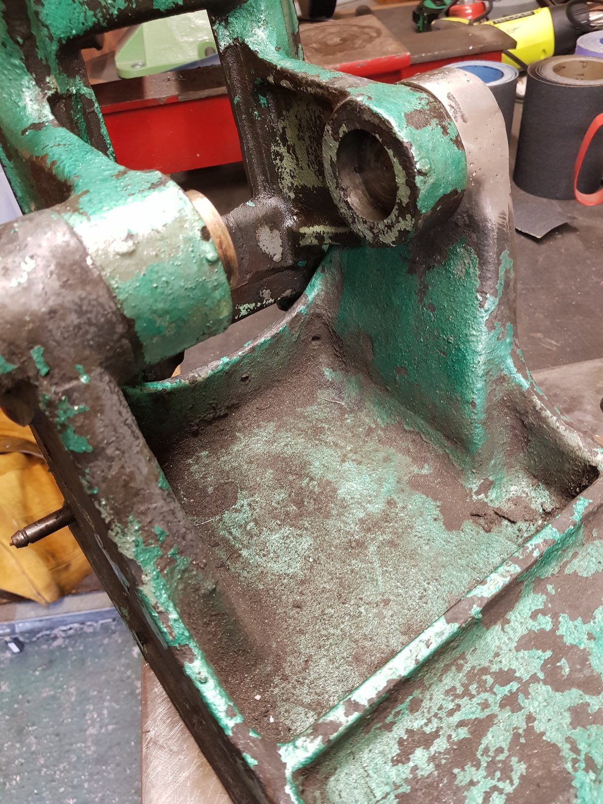

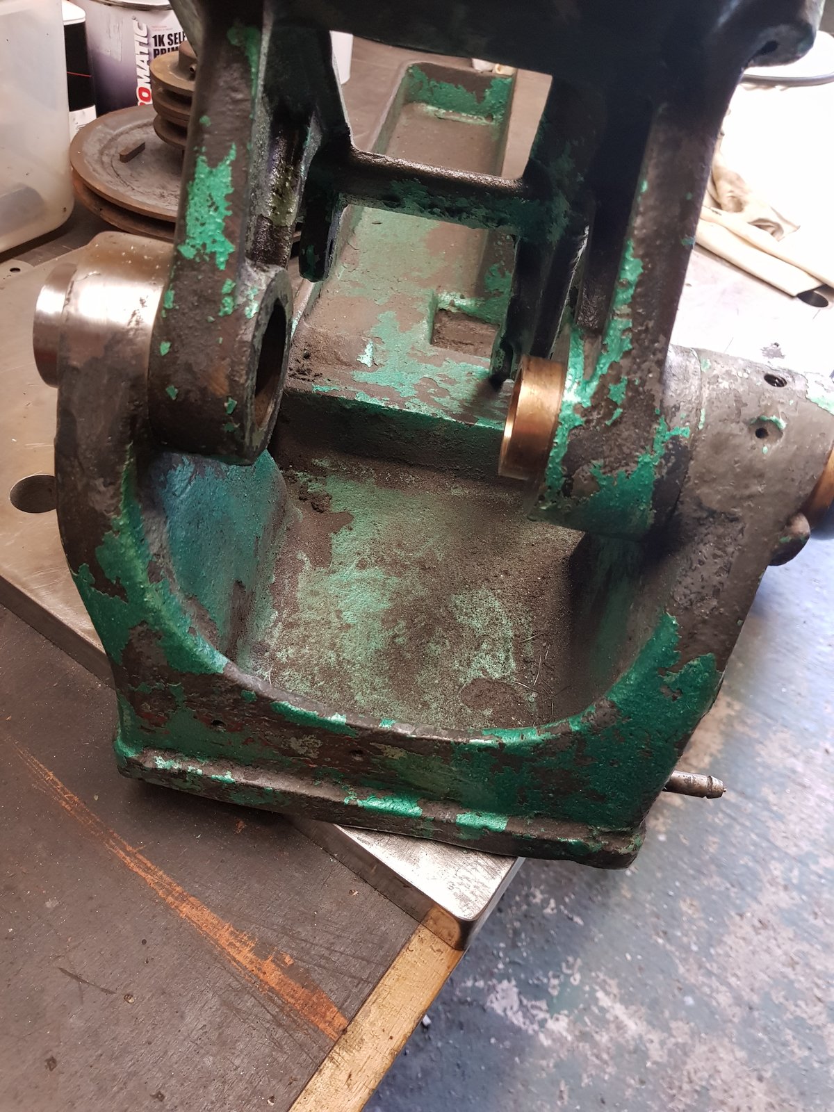

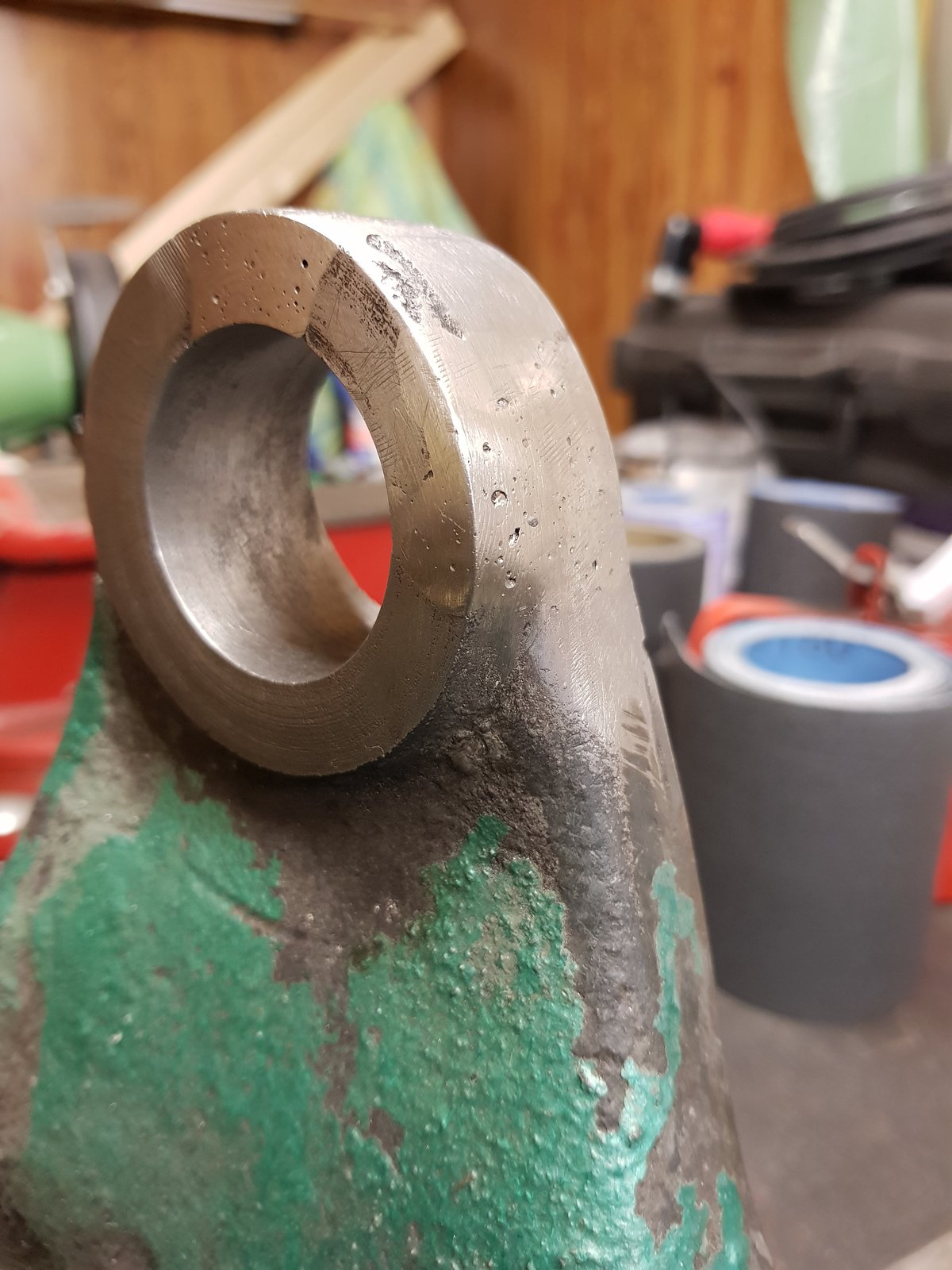

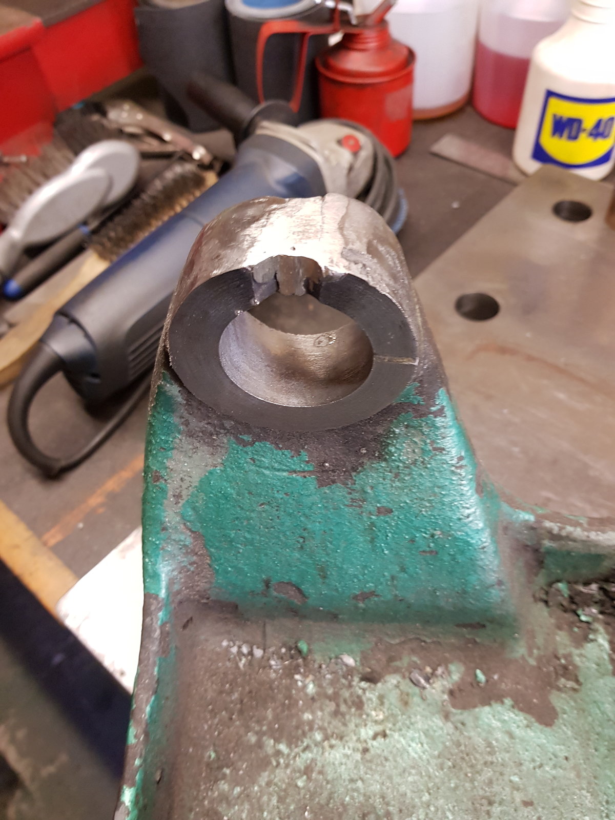

If it works leave it. You can always build up the area with automotive filler or JB Weld for a nice paint job.
Definitely. It's a good repair. It's in line ECT. So will probably do as you suggested with the JB weld just to finish off before paint ECT.If it works leave it. You can always build up the area with automotive filler or JB Weld for a nice paint job.

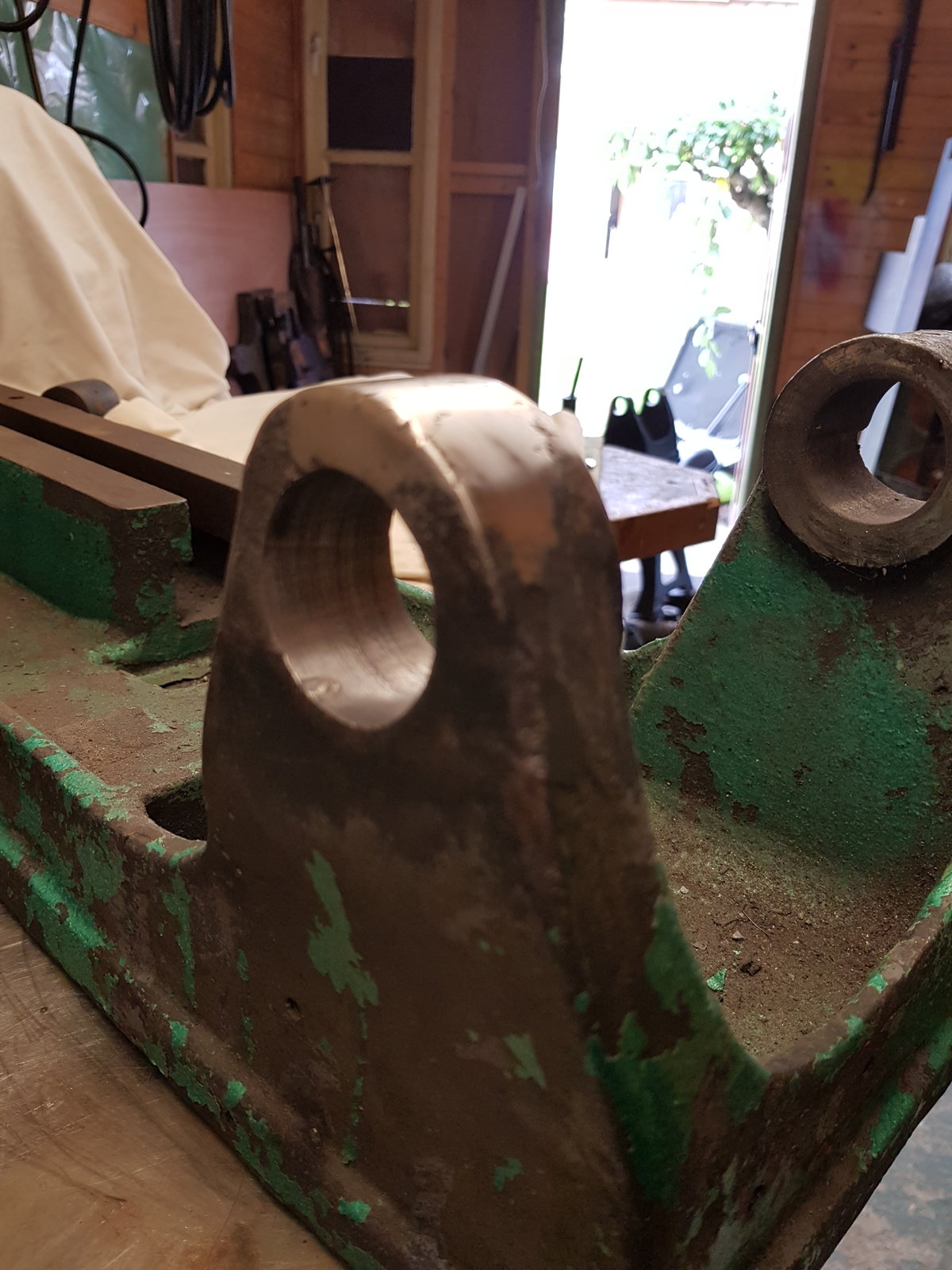

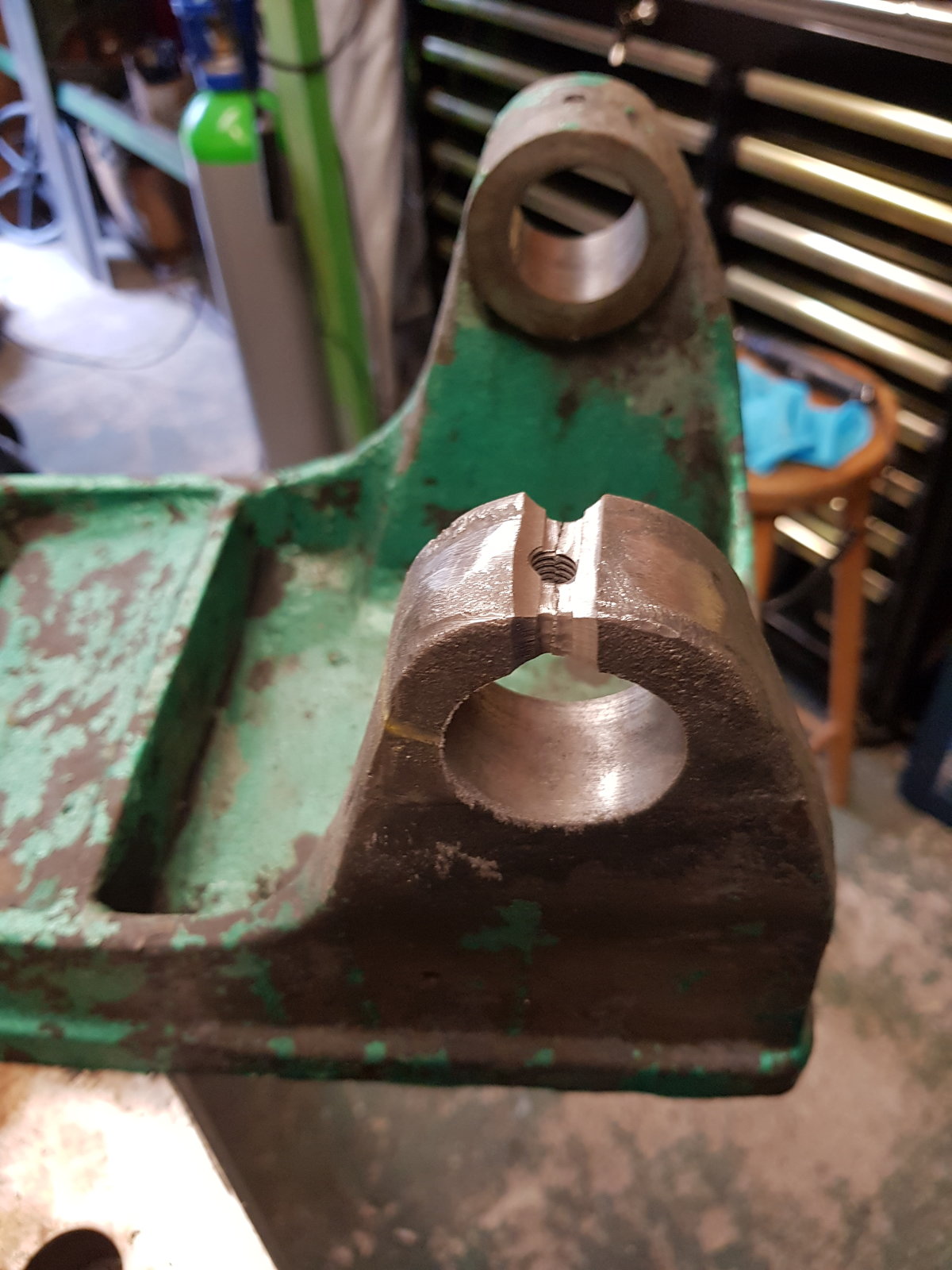

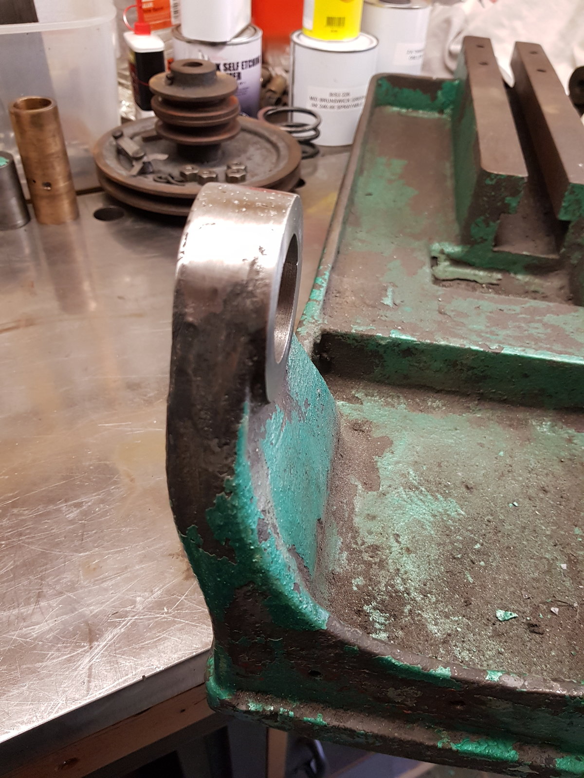

Yes.. I no the bit. It might be worth welding it now. Just in case it does eventually crack all the way.Mine has a crack / fracture on the top plate that the saw guides / rails slide in and out of - as id someone has over-tightened one of the corners in the past.
It works fine as-is, but im fearful that if it ever needs attention for another reason, it will finish cracking then.
This isnt my photo, but the bit that the light is shining on -
(has a circular hole in the middle)
Im running with the "if it aint broke...." concept at present!

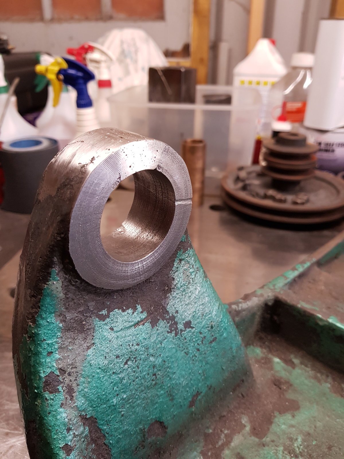

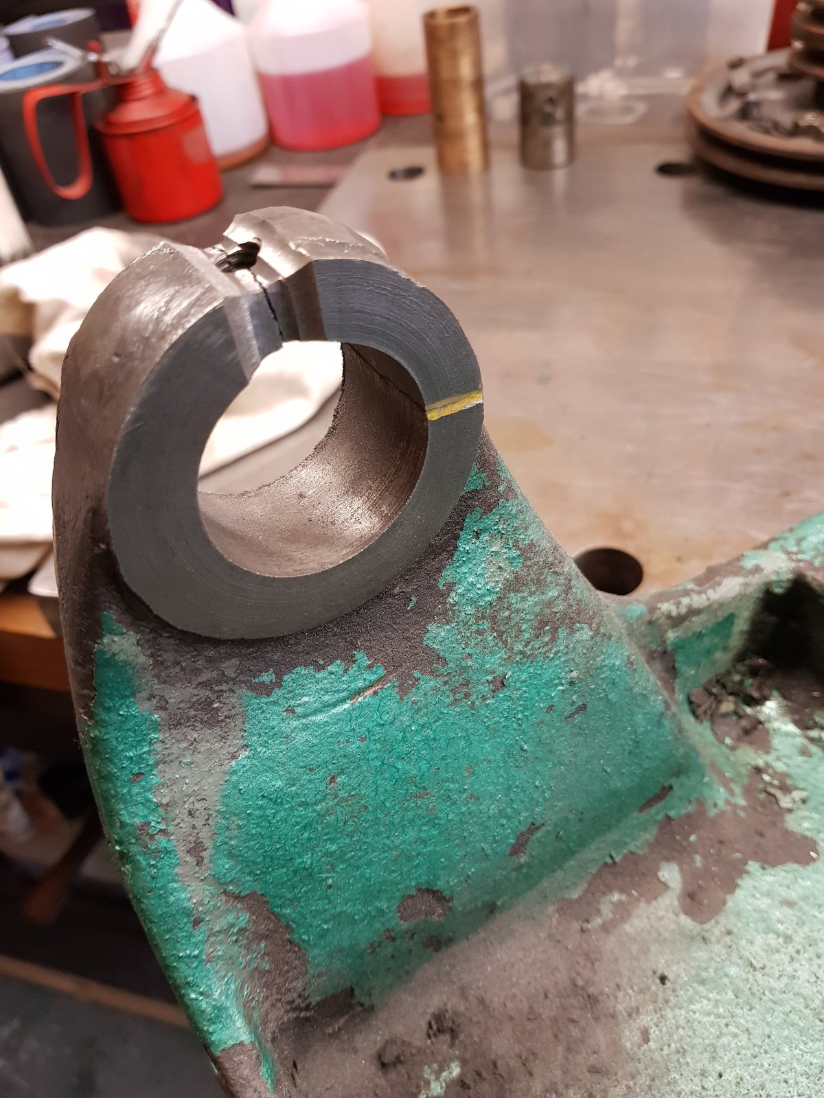

Yes. Angle grinders are good. But after a while it kind of gets to p ya off. Nearly done welding mine and then I can get it cleaned and in primer..I've used mine in anger for the first time this afternoon. I think every single bush in it is shot, but it still cuts nice and straight. Needed a bit of a shove occasionally to keep it moving but It's not been used for a while, and once the oil got into it things improved. Why have I been messing about cutting stuff with an angle grinder all this time?![]()
That's what I looking forward to get the saw done. Stick metal in. Let it do it's thing while I go and brew up.You can't make a cup of tea in the time it takes to cut through 3"bar using an angle grinder!

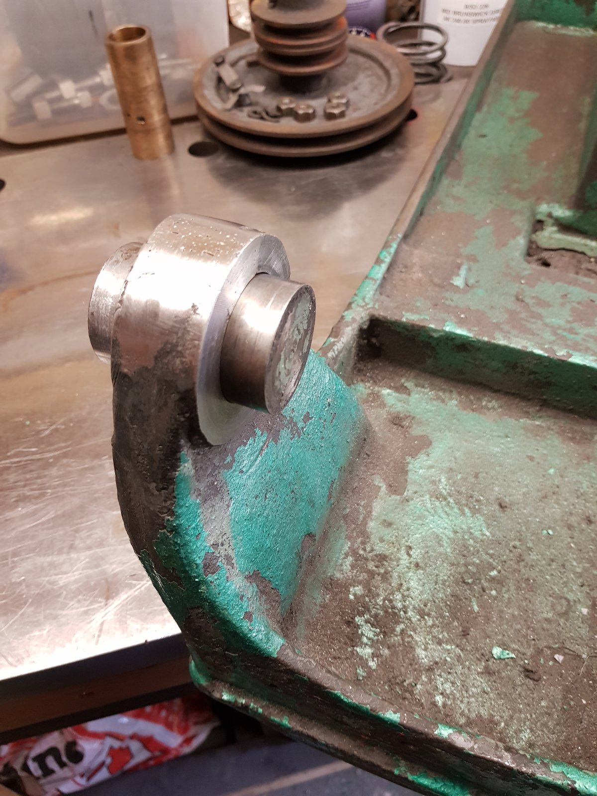

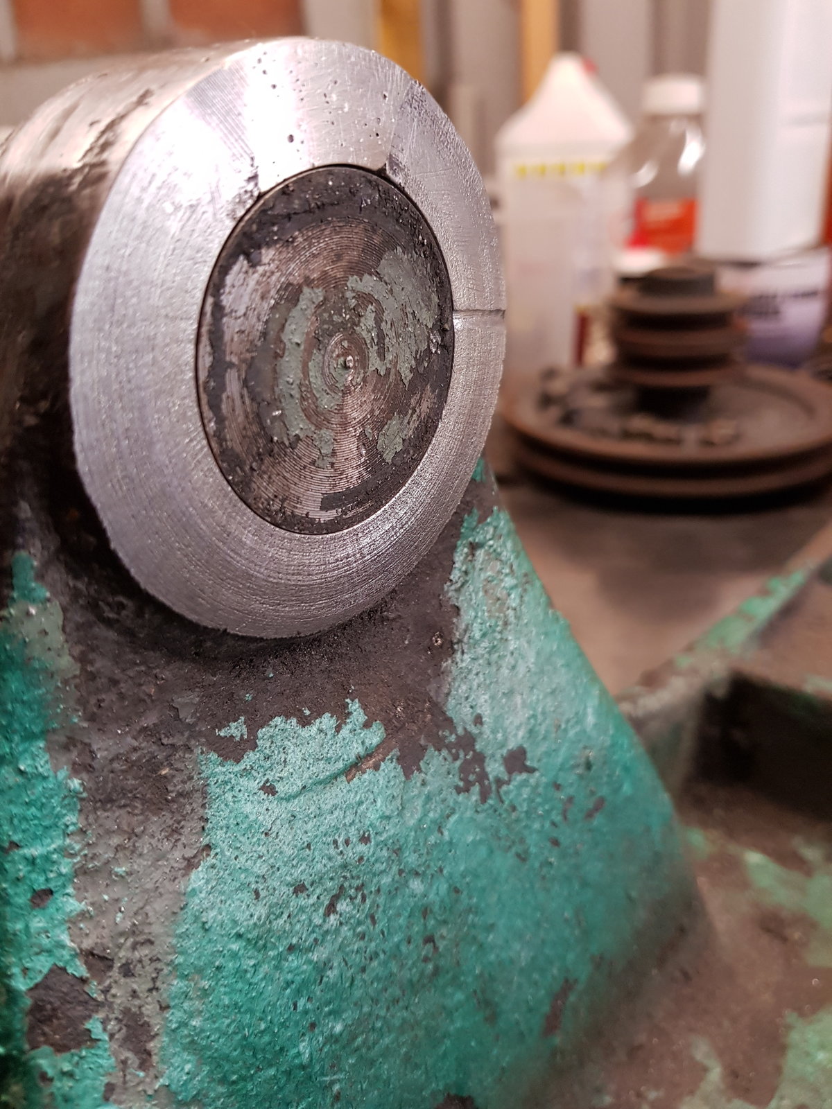

Yes. That's next on the list.Are you going to replace the oil well/hole and drill/tap a new hole?
Nice work. Very satisfying to see a big old machinery put back into service.
