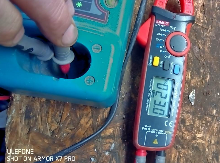

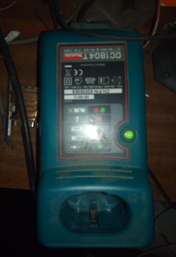

know we have a good few makita owners on here, so thought I'd ask a wee bit of a service. Customer brought in a 14.4V makita drill, (model 6281D) with 2 dead batteries not holding charge, or even running after coming off the charger...
Realise it's not really a realistic / economic repair, but she wants to try as it's hardly been used, so spent a few minutes on it. Battery charger is my cause for concern, it's putting out 23V on charge. I tried charging a battery to see, and the 14.4V batteries are rising to 18.5V off load. The voltage decays quicky, but then seems stable around 14v, so maybe more an over charging issue, they may already be cooked, but who knows. They're little used, spotlessly clean, agreed that doesn't necessarily mean anything..
I would have expected around 15-16V for charging, but certainly not 23V, but before I definitely condemm the charger as quilty, could someone with the same charger throw a multimeter on it to see what the output voltage is?

scrap... will speak to her on monday, but looking like it's for the recycle bin.... had a quick look for batteries and charger costs, even knock off's it's just not worth the bother.. for the same money, she can get a mid range 18v cheapy with 2 batteries, and 2 years guarantee....best option especially if it's for the same use this one has had.
