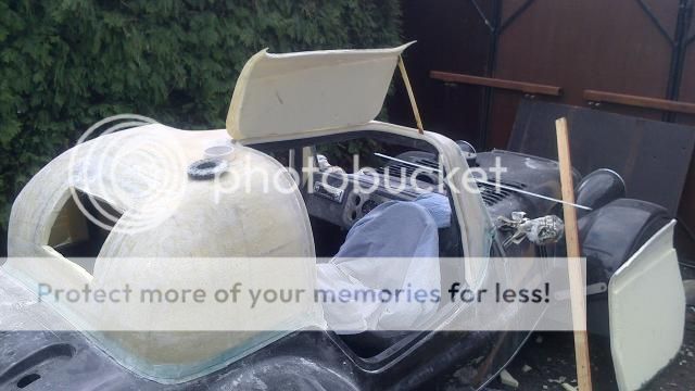

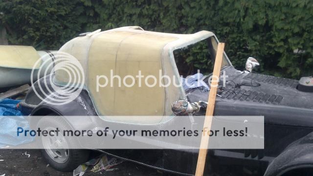

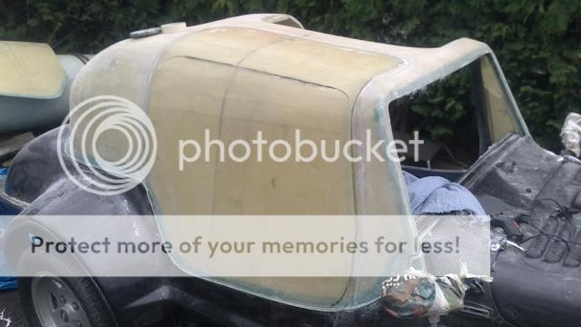

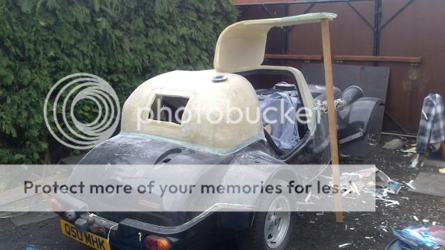

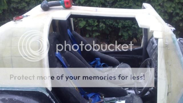

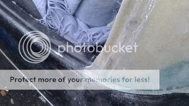

Are you going to lay up the fibreglass directly on the foam and then when set remove it and break the foam out?i see a bucket of filler being got after the first laminate.
Or are you looking at making a Plug?
If you are doing the first option, you should be able to get a good finish.
Buy yourself a finned roller to get the matt nice and flat and then finish off with a Tissue.
It's difficult to use if you are new to GRP but the end result will need minimal sanding and filler
