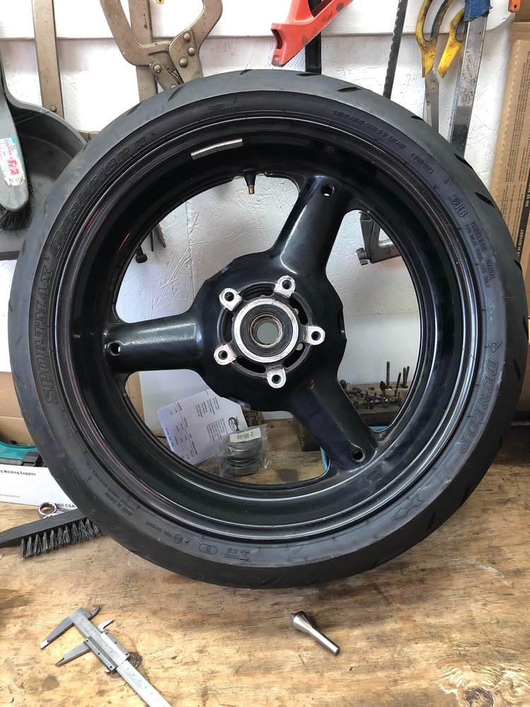

If you use a rear wheel on the front your going to have a big cush drive space on one side where the sprocket goes.

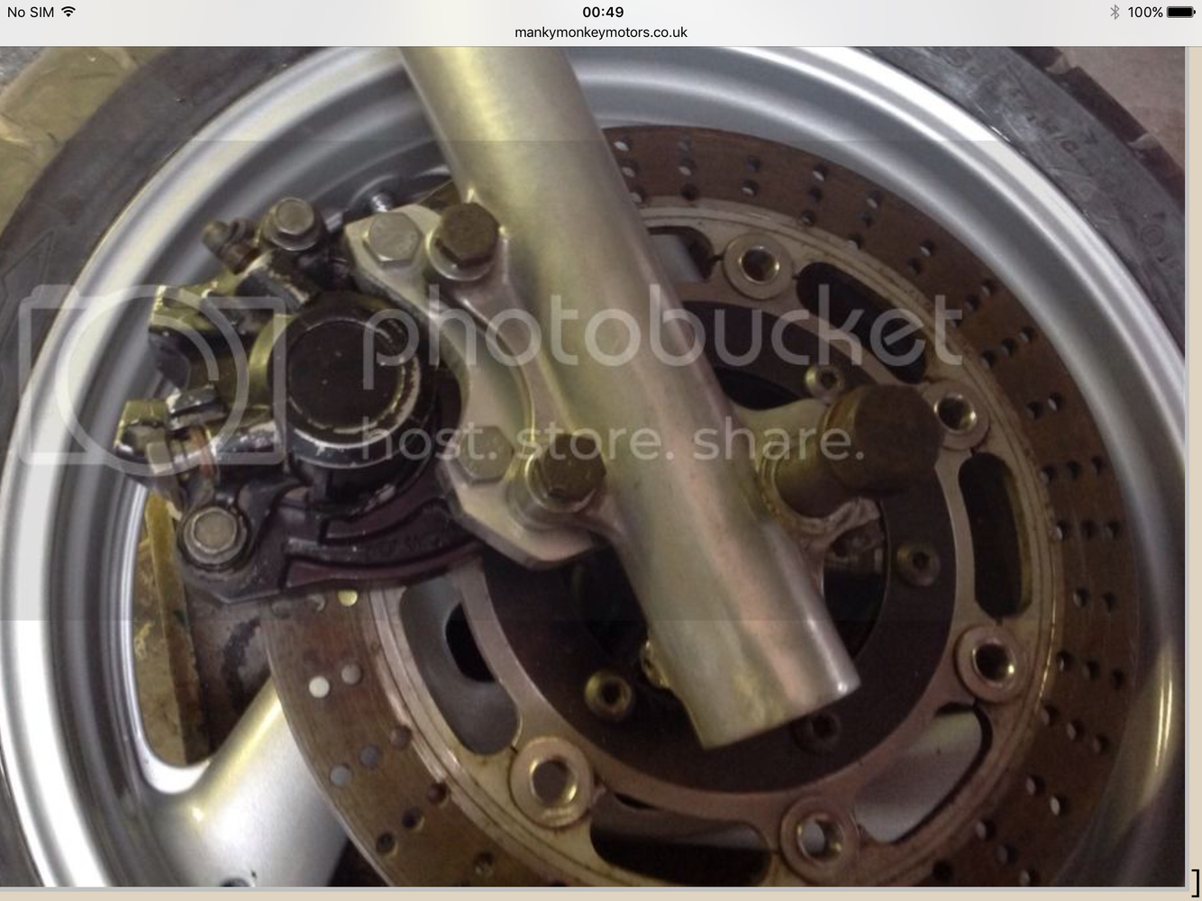

I don't have the disc, but ebay shows them being about 8" diameter......Maybe just try the stock disc and some decent high-torque pads first, I usually go with Ferodo ST's on the bikes, work well everywhere.

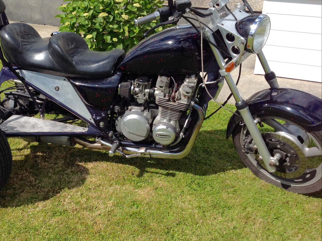

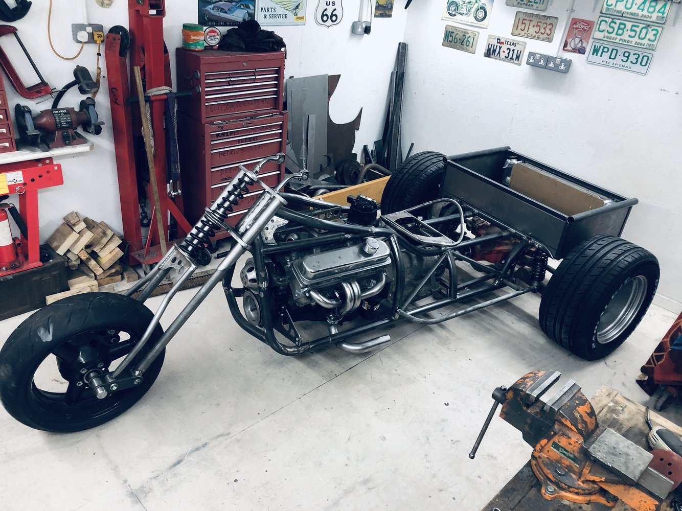

When I had the same problem with my 750 trike, I used a vn 1500 (fully floating) front disk outer mated to a self made inner that mated up to the wheel bolt pcd. I made new stainless rivets, used the original sprung washers. The original calliper was re spaced using a lump of alli machined to fit.I'm pondering how to get decent brakes on the front wheel of my trike project. I bought a Hayabusa rear wheel. which is good and meaty, takes a big tyre, unfortunately it has a single small disc. I've browsed around trying to find something far bigger with no luck, but today I noticed the brake discs on some Triumph in my mates bike shops were just flat sheet, cut to shape, ground flat. No offset, no carrier etc.
So, could I get one made simply enough, maybe laser cut from 6mm steel, or maybe stainless? Would it work? Would it need heat treating or anything else?
I can make my own floating caliper bracket, and have the disc as big a diameter as I need it.
Don’t listen, you absolutely need a front brake that works 100%.More than a few people on trike groups have said that the front brakes don't really get a lot of use on a big trike, however, but MSVA dictates the braking effect required is based on the weight on the front wheel.
I'm putting as much weight as I can aftwards, radiator, fuel tank, battery etc, behind the axle, to keep the front end as (relatively) light as I can.
Ahem....Don’t listen, you absolutely need a front brake that works 100%.
Edit to add, you'll only be able to fit one disc, so it needs to be as big as poss.
And your front wheel will be lighter than the 750 motorbike engined trike pictured?Ahem....
"but MSVA dictates the braking effect required is based on the weight on the front wheel"
