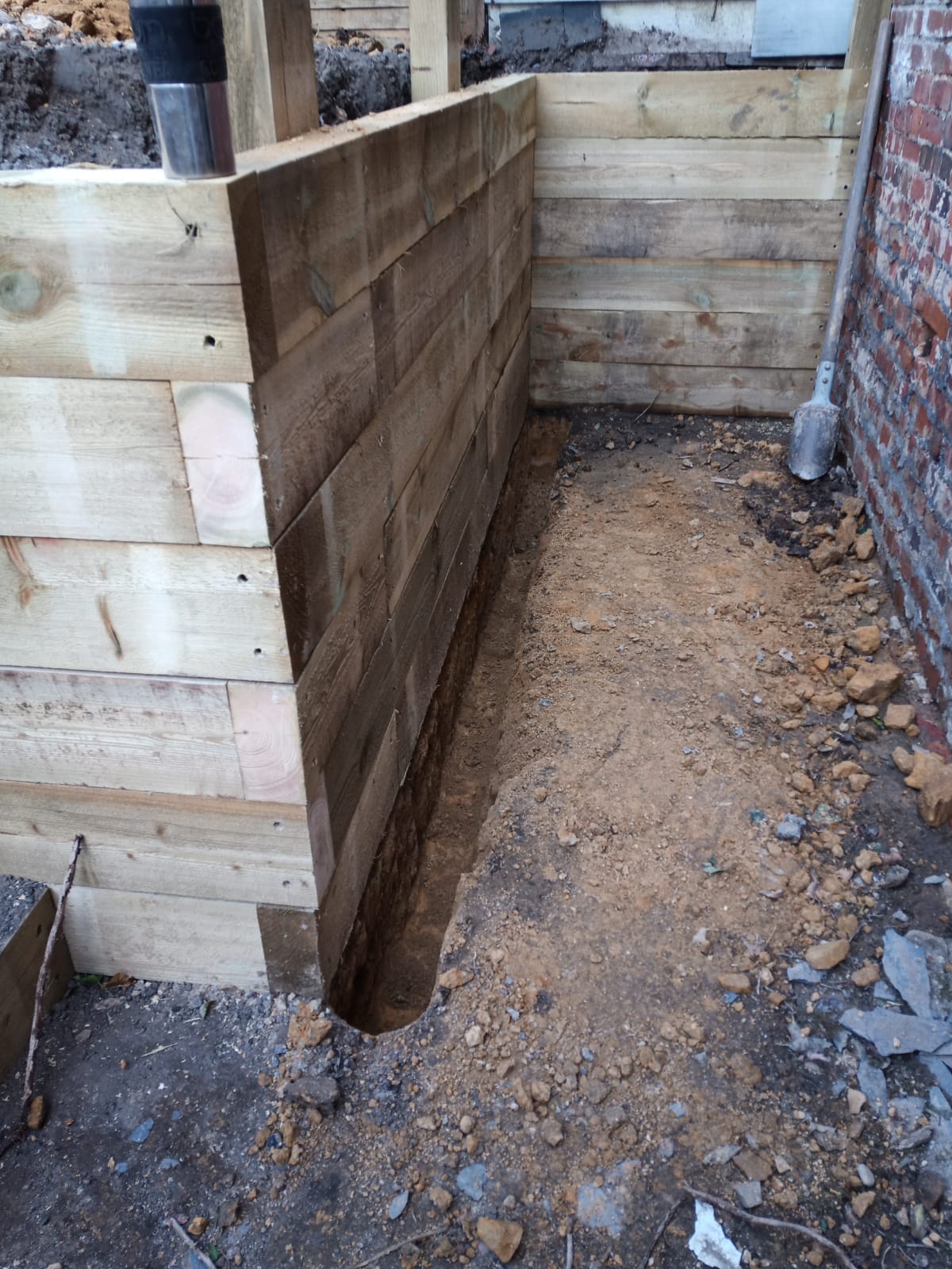

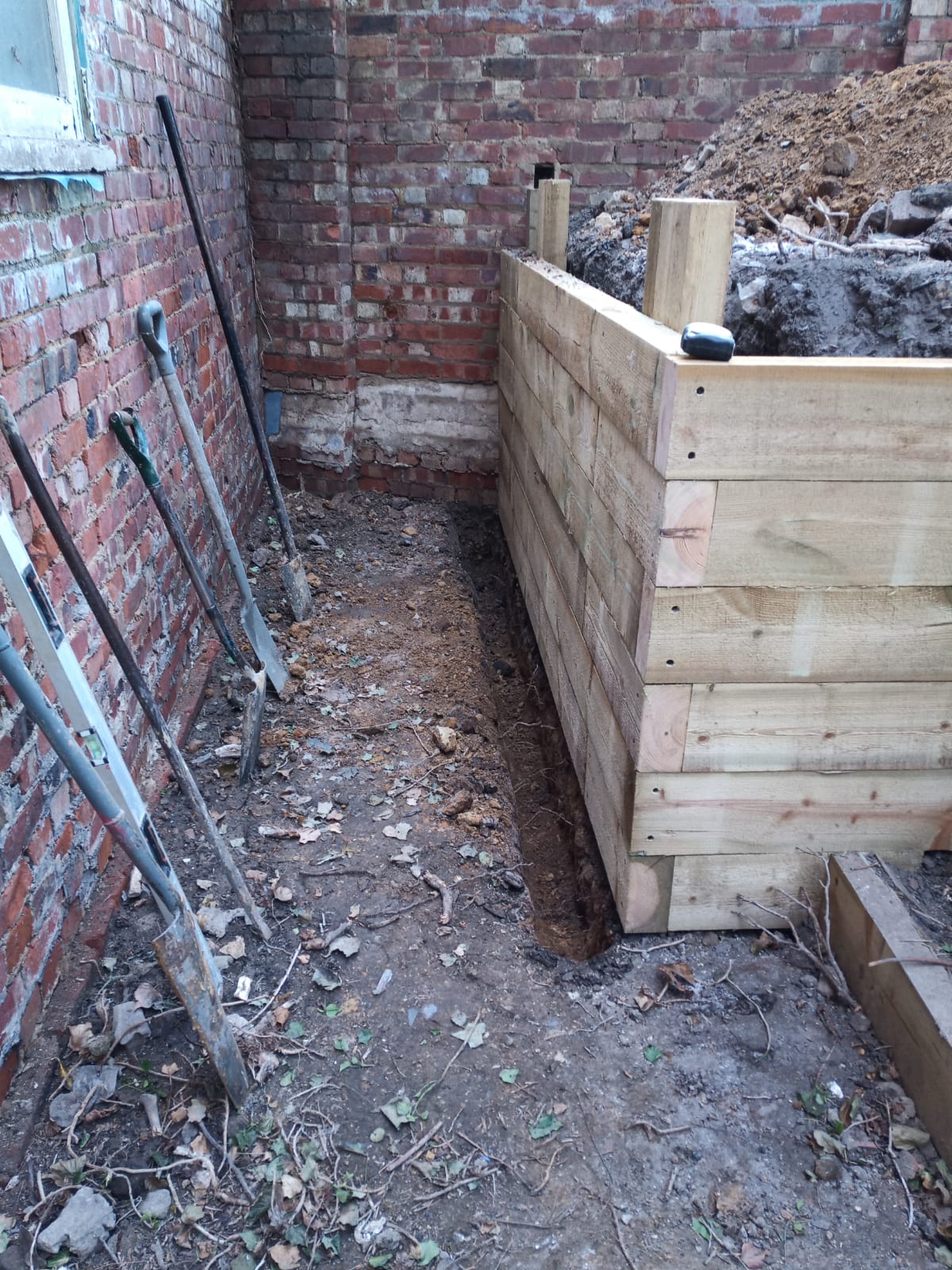

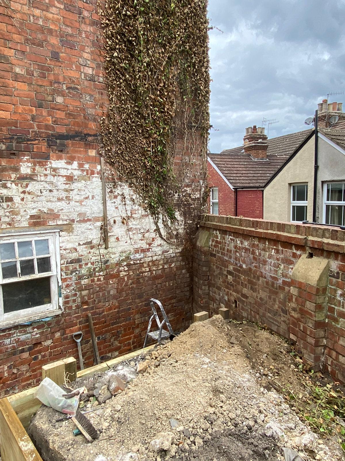

    Hi guys,
    so I need to make a balustrade for a garden retaining wall at a property I own. I want to make it out of 30mm box section and expanded steel. it will be rectangular with 2 feet (atleast) either end and possibly one in the middle. My question is how long can 30mm box section run before it gets unstable? I need the balustrade to be 30mm as its in front of a set of windows and need to keep the balustrade lined up with the window mullions which are also 30mm so it looks good and light isn't blocked out too much. The entire run will be 3m. In an ideal world the 30mm box would run the entire length with no supports in the middle but this may be unrealistic. Any help would be amazing?
    Thanks guys.

  8. shorter_alexander Member
    Messages:
    35
    Location:
    Tunbridge wells
    thanks guys, I was going to put a small bit of angle under the box sections to fit the expamet on to. ill to put-up some picture of the space when I go there later.

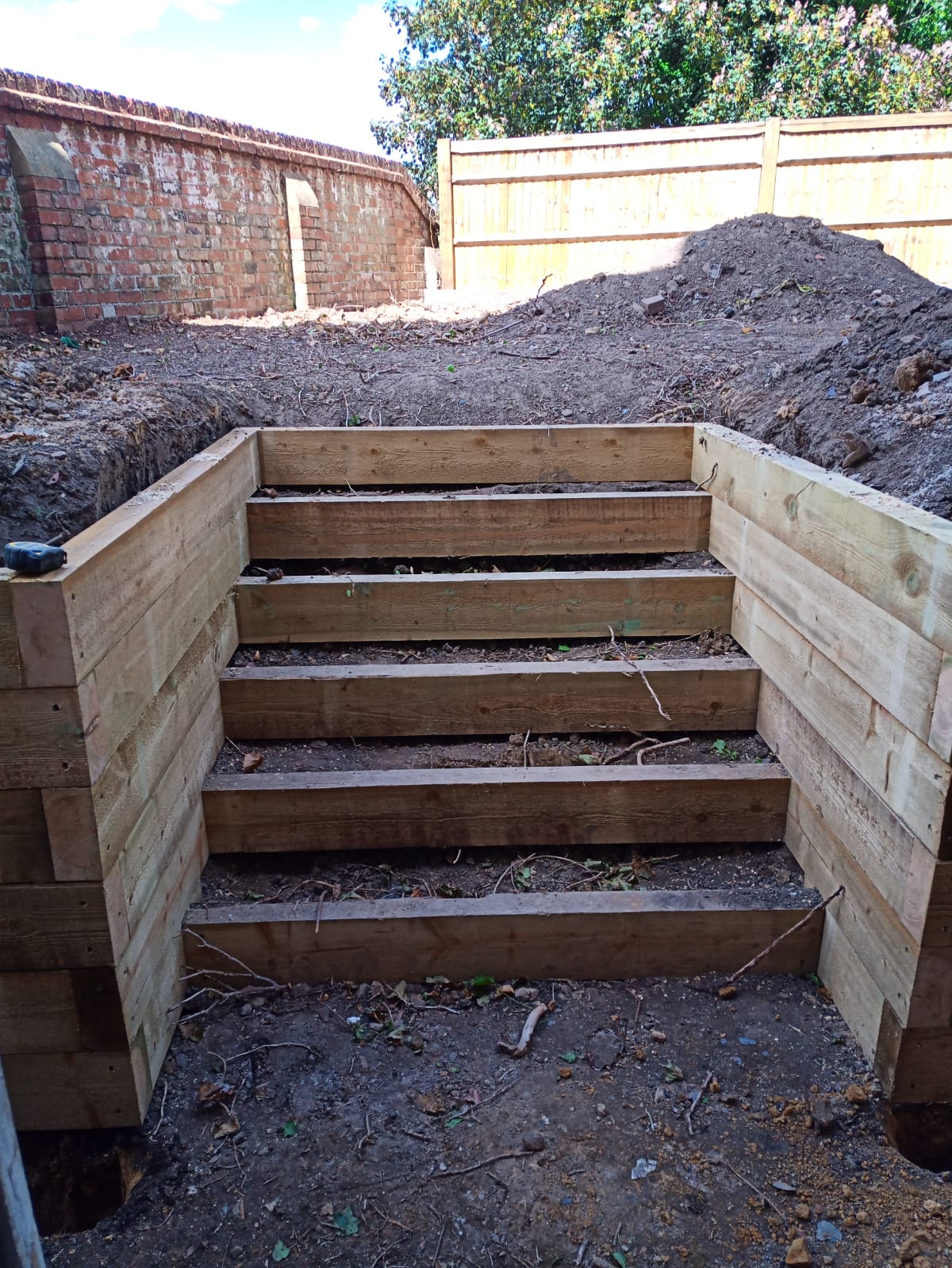

  9. shorter_alexander Member
    Messages:
    35
    Location:
    Tunbridge wells
    The space is like this. I’m just going to get the bits to do one bit first and see if I like it and then build the rest if I do!

  10. Revs1972
    Revs1972 Forum Supporter
    Messages:
    1,449
    Location:
    Torquay, UK
    Balustrade vertical post positions vary depending on the materials used. With what you are proposing, I would be thinking a max span between posts centres of 1 metre.
    Some of those expanded sections can be a bit sharp too, if it were me doing it, I would probably get it galvanised and powdercoated.
    Are you planning on fixing to the side or the top of the timbers ?
