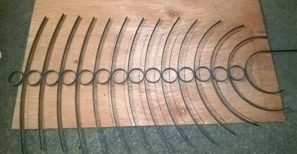

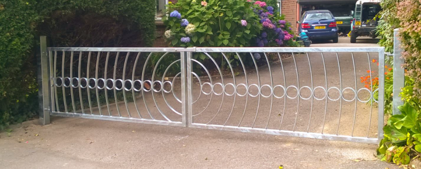

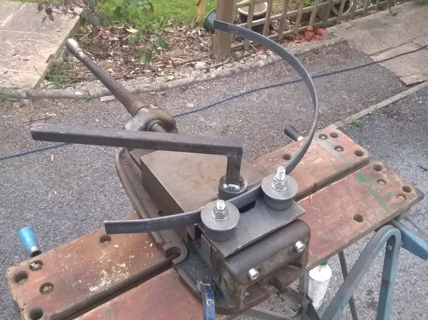

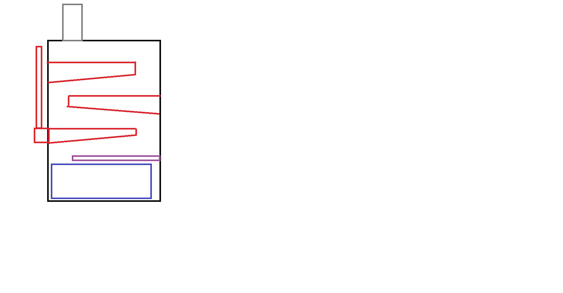

Nice ! You calculated the concentric radius's perfectly.When I made my gates I made an improvised roller using the vice from my milling machine. To roll tube just make sure the rollers have a suitable radius in them.

Thanks. Templates help. Old school methodsNice ! You calculated the concentric radius's perfectly.![]()

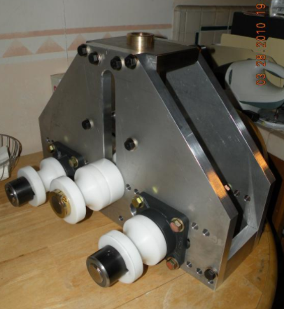

That’s proper jobI would have thought a tube roller would be the best tool to create a coil.
Easy (even easier with thick walled underground copper). Dry some ordinary sand in an electric oven, fill the pipe, wang some wooden plugs in each end, then heat with a blowlamp and bend round a former. In my case a small tree.
This is how I made a coil to fit in my Dickenson diesel heater, worked perfectly.

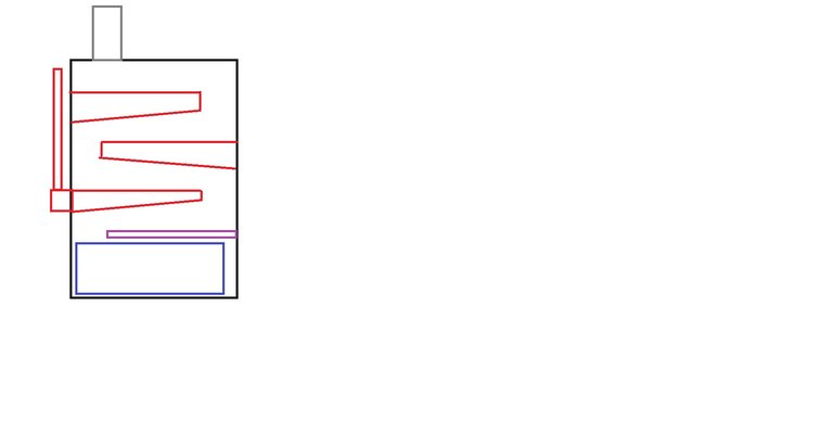

I've never tried it but would a variable speed pump work. Slow speed for hot and fast for cool?So, hot tub boilers; what's the consensus regarding a control system?
I.e, my thoughts are that to burn anywhere near efficiently, the fire needs to be hot enough. So overcooling with too good an exchanger is not good. Equally, too ineffective an exchanger and too much heat will be lost to the world. It's less of an issue in an indoor backboiler as the non transferred heat has chance to heat the home.
So are there sensible solutions to this without additional lots of complexity undesirable for a hot tub? Or is accepting smuggy burns or lots of lost heat par for the course?
Post #31buy a heating coil for a karcher steam pressure washer steel multi pass coil be ideal
