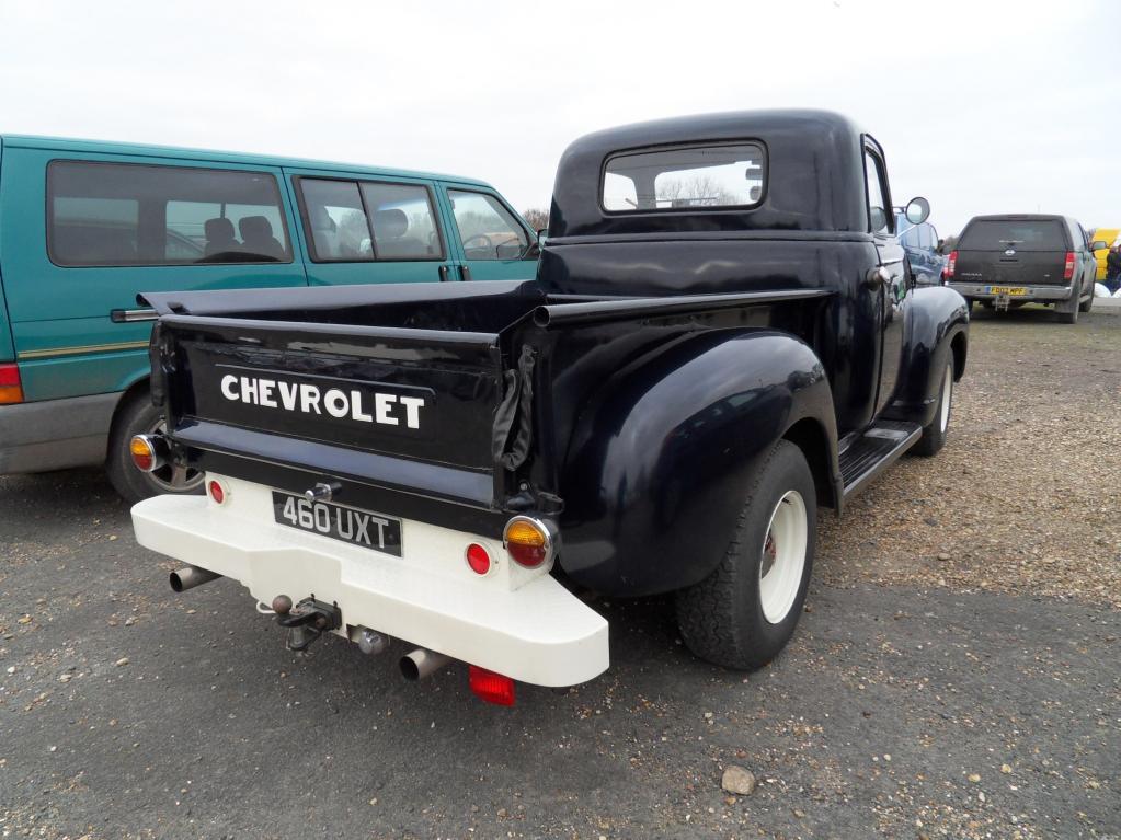

Some interesting information in this thread. Had no idea that having a trailer come away was anything other than a super rare occurrence. I always refer to the USA made towbar setup on my truck as "the full hillbilly" it's mostly made of 1/4" and 3/8" plate, I had to use a couple of jacks to lift it up into position after blasting and repainting it. I occasionally tow a loaded car transporter trailer on this setup, The jacking up the rear on the jockey wheel hitch test sounds like a good idea.
