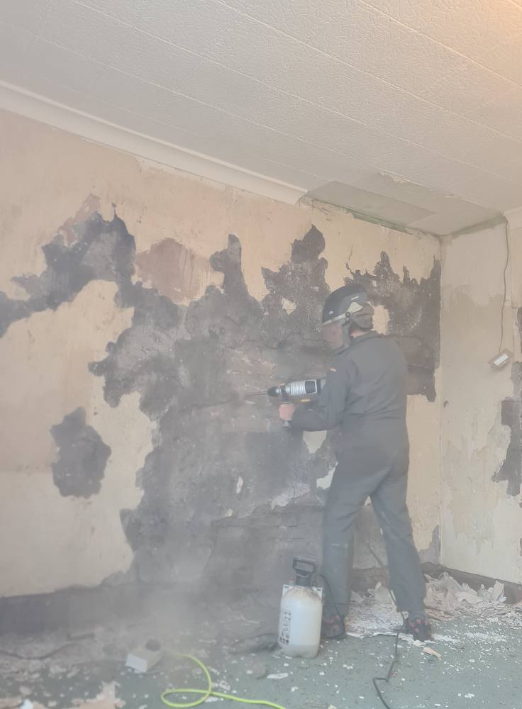

I started refurbing my bedroom a few days ago.
oh joy in a 160+ year old house. Plan A. strip wallpaper, get plasterer in and then level the floor.
we stripped the wallpaper off one wall. Plaster looked a bit desperateThe plasterer said get it all off.
hideous job about an inch of black ash plaster and lord knows hat. Luckily I drove into work to get my airfed dust mask.
And bought a biG SDS drill
A few moments later
ive never seen anything like this before but had no dust issues with my dodgy lungs.
Trend helmet pricey but just justified itself again
The first wall came off in crumbs the second we left the bullet proof wallpaper on and it came off in twenty minutes in slabs
Lesson learned. Third wall was fine. Fourth wall probably holds the house up with fitted cupboards and is staying.

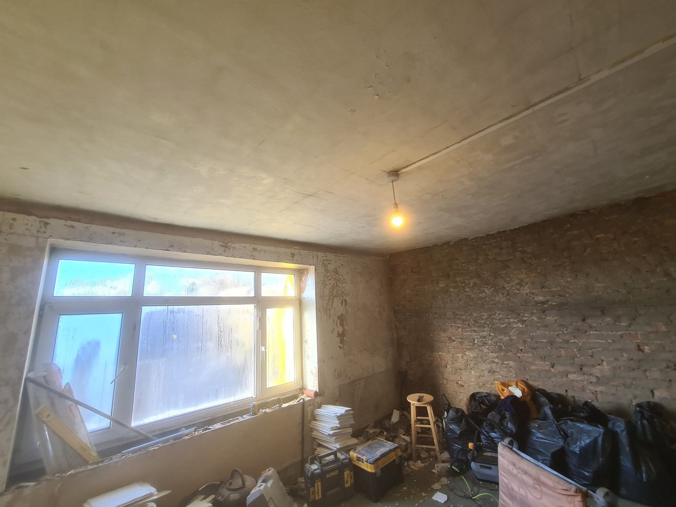

All promising then the ceiling fell in on the plasterers (half expected) as they started to board over the ceiling
Then when the plaster is all done time to sort the bowl shaped floor
Ive looked online and it looks sort of straightforward (stop laughing back there).
Sister the joists and level them using a laser.
so lift the old floorboards, find a level across the high point and bolt?screw new joists onto the sides of the old ones to that level. and pray that the old ones are not rotten
