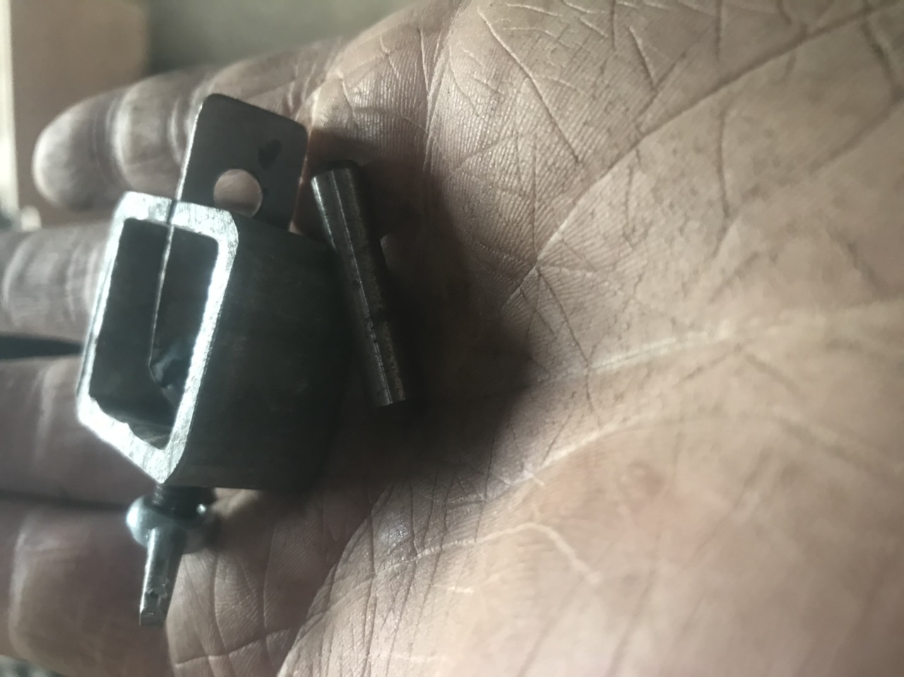

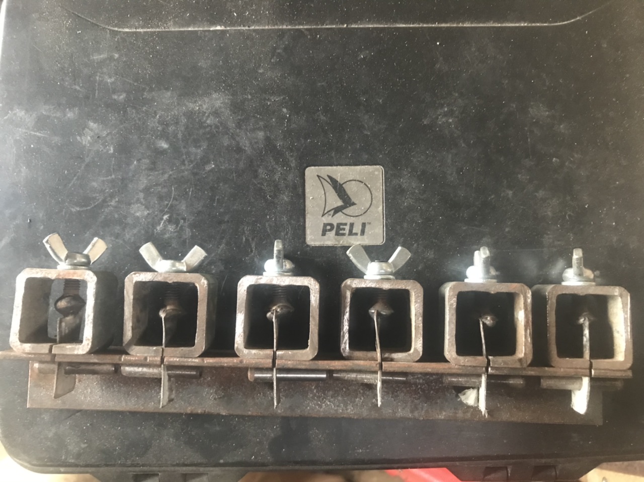

I have those as well bit of 22mm flattened and bent at 30 degrees, however I'm currently working at the front left of a car so I would have to hold it with my right hand and weld with the left. I'm getting on a bit so I steady my right with my left and although I love Ronnie O'sullivans snooker playing I can't do what he does.Where you CAN use them, try having a bright light behind the weld/gap and then use a length (bout 12 inches) of copper pipe with the last 2 inches flattened. Now just before you go to tack place the flattened end of the copper pipe up to the fine gap in the panel. You will know where to tack as the light will be blocked by the copper pipe and it should also cut down on blow through.
Bert
Can't reach it it's on a spit, could do it upside down but why would you of learn to do that when you have a spit, at the mo it's nicely at chest level and 30 degrees.Lie on your back.![]()
Bert
If it's on a spit surely you can turn it over.
Anyhow this conversation has moved away from electromagnetism and lost its attraction.![]()
