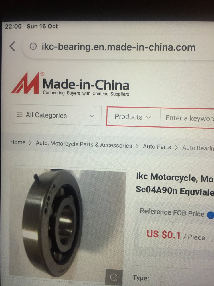

grind a groove in the bearing shell with an angle grinder and shorten the pinIt’s a motorbike gearbox bearing, some have pins in to stop the bearing rotating.
Dremel drill press would work. Never heard of such a thing! I thought you could make something out of thread bar so that one turn is a known depth because of pitch. If that makes sense.I’ve got a dremel and a die grinder, don’t think I’ve got a small enough burr but it’s worth a go. Thinking about it, somewhere I’ve got a dremel drill press, that’d keep it all nice and straight, hmmmm worth trying on some scrap bearings first.
grind a groove in the case too and use a pin as a woodruff key , depending on the case and what holds it all in place ,,,, or locktite bearing bondgrind a groove in the bearing shell with an angle grinder and shorten the pin

@SparkUK what bike is it for?
