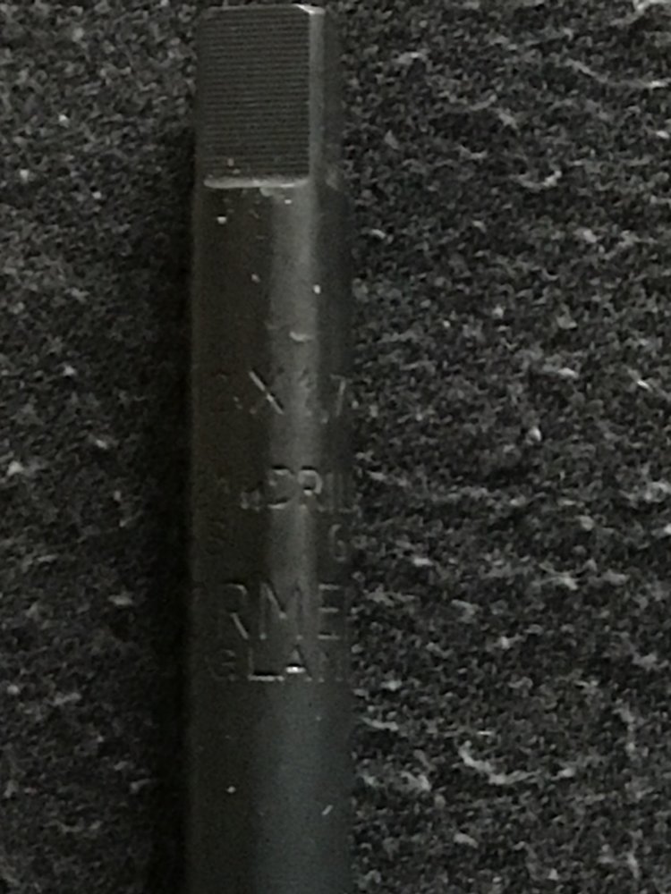

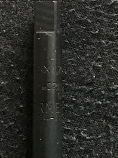

Yes, had to zoom in to take a pic of the shank or you couldn’t see the marking.are they spiral flute?
I didn't look carefully at the coding.

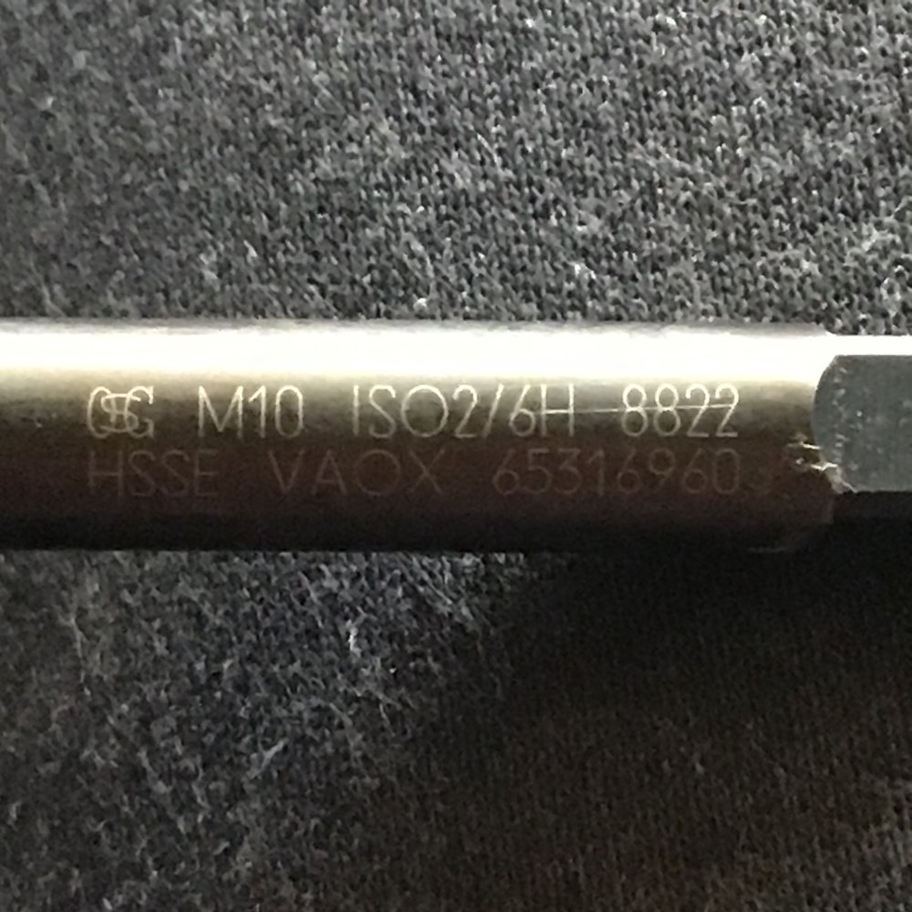

It was very tight, when I screwed it in, but I unscrewed, it to check I had the right thread, which I had.
6g lowercase would be external.6H is a medium fit for internal - 6G would be the equivalent of external - usual general purpose.
