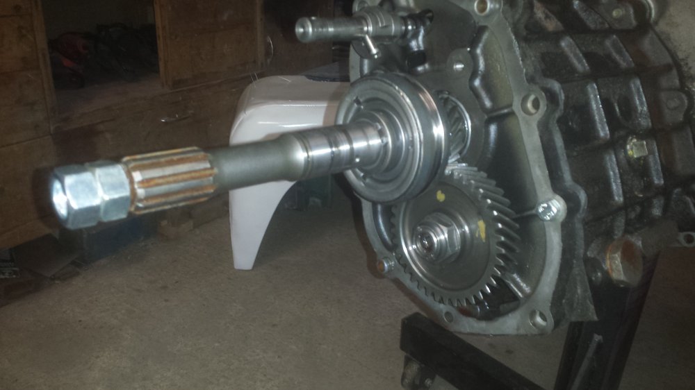

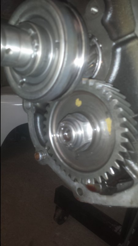

I know there's a fair few land rover owners on here so hopefully someone can help
I'm currently stripping down an LT77 and have got to the point of taking the staked nut off fifth gear, in all the manuals and threads I've seen this normally has a couple of holes in so you can hold it in place with a plate. Because mine is a suffix A box it doesn't have these holes, so in order to hold the gear in place whilst trying to undo it I've been putting it in fifth gear and locking two nuts on the end of the main shaft to hold it in place but I just can't get this nut to undo, any ideas would be much appreciated before it complete does my nut in
excuse the pun
