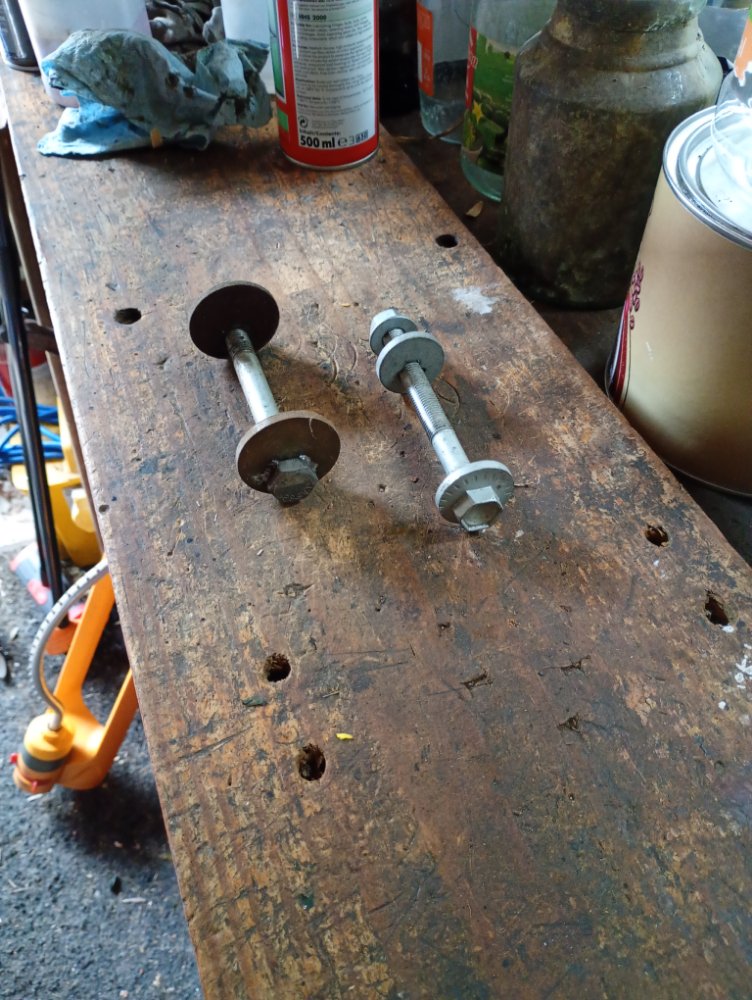

Modify the mount to take larger round bits and make new offset round bits to fit on a new bolt.
These are off an old BMW. Standard on the right and modified on the left.

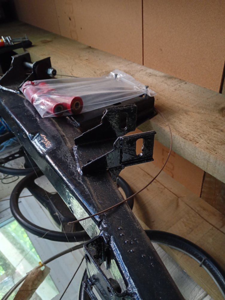

Below is the modified mount;
