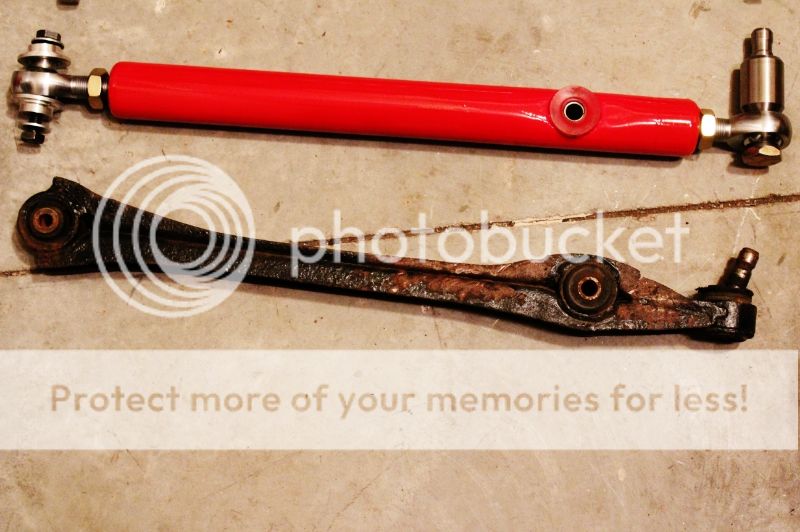

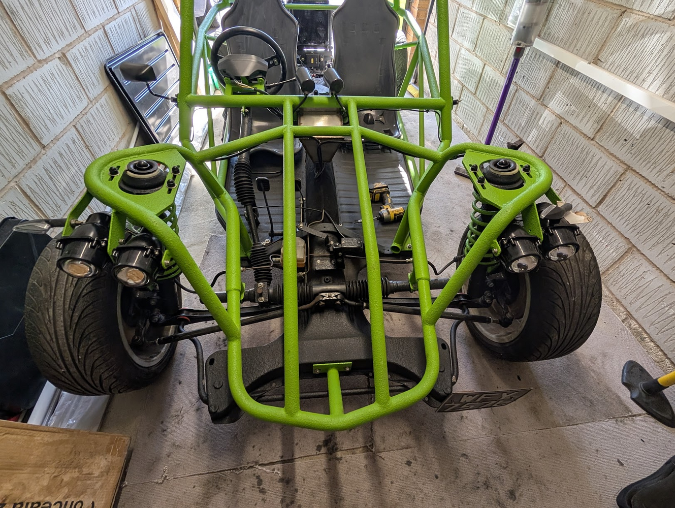

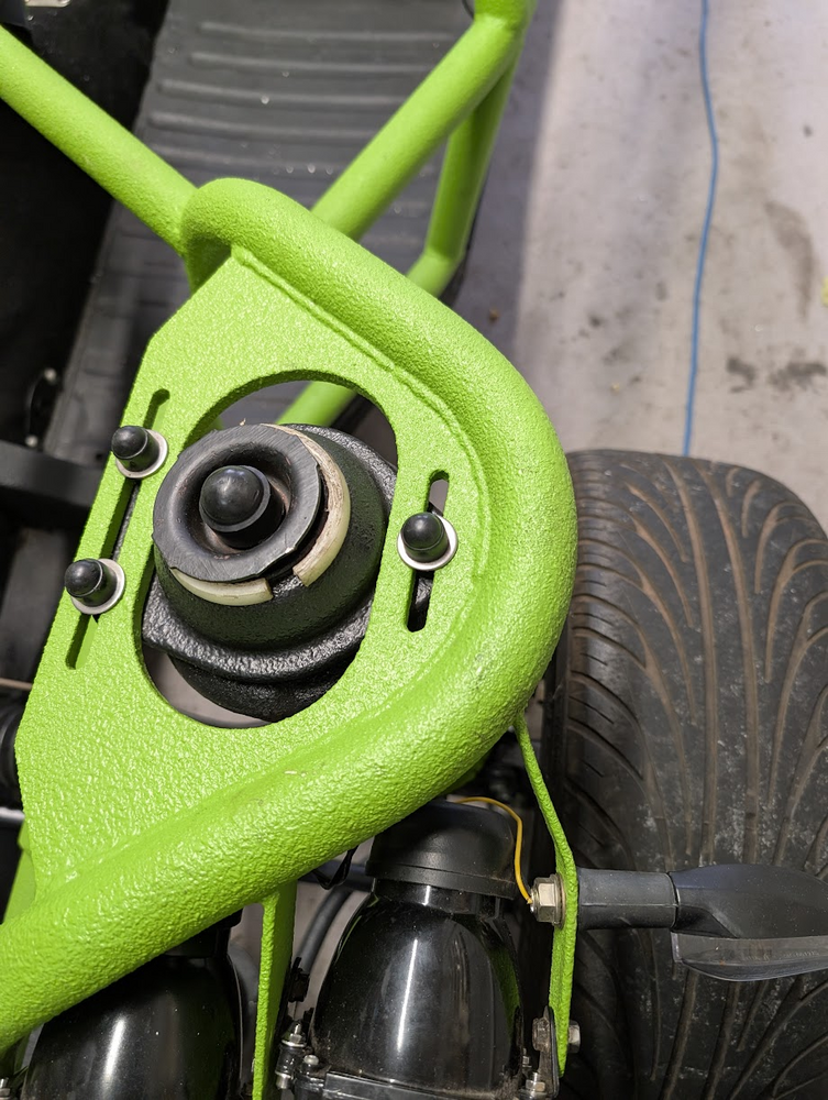

I have a sandrail built on a 1303 Beetle chassis (the one with McPherson struts).
I'd like to build new arms so they have more camber adjustment.

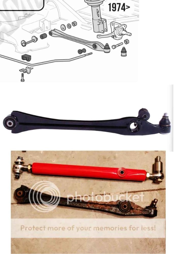

Below are some images of a standard lower arm/ARB. And an arm someone else has made.
Rose joints are overkill. So I'd like to build something similar that can house the original bushes and balljoint- which is press in.

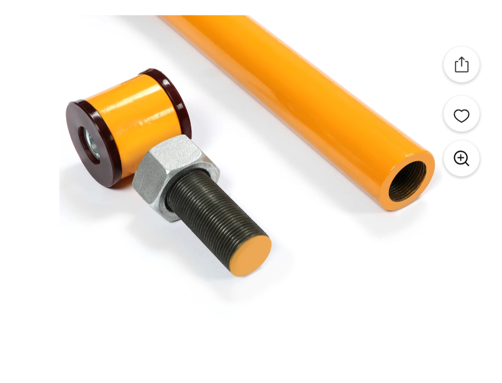

I came across this design..
I would just need to find a tube with an ID the same as the poly bushes/balljoint and weld some M18 threaded rod to it.
But basic rod is 4.8, which I don't think is weldable?
Any thoughts?
