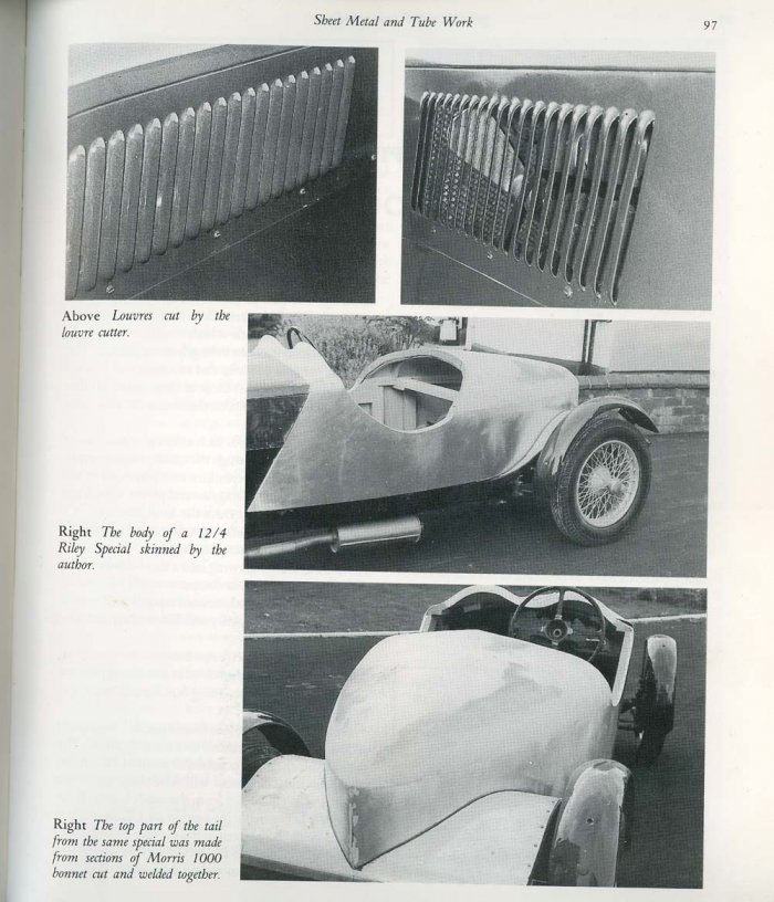

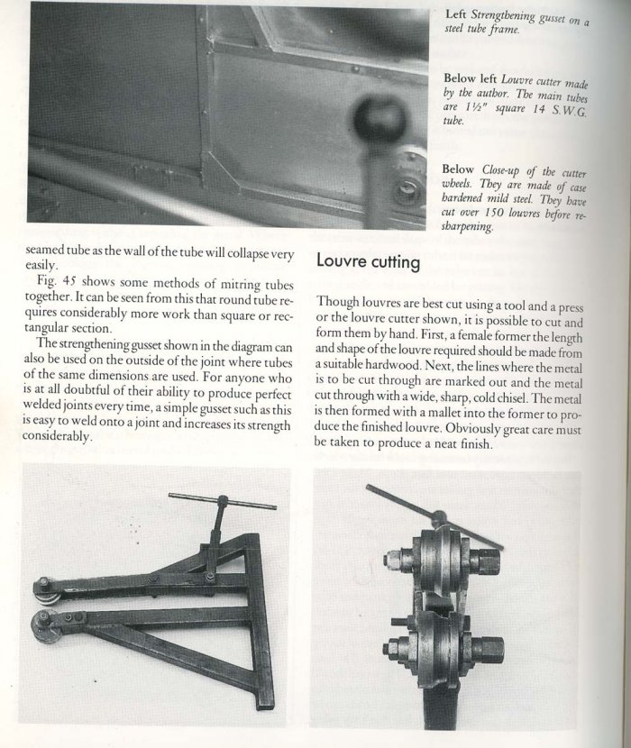

I don't think I mentioned the louvre tooling. As for the machine and what it can do - I think I'm in love![]()
I knew you would like it, I miss mine, we used to do curved louvres on one job, it was the lid for an industrial vacuum cleaner, proper sheet metal working with rolled body clinched joints, knocked up joint on the bottom, wired edge at the top, and stiffening swages, made hundreds of them, then the company we made them for discovered plastic, end of job
