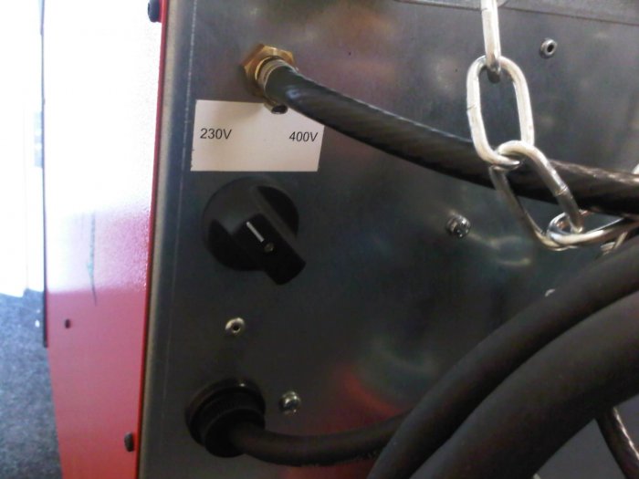

No it works off 2 of the 3 ph on 400v and can also work on just 1ph on 230v.

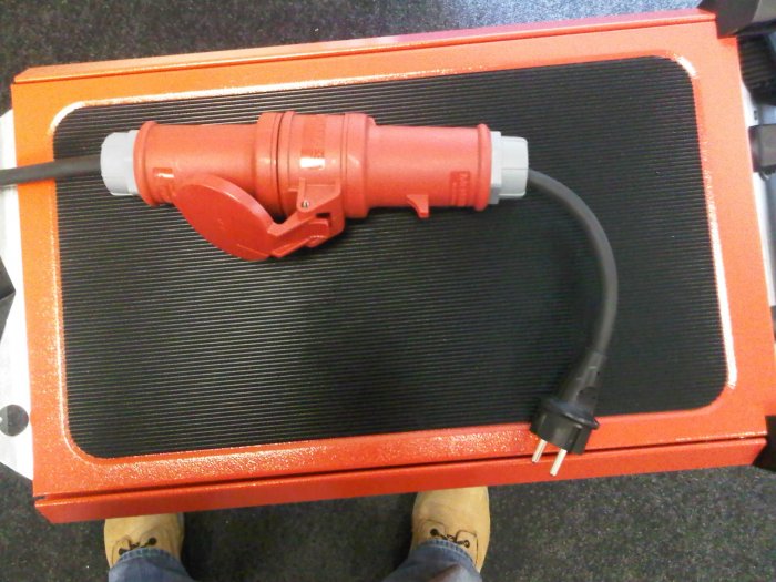

The pic of the plug is only of the adaptor, its just a 5 pin 16 amp red plug and socket with a fly lead to a 16 amp shucko continantal plug, but i will post it when i have found it on my phone
