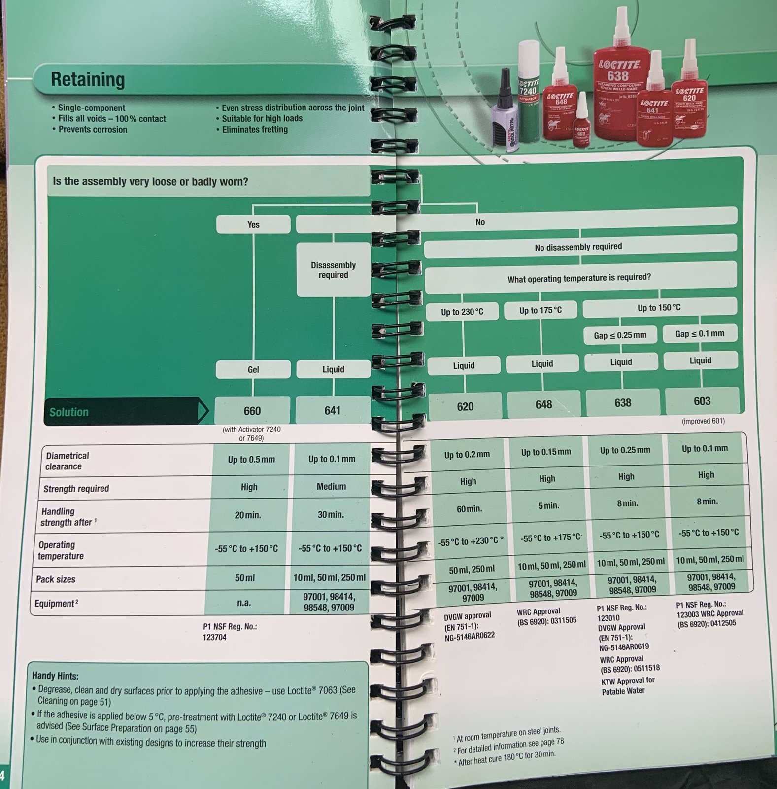

I’m rebuilding another sealey grinder. This must be w different model because it’s not as well made.
anyhow someone tried regressing the bearings before. Rather than replacing.
I’ve gone to fit one of the new bearings and it’s tight on a portion of the bearing journal, but loose when it butts up to the shoulder.
I’m yet to Mike it, but what are my options?
I’m thinking bearing fit if it’s only a few thou.
