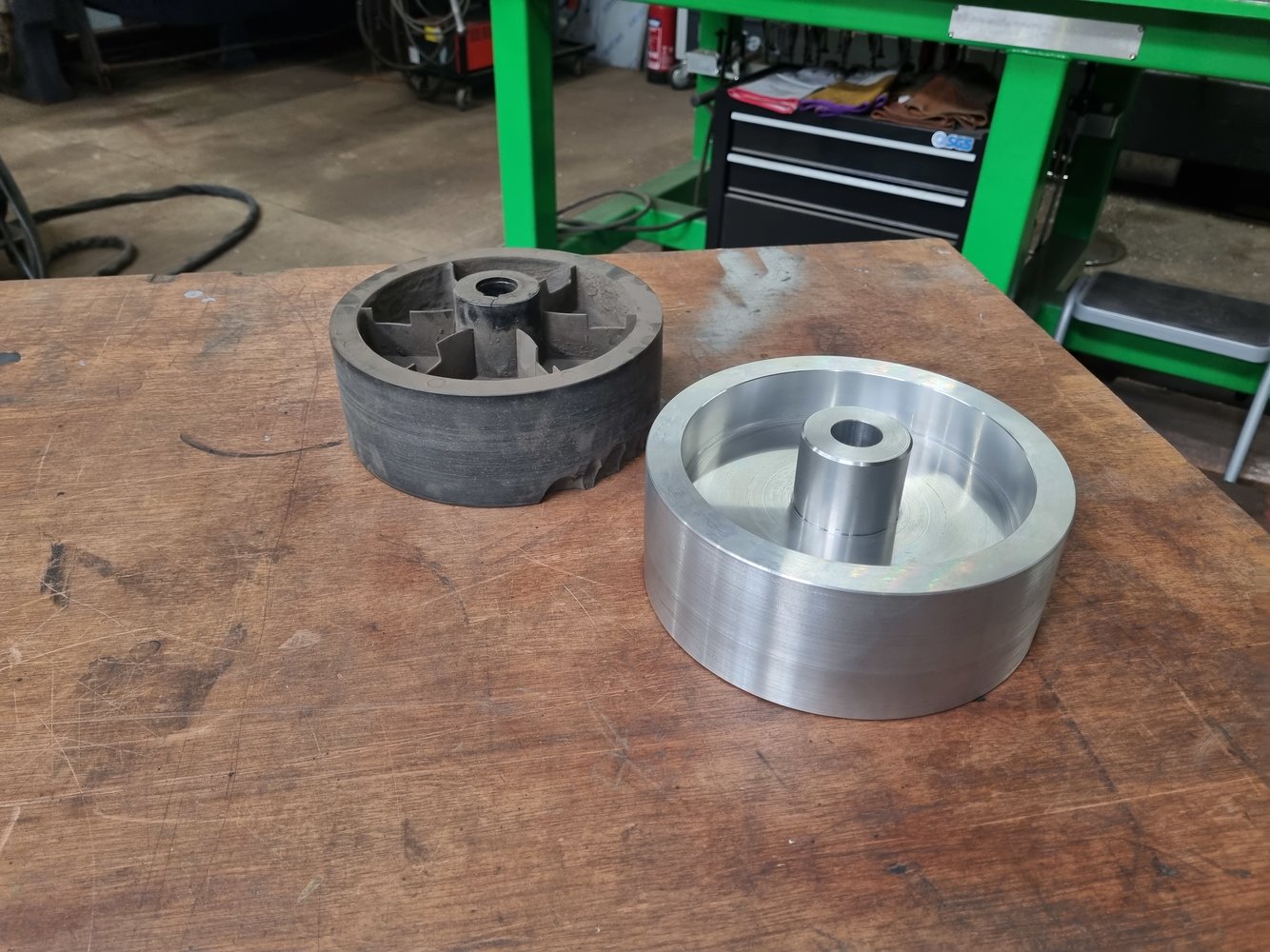

I'd be very concerned if a decent lathe couldn't give a flat face.
That’s a good spot … thank youHow critical are your dimensions?
You could perhaps get something like this
https://www.castors-online.co.uk/product/100mm-aluminium-high-temp-wheel-4568
Which will give you the rough component, and then just adjust the bore and skim the surface to the desired flatness. It would be undersize though, obviously.
Just a thought, might be worth a bit of googling to see if you can find something that is 90% of the way there.
Rabithole allert!Lathes would be scraped in and set up to face slightly concave precisely for the reason above - to guarantee a non-wobble.
You can look in the Schlesinger book of words to find out the allowable tolerance (page 49 & 50, fig 15 here: https://www.pearl-hifi.com/06_Lit_A...s/Schlesinger_Georg/Testing_Machine_Tools.pdf).
You do it that way so as it wears, it will wear in (improve or approach flatness) before it wears out (becomes convex). It is the same with a tailstock. You would set it slightly high so that as it wears, it approaches centre height before wearing further until it is too low.

I have a 4” diameter Ali billet here, if it’s just a matter of parting a bit off and putting an m14 thread through the middle I may be able to help.Ha.., i’ve been there and past it unfortunately in a previous life.. I guess that’s why i so appreciate now the friendship enthusiasm and encouragement you get on here..
Ha..,, And Thank you ..Perhaps it is just me, but I didn't find it particularly hard to visualise what Noods was requesting in his original post.
Not really sure where the relevancy of the flatness of the faces of discs and lathe geometry comes in.
It is a non-cambered sanding belt wheel, and the level of precision need only be commensurate to the application. Pretty self explanatory to my mind...
In all honesty initially I thought it was high. More a case of I have the capability, material and machines if the OP got no others offers. HOWEVER as I said in PM after a bit of thought and more understanding of what was wanted/needed the price is actually a good one in a business setting.That was a valid quote, with allowance made for client change of scope, and some f-around time finding out exactly what the client wants (which was proven exactly right by this thread). A rough drawing with valid dimensions produced, and go-ahead from client before manufacture.
£50 material, 2 hours to machine, and 0.5 hours admin, at £40/hour which is cheap since it's a "fun" job.
I tell ya what, I had a feeling some on here thought that £150 was a rip-off, but I don't bother working for free!
I thought I had visualised it. But Munkuls photo showed an improvement with a longer central spigot that would be a lot better resisting wear.Perhaps it is just me, but I didn't find it particularly hard to visualise what Noods was requesting in his original post.

Lol that would be my initial reaction till I looked in more detail. Although a trained machinist would be way way quicker that I would be doing the job. So pricing by time is not realistic for me.I saw the job as £50
£10 of material and 20mins
The most interesting point about pricing is driven by demand……do you need the money from the job, or do you need the job. Very different thing. Id have said a 50 quid job too, but dont need the money or the job. But as a business its not worth getting involved with anything for less than 1/2 a days money. Simplistically put, by the time you invest time to fully understand the end product, cut some stock, machine, tap, clean lathe, then package to have courier collect, its roughly 1/2 a day.Lol that would be my initial reaction till I looked in more detail. Although a trained machinist would be way way quicker that I would be doing the job. So pricing by time is not realistic for me.
