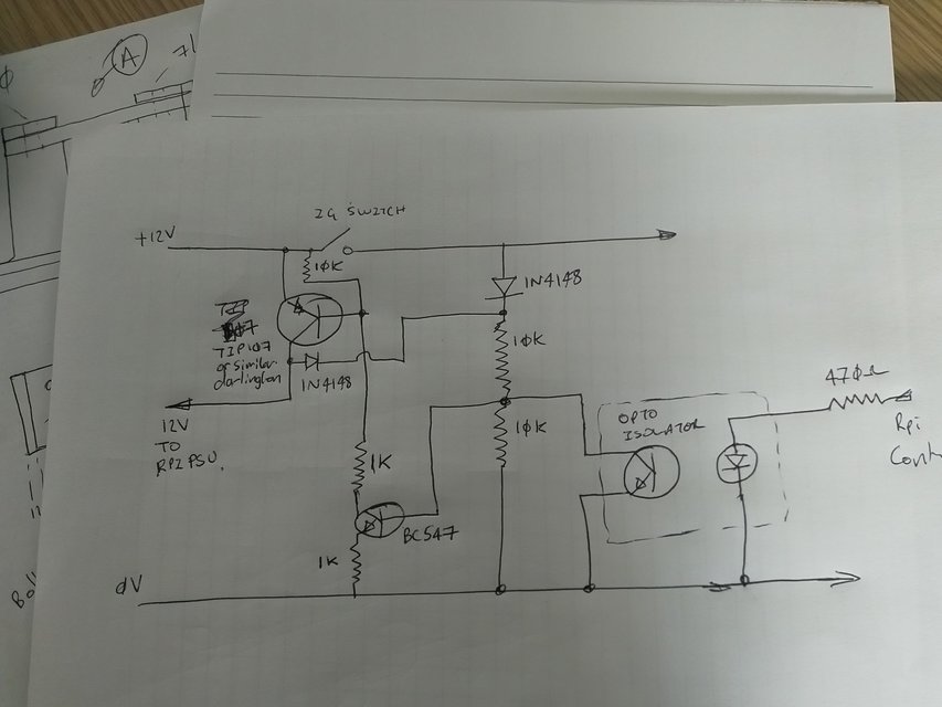

One of these, and 6 other components will do it. Sorry, missed component values off - RPi IO resistor will be 4.7K and the other resistor would be 1K. Possibly also use 1N5403 diodes or similar - 1N4001 are only good for 1A.
And I thought raspberry pie was better with ice cream!What is the project please? Is it so you can leave the high intensity rear lamps on all the time?![]()

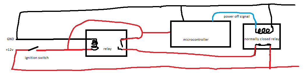

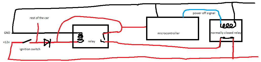

I have a bad habit of designing a circuit then finding what I want on eBay premade for £2Im sure you can buy a premade hat that does this

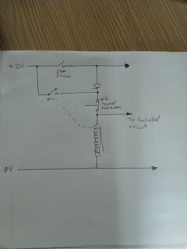

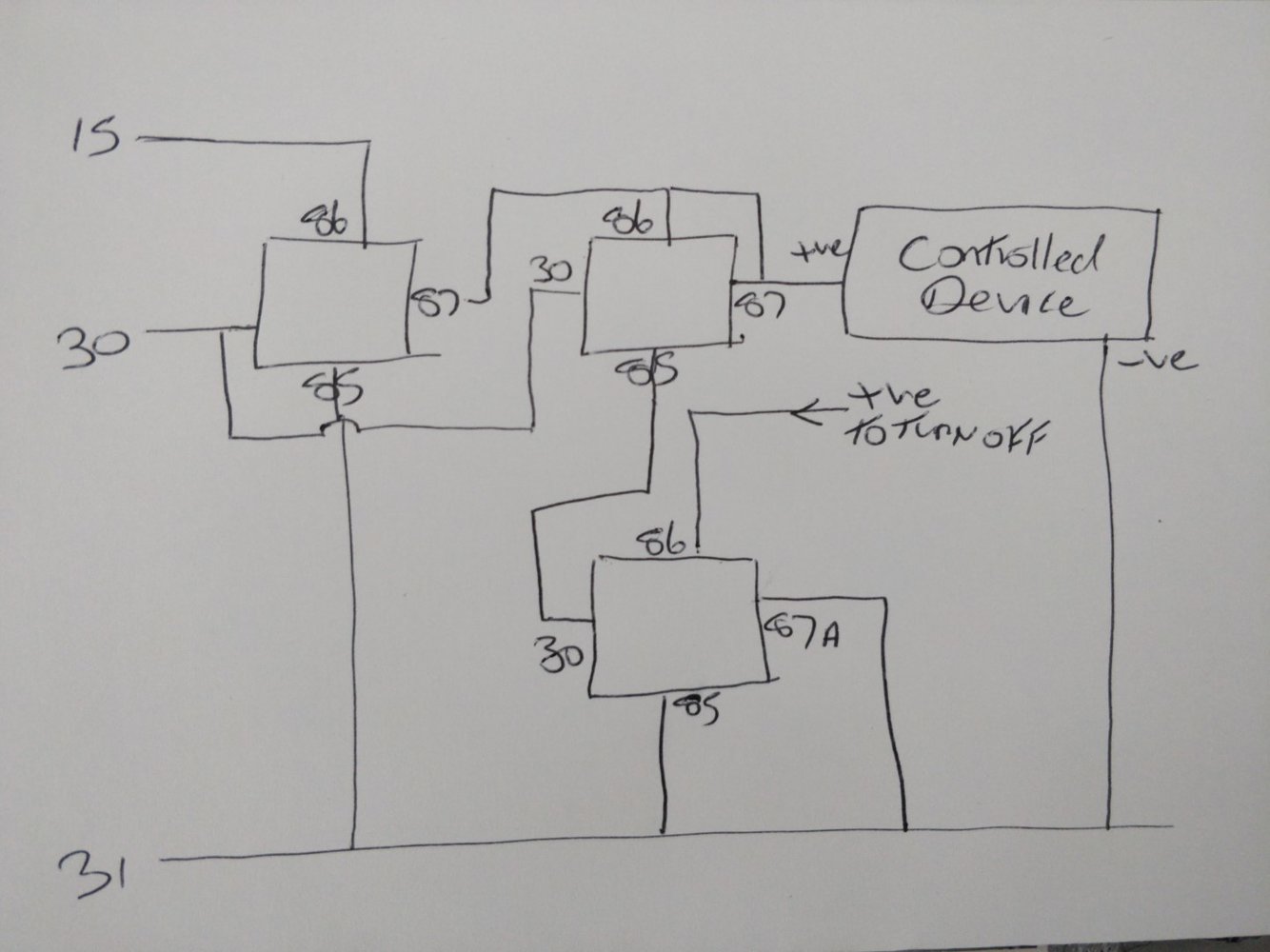

Couldn't you just use a 'timed off' relay and monitor the term. 15 to initiate a graceful shutdown after a few minutes?
