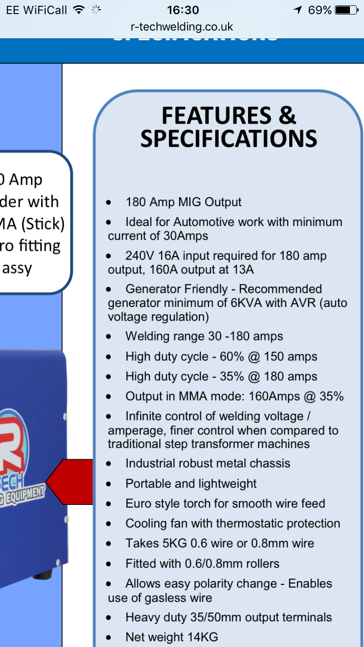

Im looking for a welding to ideally run on standard 250v. The welder will be used for mainly farm repairs and general light fabrication. Was looking at a miller multi process machine. Any other suggestions or advice would be appreciated. Doesnt need to be a multi process machine. Ive only really had experience with miller kemppi lincoln and thermal arc
