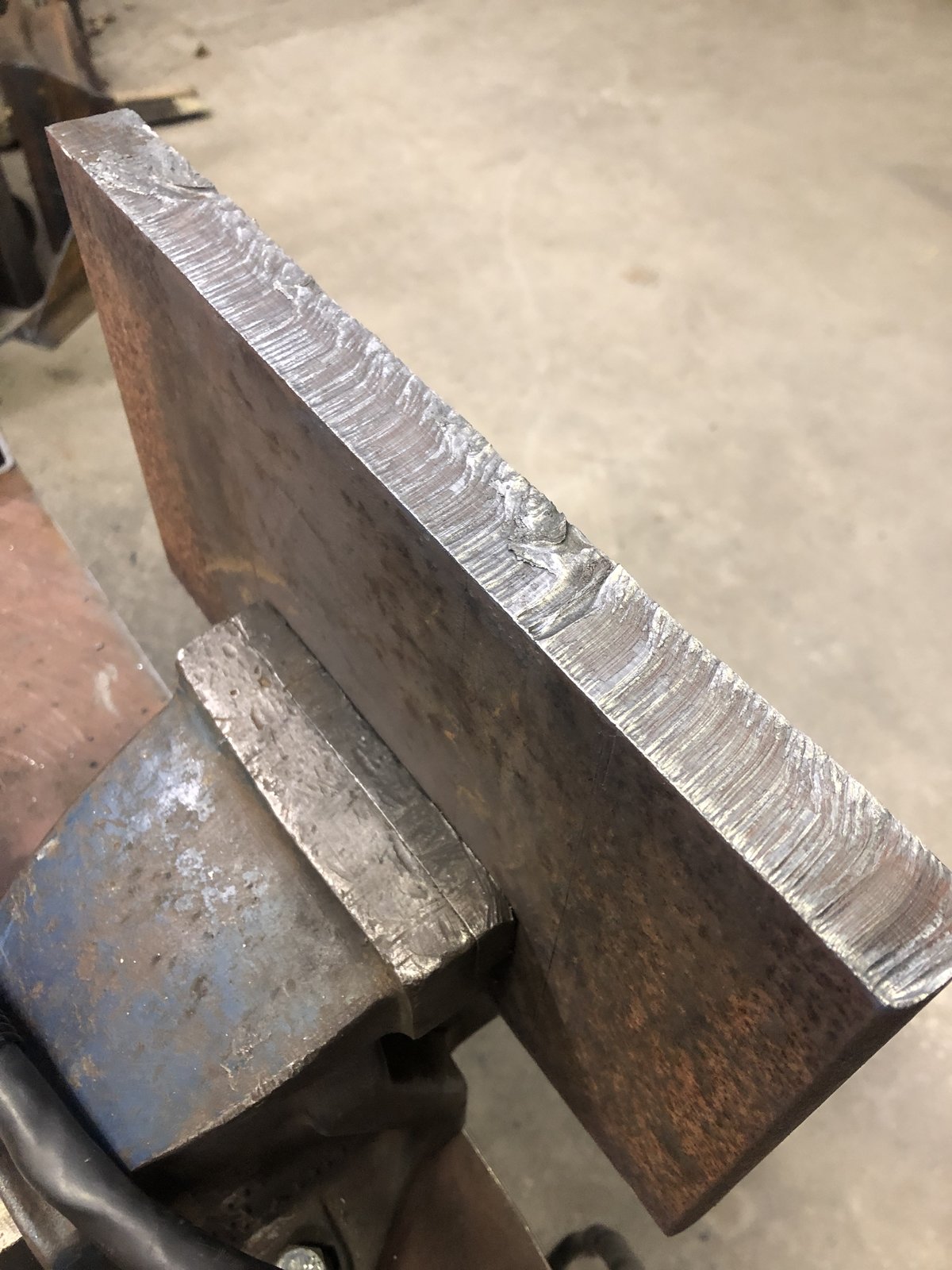

Hi guys looking to buy a good plasma to cut upto 15mm steel
To +300mm you might sayMore might be put out to dry for this but if that was me I'd buy a oxygen propane cutting set cut mild steel from 6 mm to 75+ mm
That is ok if all you will be cutting is steel. Beauty of plasma is it will cut stainless, alu, brass....... basically anything that is conductive.More might be put out to dry for this but if that was me I'd buy a oxygen propane cutting set cut mild steel from 6 mm to 75+ mm
Yes, if only steel then gas is a good option.Totally agree @Hood plasma is great if your cutting all types of alloys and thin steel. But the op only asks for steel so I thought I would put a different option forward although each had its advantages and disadvantages
How I couldn't quote...Totally agree @Hood plasma is great if your cutting all types of alloys and thin steel. But the op only asks for steel so I thought I would put a different option forward although each had its advantages and disadvantages

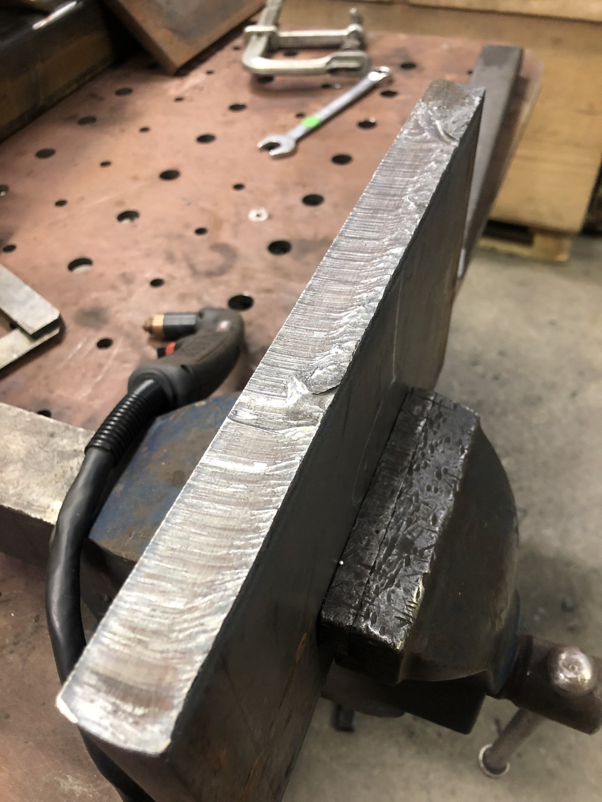

, It was some Italian thing. Had a Esseti single phase plasma in the box brand new ( stock item ) had to get it out for work. Only used it twice and it works ok, but not on thicker stuff. Have also some Hungarian HF start three phase machines. Started with a 50/80amp. These things are heavy, transformer type about 250kg, Had it for years. Consumables dont last that long and the cut was OK. It didn't cut like I wanted so I got it's bigger brother (60/90/120/150 amp) machine, now this weighed about 350kg. Still cut quality was about the same as it's smaller brother, but it could cut thicker stuff
