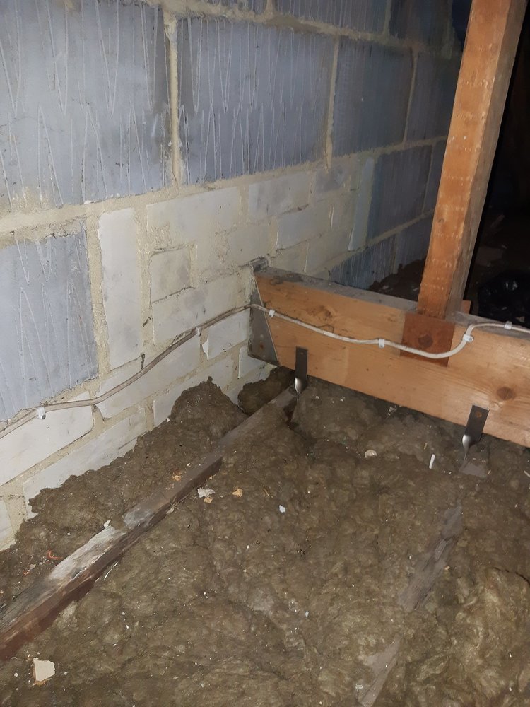

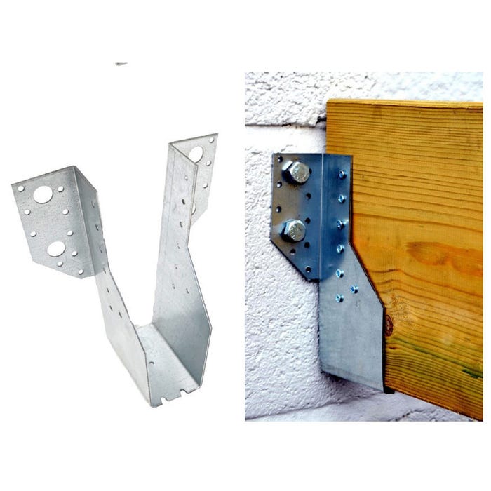

Most of my roof void has been given the very latest super efficient insulation Nov 2021 where the solar control panel is at one end of the space they people doing the insulation set a walk way up on the B&Q stand offs and used their standard width treated green over lapping flooring boards . The boards are about an inch above the new insulation so it's not being compressed .I have just done the same job here, looked at all the options - ended up going with the loft legs from wickes.
The loft access position made it difficult to get any appreciable lengths of timber up into the space (6ft max) so it would have been tedious to put counter battens in.
I must admit i thought that they would be rubbish but am actually really impressed with them, put some additional supports in a few places to act as braces where the edges of the loft boards would have been unsupported and it has worked out really well.
