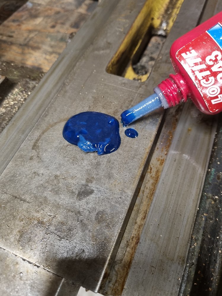

I was going to ask a while ago if anyone had known of loctite going off in the bottle, I had a small bottle of 243 which was coming out as a paste, as I went to take a picture of it I squeezed all the paste out and it was coming out as a liquid again, I decided it must have just gone off in the nozzle or something.
Picture off the mess, you can see an opaque lump near the front of the puddle. That's just a crappy old bottle I found amongst a load of second hand tools so I wasn't too bothered, someone's cut the fine tip off the nozzle too so I'm almost trying to get rid of it, I didn't really think any more of it going off.
Today I went to use some 638 (in a 50ml bottle I bought new) and it's much thicker than it should be, so I checked my other bottle of 243 (Another new, 50ml bottle) and it's thickened too.
I've now googled it and seen "Storage below 8 degrees or above 28 degrees can adversely affect product properties". I've got it all in an uninsulated garage, I can quite safely say it's below 8 degrees out there.
I'm going to machine a couple of test pieces to check the bond strength, hopefully they still cure properly and I haven't completely wasted seventy quid worth of glue.
