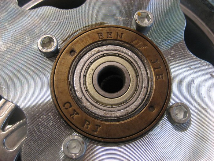

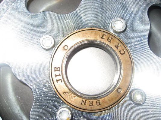

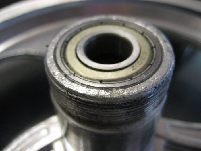

there is air in the bottle, its enriched, around 24% and once you open the bottle atmospheric oxygen gets in, you typically need to drop to around 3% to allow curing (Critical Lower Saturation Limit) as for the pressure you need around 2x10^5PA to activate it
not a lot of force really
With it being an imperfect setup, and if you haven't enough meat to drill out for a securing pin or screw, then a chemical solution like the Loctite is about your lot. It should do the job, and it's not going to be a world ending catastrophe if it doesn't work, so give it shot.
