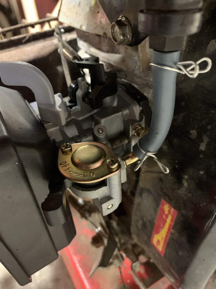

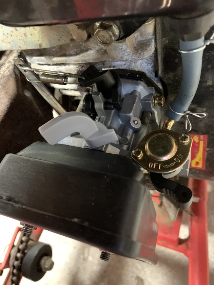

Does it change from 4 stroking to 8+ stroking in which case it's too rich or does it just cut out in which case it's too weak.Now I had a spare hour yesterday so stuck a new chinese carb and air filter on the Locin engine, it starts no problem and revs but under load it just wont go?

I dont think so but will check again.Will it run better on part choke ? You might need a bit bigger main.
Starts and runs fine if you lift the back end up its fines revs and spins wheel, but once one of the fat lads jumps on it just has no go in it?Does it change from 4 stroking to 8+ stroking in which case it's too rich or does it just cut out in which case it's too weak.
Does it immediately play up when under load or run for a few seconds before playing up as in cutting out. If the latter it " might " be the float valve jet not being big enough and running the float bowl low or dry.
Can you " coax " it to pull through. If so it might be the slide cutaway.
All just guess work.
Thanks BobA few basic checks wouldnt go amiss before you throw spanners at it. First would be fuel supply/delivery, worth pulling the pipe off the carb and observe fuel flow at the end of the pipe. There is a filter in some of those tanks, also worth checking tank vent. Also worth looking at is the governor, check its pulling the throttle wide open under load. Thats it from my armchair

How do I check the governor?
