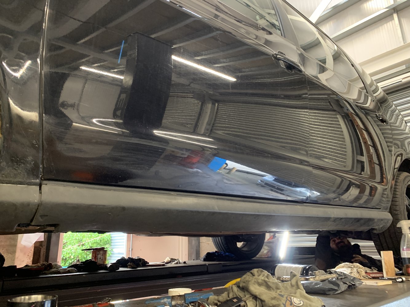

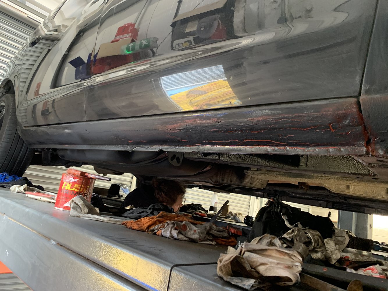

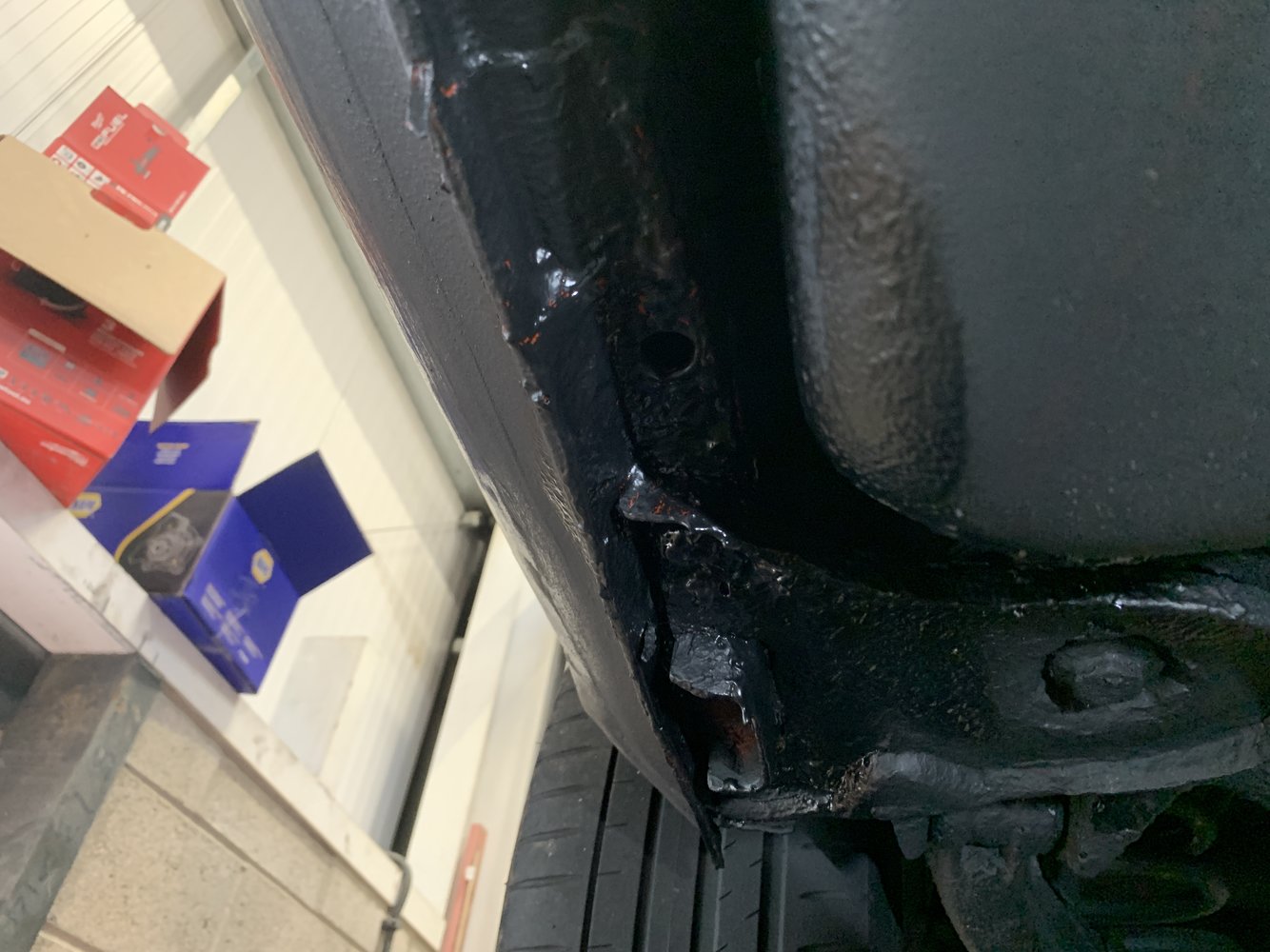

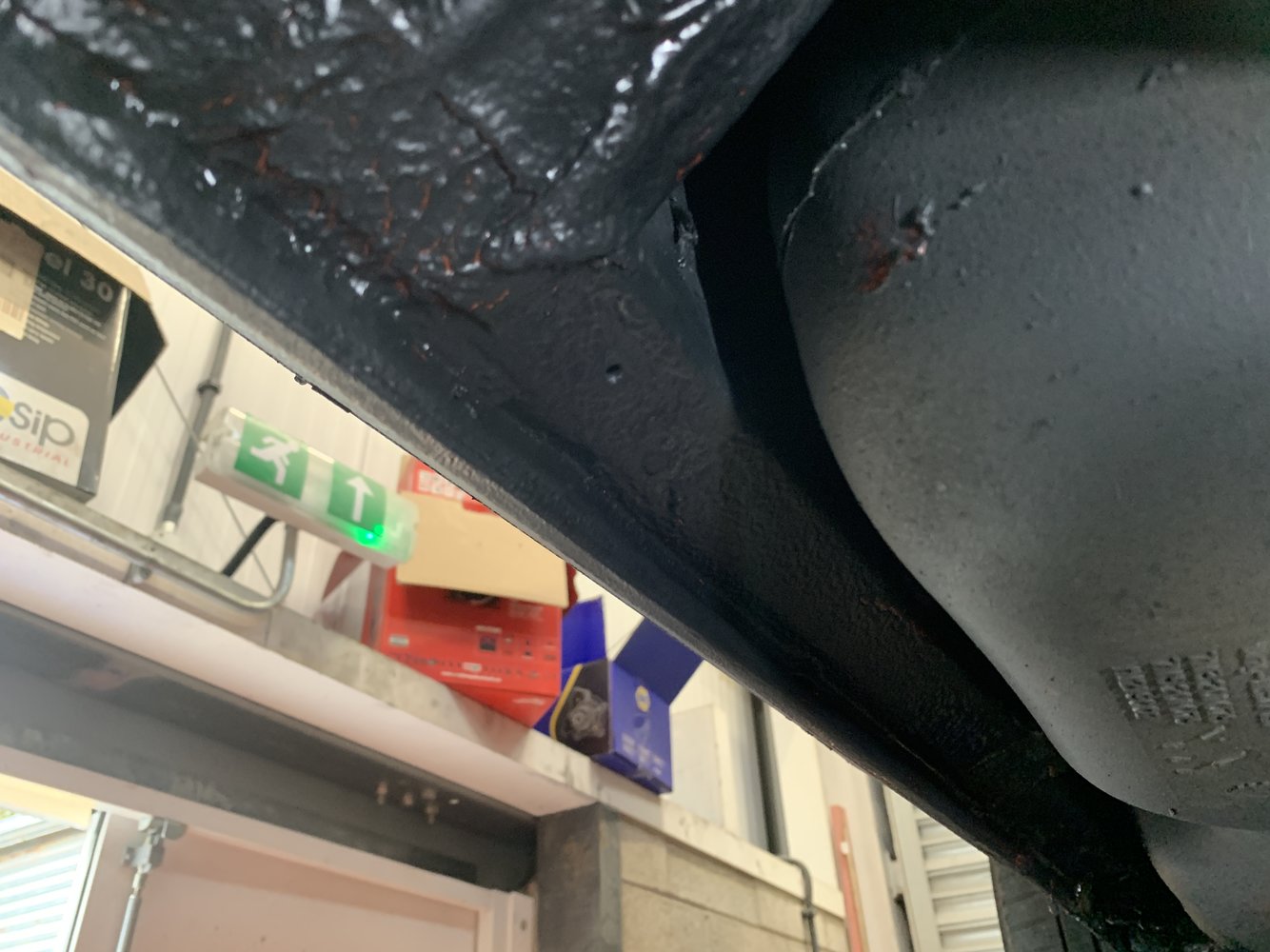

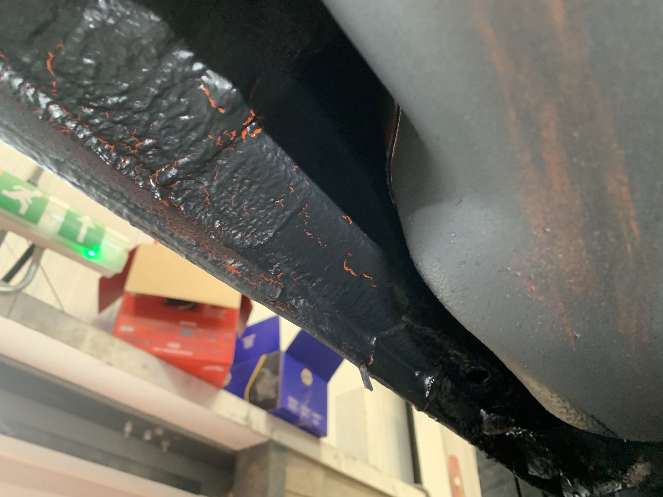

Bit of a reaction again from uncured paint causing the solvents to separate but my lads gonna give them another coat later.
My lad also complained about rusty water staining under the car, so all accessible cavities got a thorough coating of Dinitrol (Bilt Hamber) until it was ****!ng out of said holes, hopefully that will slow the progress of rust inside on the back of the fresh patches.
