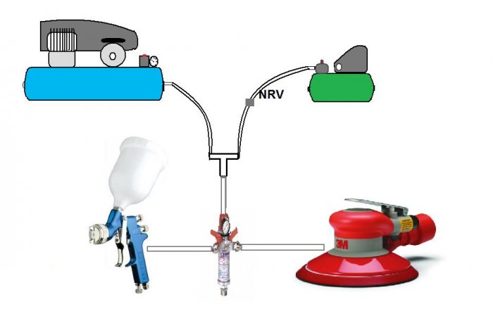

Seems that 2 comps v.similar or ideally the same would work much better together, only needing mildest of tweaks to avoid surge.
Your big compressor will overpower your small one, it will shorten your recovery time a bit but the smaller one will be more or less added storage.
hi i tried the da today and the compressor powers it fine and im supprised how long it takes to kick in ! im now thinkimg of adding another 200/300 litre tank to it![]()
